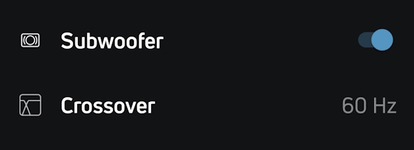

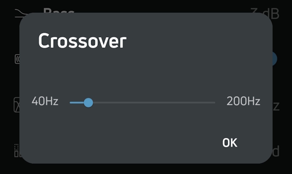

I asked AI the other night if I'm right in having a crossover set on my amp (Bluesound POWERNODE) but also on the subwoofer (REL/HT1003) as well. It said I should disable the one on the amp and use the dedicated control on the sub only because two crossovers can lead to phase cancellation and overall poorer sound quality. Here in lies my problem... there is no option to disable the crossover via BluOS. From the support article:
Crossover
Adjust the crossover between 40Hz and 200Hz – by default, set to 80Hz. When the Subwoofer option is enabled, everything above the crossover is filtered out and sent to the RCA and Speaker Outputs. The Player sends anything below the set crossover out of the Subwoofer (SUBW) OUT.
So what should I do with the sub crossover? :(
Thanks.
If you enable subwoofer, then it's going to enable crossover. That's obvious.
Unless you want to send full range to speakers and subwoofer, but I can't see the benefit of that.
He just needs to enable crossover, and adjust the crossover to where his speakers roll off, then adjust the subwoofer volume to match, and adjust phase to get smoothest response between speakers and sub.
Yeah still confused sorry peeps. Be gentle lol. So, yes, no option on the amp to have sub out enabled whilst disabling its own built in crossover. But on the subwoofer there is no way to disable the crossover either. So its on in two places. I will email Bluesound and pose them the question about what are you meant to do as well.
Because surely what happens if the amp is filtering at 60Hz to sub, but I haven't got my dial quite right and it is set (an exageration here) to 40Hz. I'm losing 20Hz of sound range? It's all a bit of guessing game.
