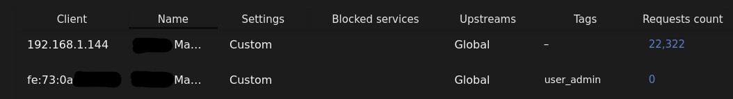

I'm trying to set up persistent clients using mac addresses rather than IP addresses, which Adgaurd claims to support, but it's not recognising MAC address clients at all.
These two rows are the same device...

If the two clients are the same device, AGH will be prioritising identifying the client using its IP and thus the second/redundant entry shows no activity. Delete the duplicate entry, edit the first and add a second identifier (the MAC) and you should be good to go.
I had it with only the mac address entry for a while and it wasn't working at all. I then added the IP address entry and it picked up on that.
