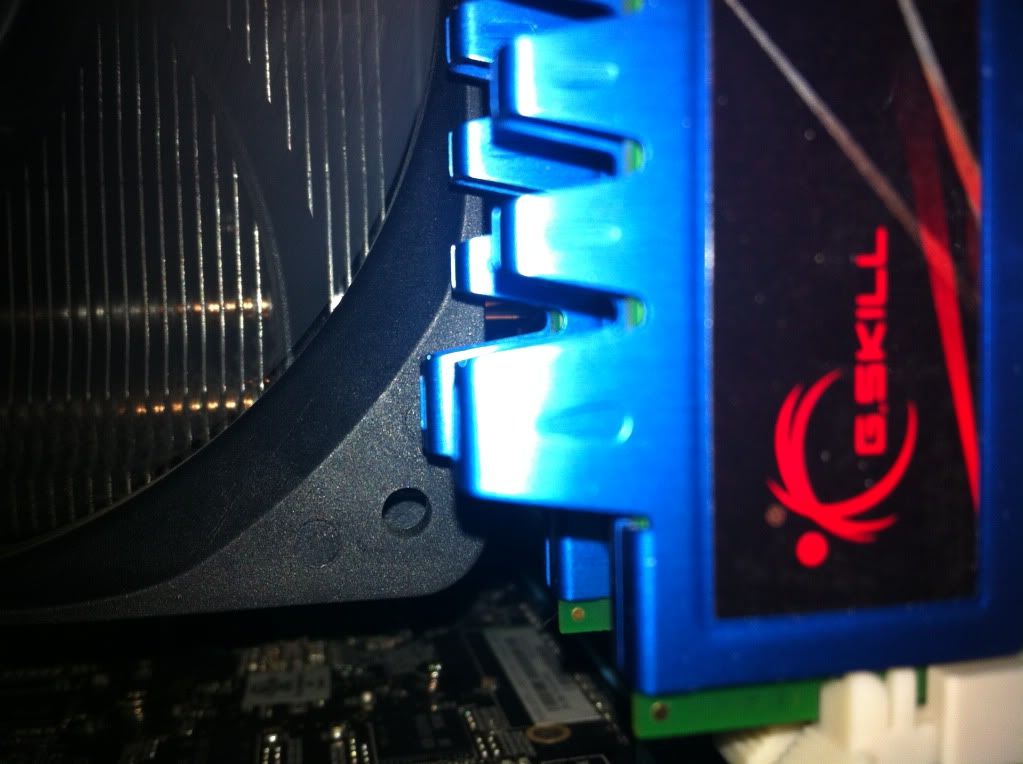

head on view, the hyper 212 is far from the biggest cooler on the market and is nearly covering the first ram slot :(
from the side and the ripjaws are a good few mil 'into' fan, if you know what i mean :p

yea just found out they are slightly lower than the ripjaws i'm using, so thats the fenrir evo ruled out, 1 more cooler option bites the dust :mad:
seeming more and more likely i may have to look at the h50 or 70, and not liking either of those 2 options
