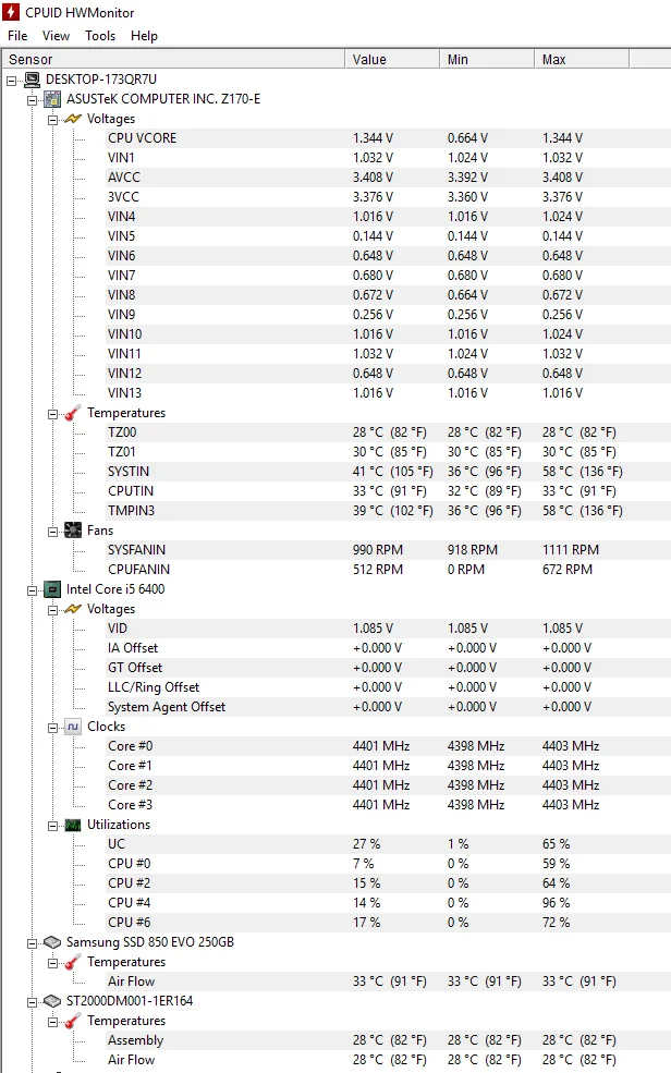

I took this quick screen grab after the overclock and before the blue screen
Where to go from here?
Thanks.

The bios is designed to work. I suspect that the config is a generic one and may not suit each and every sample of CPU.
Really you need to set up every overclock from basic ie start with default settings and work from there. Apply BCLK in small steps 5-10MHz and amend the voltages if it falls over or fails to load windows. Until it gets too hot or voltages get too high. When your limit has been reached. take it back a notch or two.
Just to follow up I changed a couple of settings as 8 Pack suggested and the machine is running very nicely now.
Cheers all.
