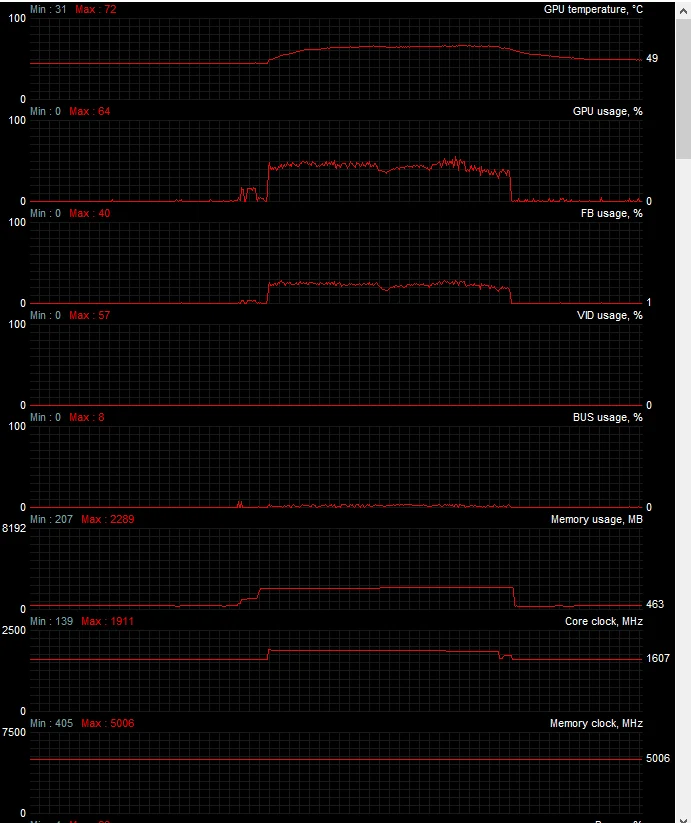

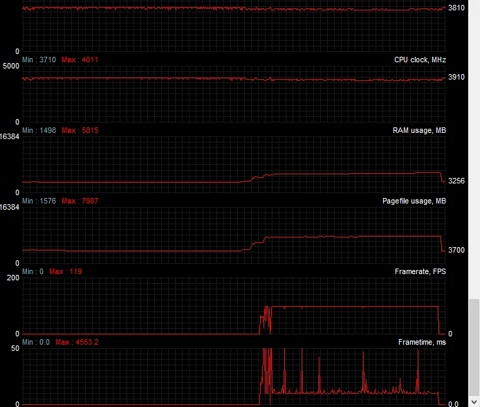

Do you notice you get a lot higher GPU usage between 1703 and 1607? 1607 being better, I've certainly noticed that, however i still get a few problems. I started a new thread for that here, maybe you can help.
https://forums.overclockers.co.uk/t...-dropping-from-100fps-to-even-97fps.18788545/
I cannot say I did. Every hiccup I did get showed up in msi afterburner as a frametime spike.
I suggest you install that and enable the frametime graph.
Another thing I did notice is on CU in overwatch pressing the tab key would result in a very slight bump in the frametime graph
Now im on the AU there is nothing, not a single hump no matter how many times I spam the tab key.
As you can see, everytime my frametime jumps i get a stutter. Really frustrating as it happens in every game, that was one game for less than 5 minutes.
