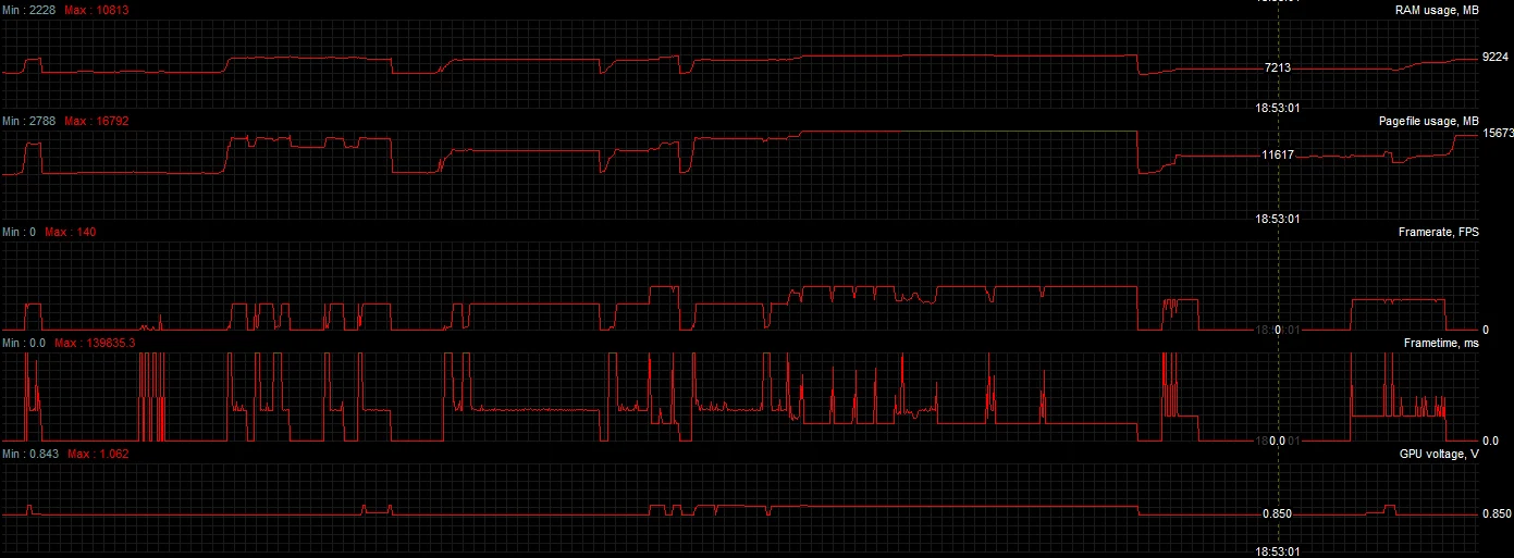

I seem to have tracked down the cause for the stutter, but have yet to find a fix. I was playing Battlefield 1 and FIFA 17 and in the following graph my frametimes sometimes hit 139,000 ms (what causes this?)
Now whilst playing these games none of the CPU Cores go anywhere near 80% let alone 100%. I'm capped in Rivatuner at 100fps and have vsync on but have also tried it off, this leads me to believe should i be able to get consistent frame times i'd be able to get rid of the stutter, but the question is how would i achieve a stable frametime? Instead of it occasionally hitting 130,000+ ms.
I have a 6700K and GTX 1080 which should easily be able to obtain 100fps in most games out today at 1080p, and even 1440p.
Look forward to hearing your replies!
