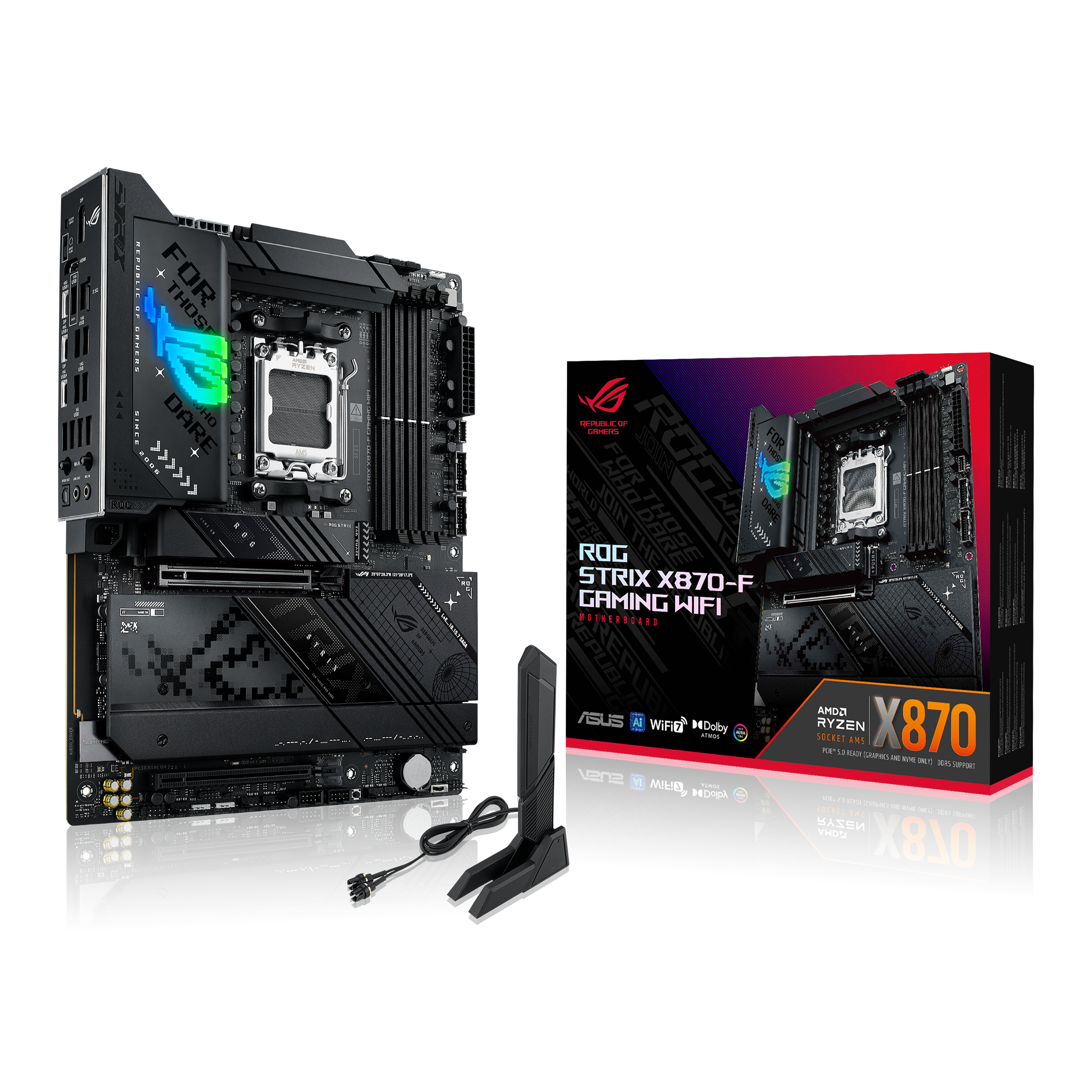

So first upgrade I am thinking of OCUK bundle AMD Ryzen 9950x3d, ASUS ROG Strixx870f mboard, 64gb Gskill Z5 Neo, Cooler Master MasterLiquid PL360 Flux AIO CPU Cooler, (I also like the Tryx panaramic 360 AIO cooler) Crucial T705 2tb NVME PCIe5, I already have a spare unused 2tb Crucial PCIe4 for a steam drive. PSU i was looking at either the Corsair HX1500i, Seasonic Prime TX 1600w or the bequiet Dark power pro 13 1600w.

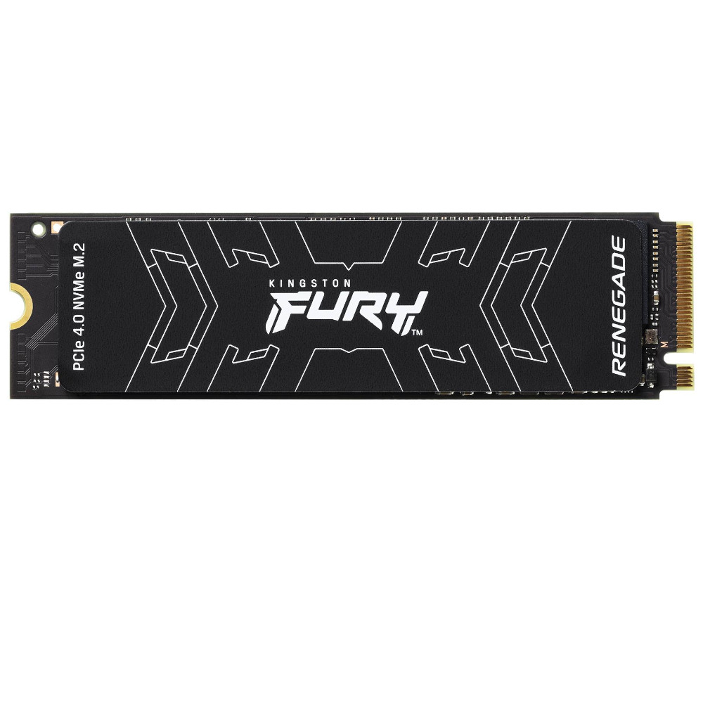

The kingston fury SSD looks like a good drive.

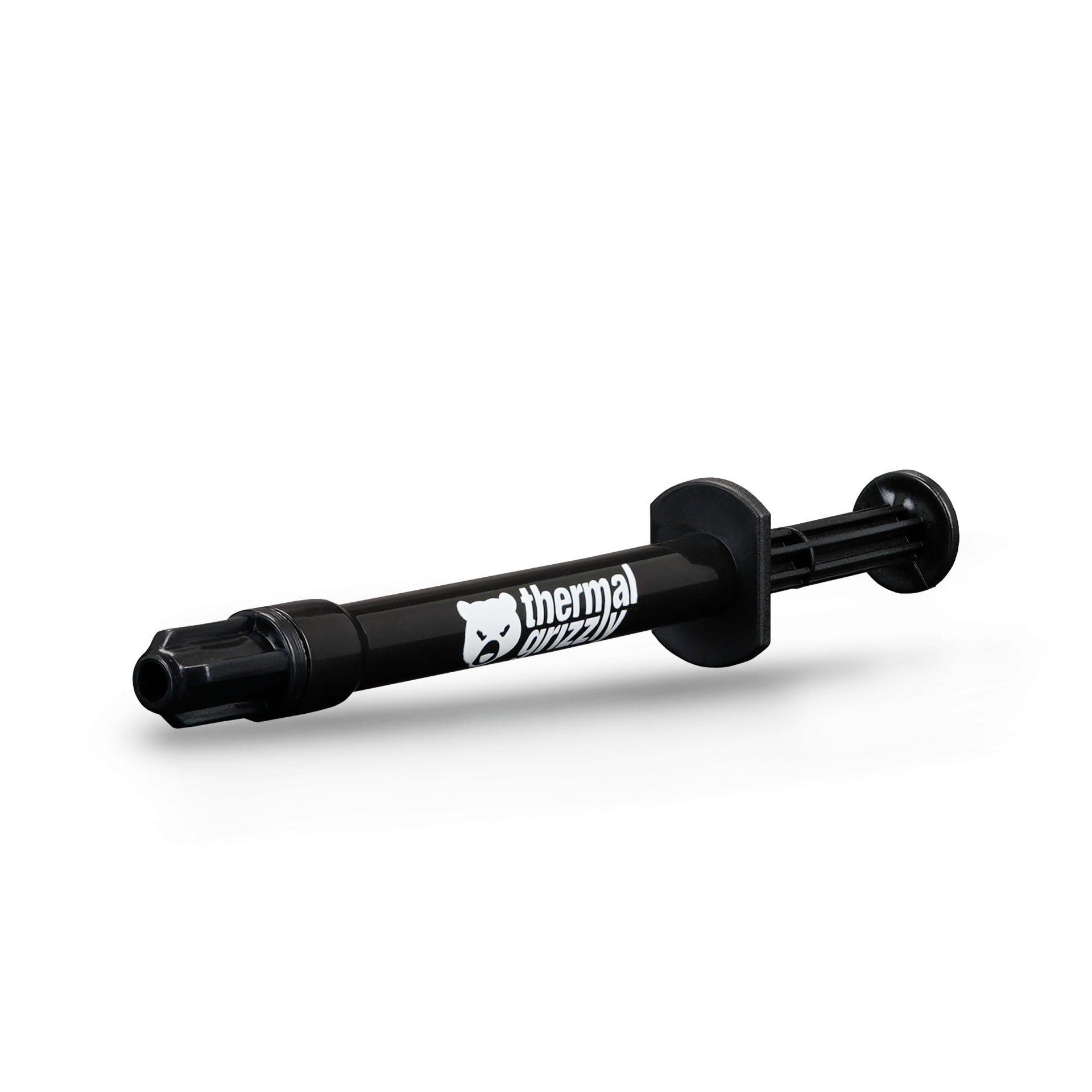

So this is my basket, I have added a 4tb steam/storage drive as the one I have is only 2tb and is not at my house to build. I have added the grizzly stuff as I am reusing my AIO cooler and need to clean it up. I think that's the right size as well.
Nail varnish remover will do fine. Kyrosheets review very well but not for that cost when a tube of Thermal grizzly Duronaut 2g is only £9.
I always put too much on. One time doing the cpu i got this weird liquid mercury one and it dribbled onto the motherboard.
