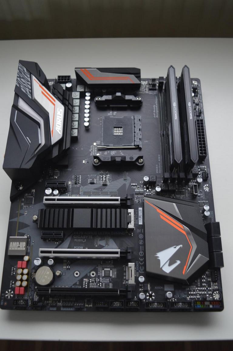

Aours 5 board, more features for your cash, specially if you happen to be running BT/Virgin routers . 3200hz kit as its a bit of a pain using 4000hz kit if its not on sale. lot of us on here got it when priced at £170 but have to go though the effort of using Ram Calculator on it to get right timings and speed.
ryzen 2600 non X but just manually overclock all cores to 4.1/2ghz with simply raising Multiplier and Voltage in Bios. still works out faster then XFR2 . X chips dont really need to be touched with Overclocking but you pay for it. specially when 2700x is £100 more then 2700 :(

B450 VRM delivery will be a lot better then B350 and dont have the issue of 'will board be shipped with latest bios' Gigabyte is UK based so can get them to flash older boards or use AMD boot kit with other vendors.
Cant lie, Gigabytes BIOS isn't as slick affair as asus and flagships tend to get the best treatment which should be the same for the whole range .
Terms of their VRM, Flagship Aorus 7 and ROG hero have same phase count and IR units (newest model ) but differ on their controller , asrock tacih uses more Phases but older IR units and same controller as 7.
as for the Aorus 5 vs Strix , Aorus is 8 (CPU) + 3 (soc) and Strix is 8 (CPU) + 2 (SOC) - will take a little time to trace IR used and controllers. flagship models is easier to find
