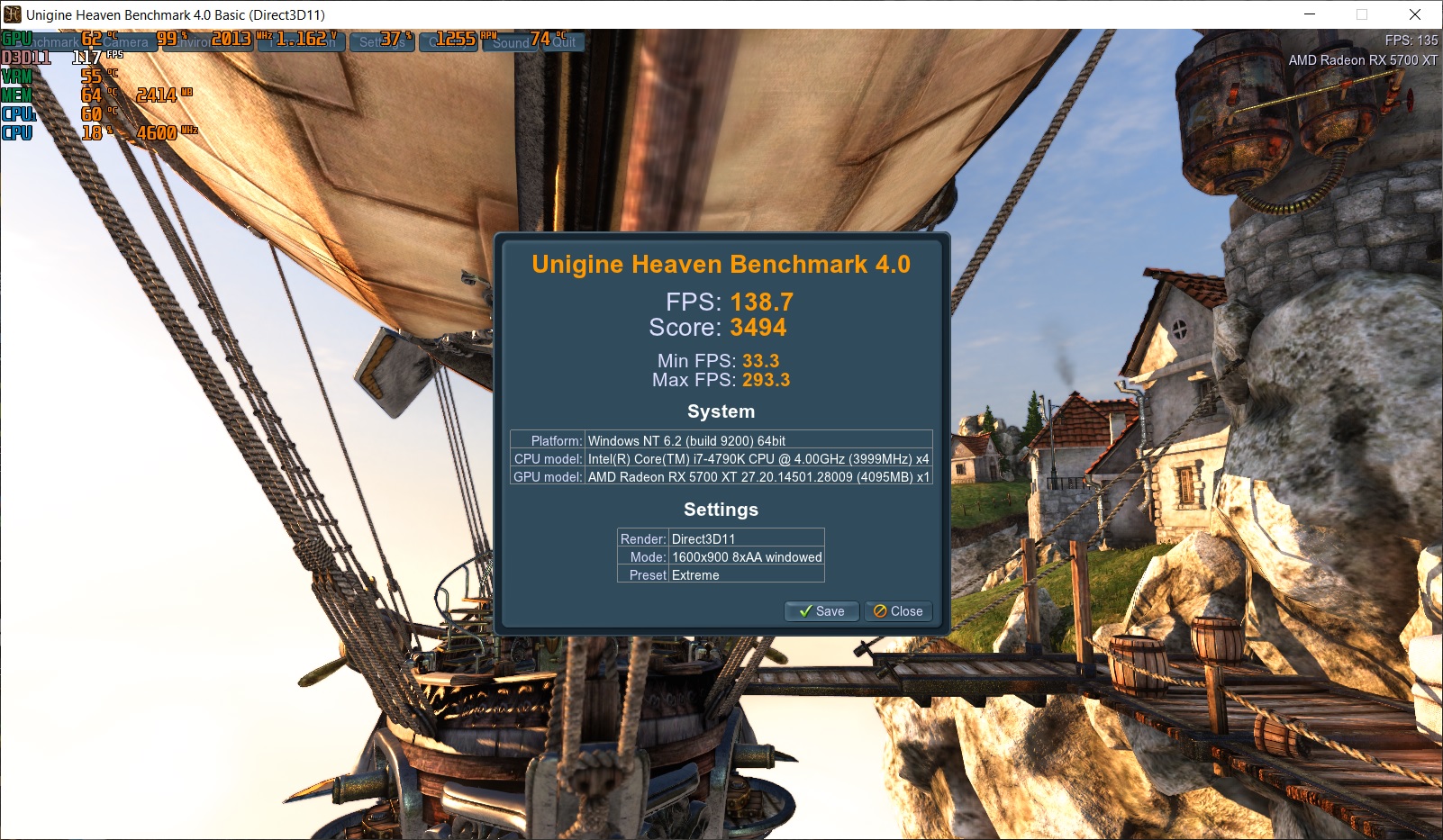

I doubt the OP will be bottlenecked by the 4790K @ 3440x1440. The gpu will be the bottleneck at such a resolution.
The [email protected] is faster than a 2400G and very close to a Ryzen 3600. I should know because I recently moved from a [email protected] to a Ryzen 3600.
The overclocked 4790K is still a pretty decent cpu so there is barely any difference between the two except when games use the extra cores. The 3600 may gain a bit more with a better cooler though.
Here's the benchmarks for Heaven on both my old and new systems.
[email protected] + Dark Rock Pro 3 Cooler
Ryzen 3600 Stock + stock cooler
OP is getting a much higher score of 250fps so I assume he is using a different setting. I know the 5700XT is close to a 2070S in normal games.
I benched at 1920x1080 without the 8xAA. Everything else was highest setting. I didnt realise i'd missed off the 8xAA with the old cpu so just used the same settings to make it a fair comparison. I stick to the 1920x1080 as ive got at least one bench from each iteration of upgrades so i can see how its improved along the way.
I do get higher fps in games with the new cpu, but its the smoothness in the low end that feels most noticeable. Ive been able to squeeze a bit more out of the gpu on the new setup, not sure if its the pcie4 thats helping or what. I'm honestly not too up to date with new OC'ing methods :o:p got some reading to do :D

I'm getting 18% faster average fps and overall score (30fps more), 16% faster lowest frame, 17% faster highest fps using the same settings as you. Ryzen 5600x is stock speed.
