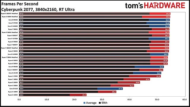

That looks positive until you factor in a more recent game like CP2077 (which they didn't). @morta 's 7700k would sit below the 3300x on that chart and maybe even at 1600x level. Granted, this is an RTX 3090 not 3080 benchmark but EVEN at 4K there is bottlenecking by older/weaker cpu's. I reckon the same would be true of FS2020 as well which hogs cpu power and needs more than 4 cores to pair well with a 3080.

I agree those 2 games will definitely need more than 4 cores , as the op wants to get into streaming it makes sense to upgrade.
