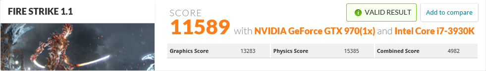

Tried 3dmark and on firestrike it went from 3217 on my ATI 5870 to 9163 on this 970 :)
My ref 970@stock/3770K-Graphics Score11937, so as above, it's thereabouts.
Massive upgrade from a 5870 so no doubt you'll notice a huge improvement, enjoy.:)
