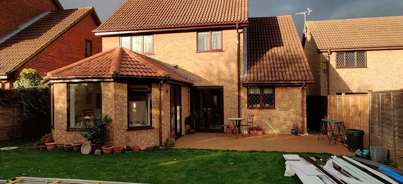

Had the work (as mentioned in my earlier post) done recently, went with a middle to expensive quote from a recommended firm, total cost just under £8.5k.
Looks a lot better than before and all was well...until it rained. Multiple leaks, silt from the cleaning of the roof cleaning blocking up a soakaway plus other issues. Flew my MM2 up to have a look-see and the amount of silt still up there is ridiculous. Waiting for them to come back, again.
