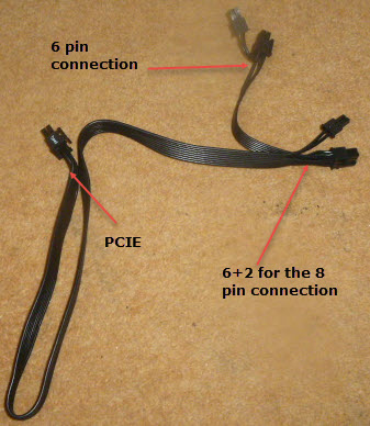

One more question when connecting the power to the GPU which has an eight pin connection and a six pin connection can I use the same cable which has both plugs at one end and the PCIE at the other or do I have to use two different cables for example one for the 8 pin and one for the six pin?
you can use a single cable that has dual 6+2 pcie pin on them :)
that unit is fine to use just one cable with 2 plugs
Just to clarify my ignorance I can use just one cable as the one shown from the PSU to the GPU use the 6+2 for the 8pin connection and use the 6pin from the other 6+2 end for the 6pin connection :confused:
