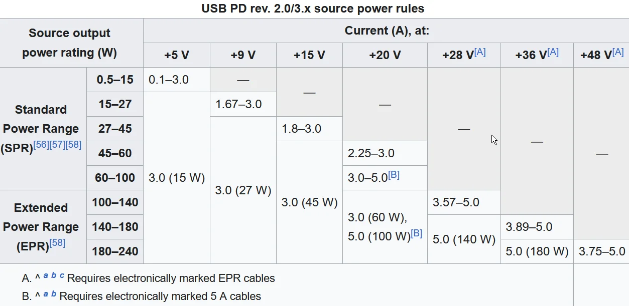

The Wikipedia is a good start on this:
https://en.wikipedia.org/wiki/USB-C (tells you that not all USB-C implement PD or any alternative modes)
So upto 48V (same as PoE I think) but also high enough amps.
Qualcomm's QC has even more variants:
Now whether all cable can actually handle 5A @ 48V? Probably not. And for somethings you may not want a 5A cable as they will be thick. Charging a phone with a 3.7V @ 5Ah ~ 18W or so battery at 100W always sounds like trouble. Yes, 12 mins for a full charge but won't the battery get hot, or at least wear out even faster. For ultra-fast charging, a removable and swappable battery is the way to go - pity that phone manufacturers in their quest for built-in obsolescences have almost totally stopped offering those!
