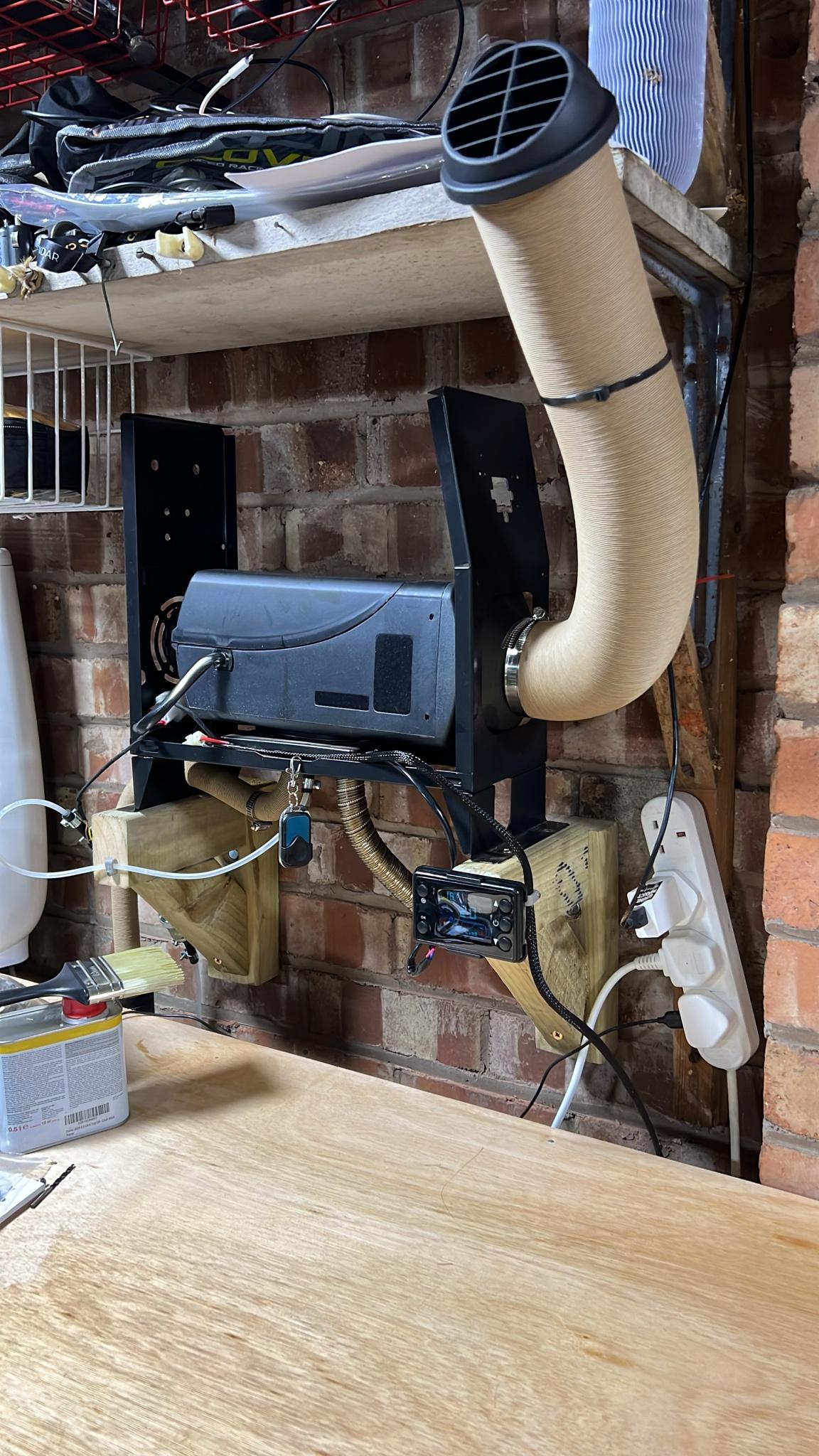

The heater unit sits in the bottom of this frame, the tank would sit directly above it. I plan to make a new enclosure for this, as well as weld up some better brackets. Not for strength, just for looks really. I have the metal to do this but not a welder at the moment so it'll have to wait a short while.
I've relocated the control panel so it is more accessible and not attached to something that is going away...

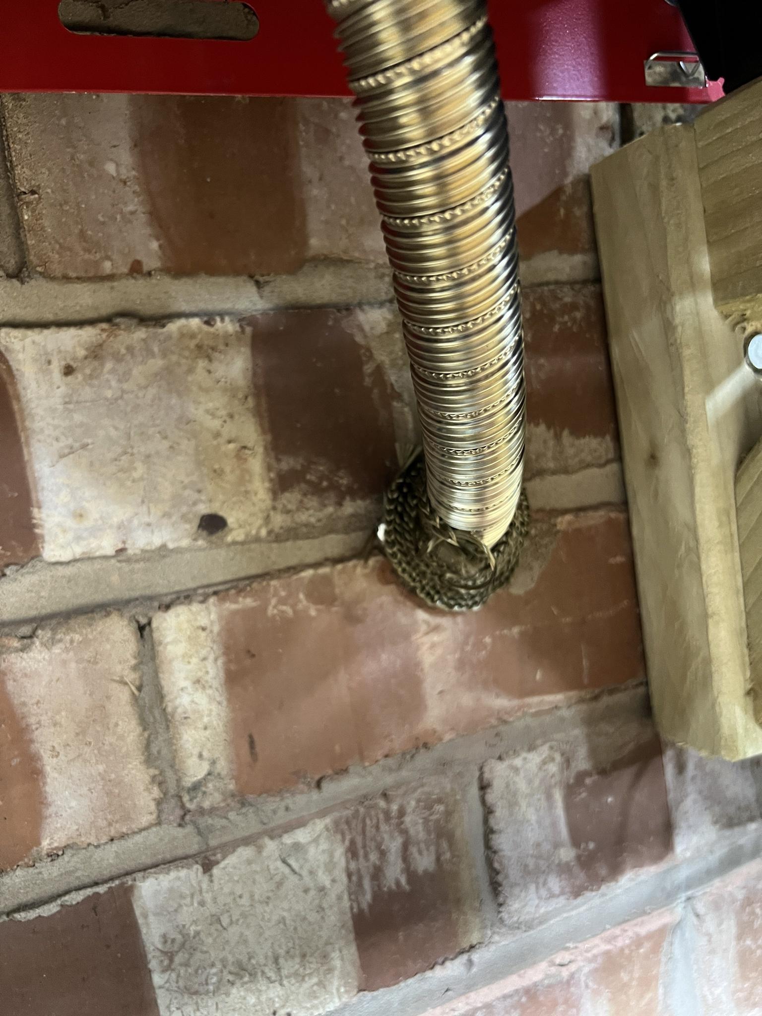

Exhaust pipe goes out the wall like this. Not perfect but plenty good enough. There is a silencer/muffler mounted outside at the lowest point, and then from there a vertical pipe takes it up to roof level so the exhaust gasses don't sit around in the passageway between the garage and the house. Condensation is taken care of by a drain hole in the bottom of the silencer.
There are people out there running the exhaust through iron radiators to recover even more energy. I've not gone down that exact route because it is extremely dangerous to have a radiator at ~200c inside. It would be far too easy to touch it or for something to accidentally come into contact with it and potentially start a fire. A far safer idea is using sand as a thermal battery or potentially creating a water loop similar to traditional central heating. I might go down these routes in future just to drive up the efficiency a bit but I think Kerosene would have to double in price before I'd go down that route.

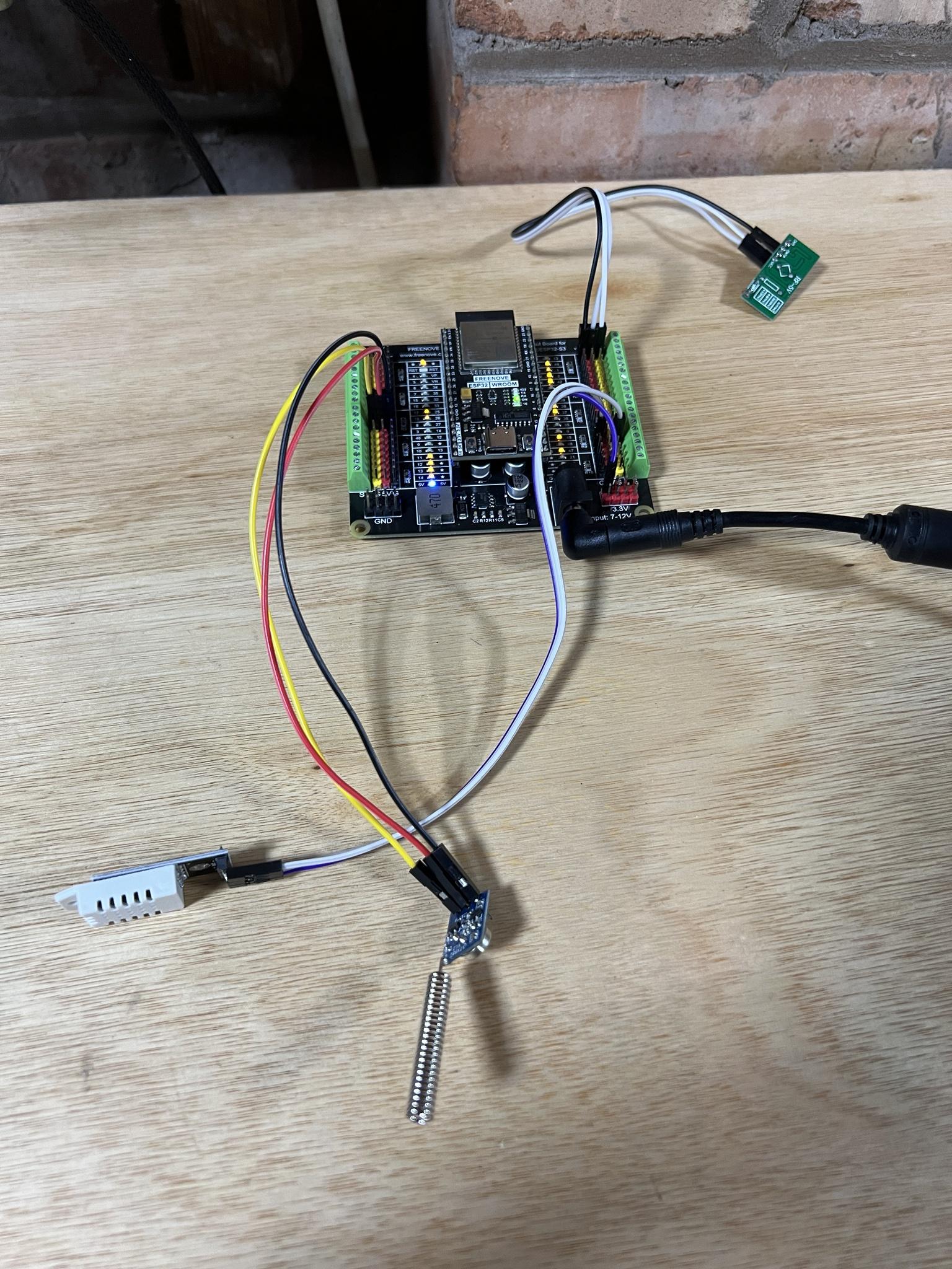

ESP32 and modules. I'm printing an enclosure for this at the moment, then it'll be wall mounted somewhere nearby.

Do you have any details on the esp32 setup?

The board is a Freenove ESP32 WROOM board. Chose that because the matching Freenove breakout board matches up with the pinout perfectly and is quite a nice "thing". Definitely unnecessary and any ESP32 board will do. The board itself is flashed with ESPHome just because it plays slightly nicer with HomeAssistant when you're not tinkering with it, at the expense of making changes being slightly less easy than with Tasmota. Its a case of picking your poison here, Tasmota is arguably better in as much as changes are easy and instant but you have to deal with MQTT whereas ESPHome is all YAML-driven and all changes must be compiled which takes a while and is especially irritating if you want to make several testing changes back to back in quick succession. ESPHome talks to HA via REST and is quite a lot quicker to react compared to MQT.
Temperature is measured with a DHT22-compatible sensor, RF transmission is an STX882 and although the cheapo receivers I had worked just fine, I'd just buy an SRX882S when you get the STX882 and that will be totally fine. To program it, you just have to press the buttons on your remote and then grab the output from the logs.
YAML:

Once you have the codes you just update the code: value for each operation and set a value for how many times you want it to repeat. I tried finessing this but it made it unreliable so it now sends the codes 5,000 times to turn it off and 10,000 to turn it on. I'll make them both 5,000 now it is reliably turning it off every time.
After that, I just have a simple automation routine in HA that detects the temperature falling below a set point (5c in my case) for more than a certain amount of time (5 mins) and then sends the code to turn it on. I have another automation to turn it off once the temperature has exceeded the warm set point for a period of time. It is important that you don't have it cycling too quickly. The heater takes a good while to shut down after it has been turned off as it keeps the fans running to prevent overheating so you need to make sure there's likely to be plenty of time between it turning off and needing to come back on again.
