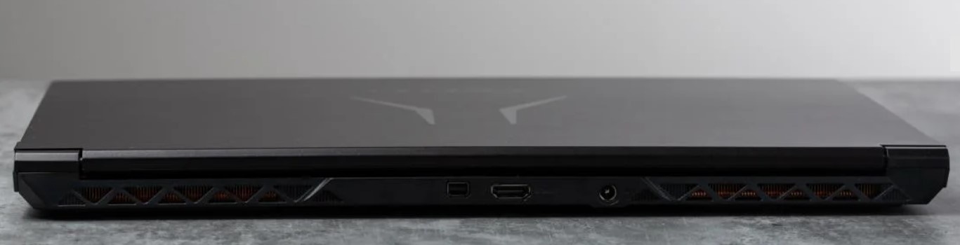

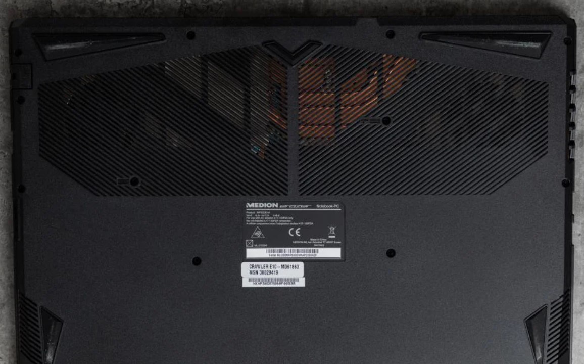

This laptop has intake venting from the bottom and exhaust ports on the rear and side. Having the lid closed should have no detrimental effect on the running of this particular laptop, providing that there is no blocking of the intake. It's also worth noting that this laptop doesn't have the A cover (lid) that lifts the rear of the laptop to aid in cooling.

No issues here, I understand where you're coming from, but in this case I see no reason why there should be any thermal issues given the venting configuration on this device.
