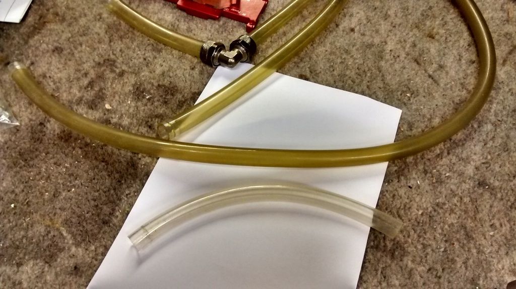

Just stripping my loop for the first time since I built it about 16 months ago (been putting it off) and the tubes look like this:
http://i1308.photobucket.com/albums...04/IMG_20160418_211352851_HDR_zpst5ly9ve5.jpg
The one I'm comparing to isn't even new, it was some offcut and looks like I've used it at some point. You can see the ends of the tubes where the fittings have been. The clear blocks and res tubes are fine.
I've been using Mayhems green UV coolant, but I'm convinced thats the UV lights causing the discoloration, especially where the fittings have protected it. Thoughts? Is this normal!?
Tube is masterkleer
Also photobucket is rubbish, any alternatives? Everyone seems to like imgur??
Masterkleer is made by alphacool / aquatuning / phobya (all the same company) and they have over 6 different types of tubing. So saying what it is isn't easy but it probably will be dye stain along with UV reaction. Tubing is a throw away item so just replace it :).
Thanks for the fast reply! Oh it's not the end of the world - just tubing as you say and I was going to replace it anyway. I was just blown away how much it had deteriorated!
Noticed something similar with a few types of tubing I use.
One section runs across a window ledge to an external rad, It always amazes me how quickly it gets a cloudy look to itself due to I presume sunlight as the rest of the rig doesn't do anything similar.

They were Phobya's UV led strips. Although I've changed them out on my rebuild with uv cold cathodes
I can guarantee you straight away Phobya Leds strips are cheap useless rubbish. They do not give off good UV reactions at all. There one of the worst if not "the worst" UV Leds strips ever created and the band on them is so tiny they are out of range of most UV coolants. Ditch them and go for a much better brand and never turn back.
One thing to note Phonya LED strips also amit UV levels and ranges that are actually bordering on illegal. Put a sun uv level tester near them and you'll see actually registering on it. These leds Damage and ruin not only coolants but also tubing. We did tell them about this along time ago and they chose to ignore our findings.

Darkside are the best, UV in the UV white does lose its glow for one of three reasons.
1) Sunlight / UVC
2) PH imbalance (very Ph sensitive)
3) Age + excessive heat
We are working on a new formula to fix the above issues.
