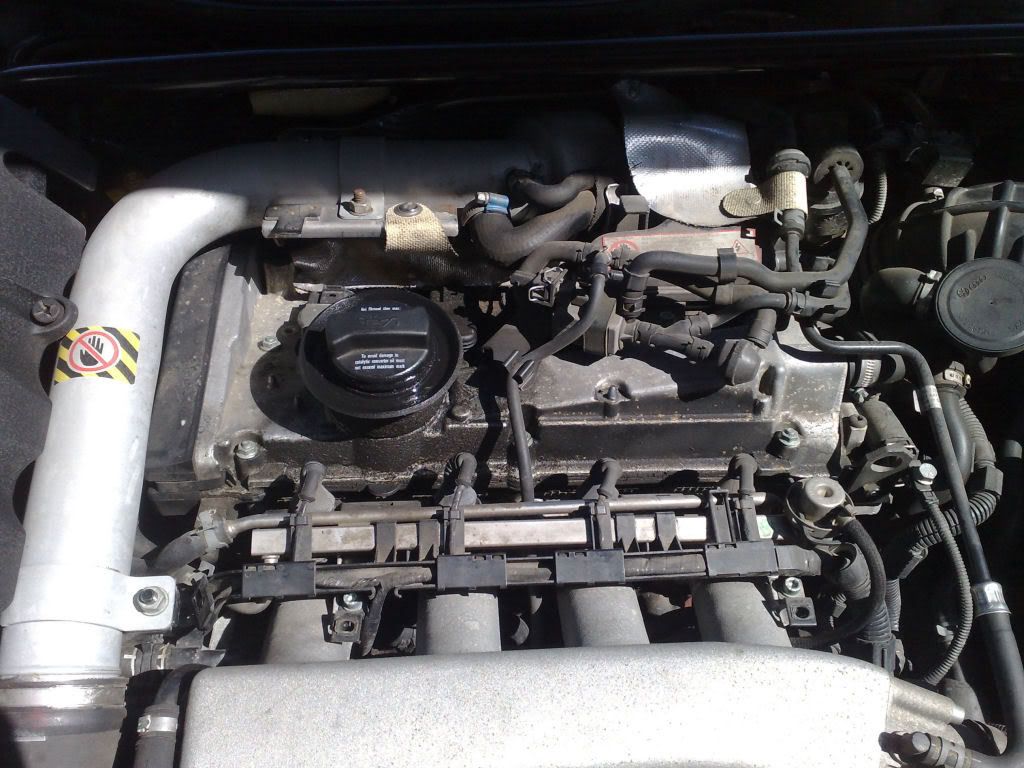

Just taken the top cover off the engine to check the DV valve, considering changing it for an upgraded one as ive had the car remapped, but there seems to be a rather large amount of oil around the filler neck (i presume its just long to be able to be accessed with the engine cover on, it seems a tad loose :(
Not showing as low on oil so maybe its just spillage? Anyone noticed anything similar on theirs?
Either spillage, or its working its way out of the engine, or both.
They (the filler cap necks) just push into the rocker cover.
Right, well ill keep my eyes on it, doesnt seem to be using much oil at the min, well cant be too sure ive only had it a month and done about 1k but the light hasnt come on, ill keep checking the levels, there is a bit of oil at the top where the cap is, so Im hoping its just overspill
Check for seepage out of the gasket, but I don't think its anything sinister. All the "mess" there is above the gasket line, on top of the rocker cover, so I doubt its actually coming from the engine. I'd be pretty certain its spillage.
looks like a spillage to me.
