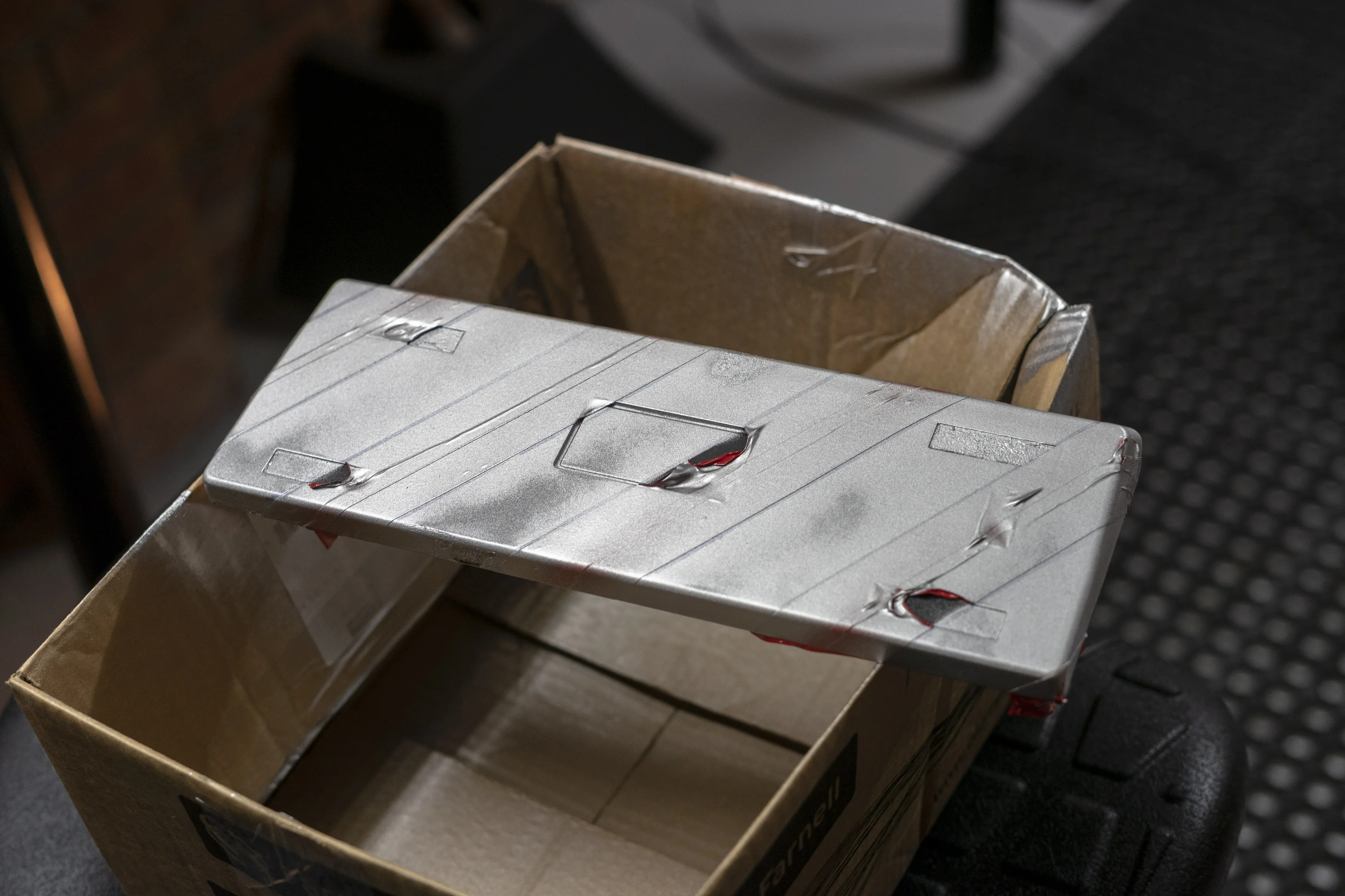

Its been a while since I managed to find the time to squeeze in a build in between my manic worklife! Following off the back of my Vault 111 build, I want to continue the 'battle hardened' style, with actual damage, dinks, holes all the gory bits, not just vinyl stickers and paint.

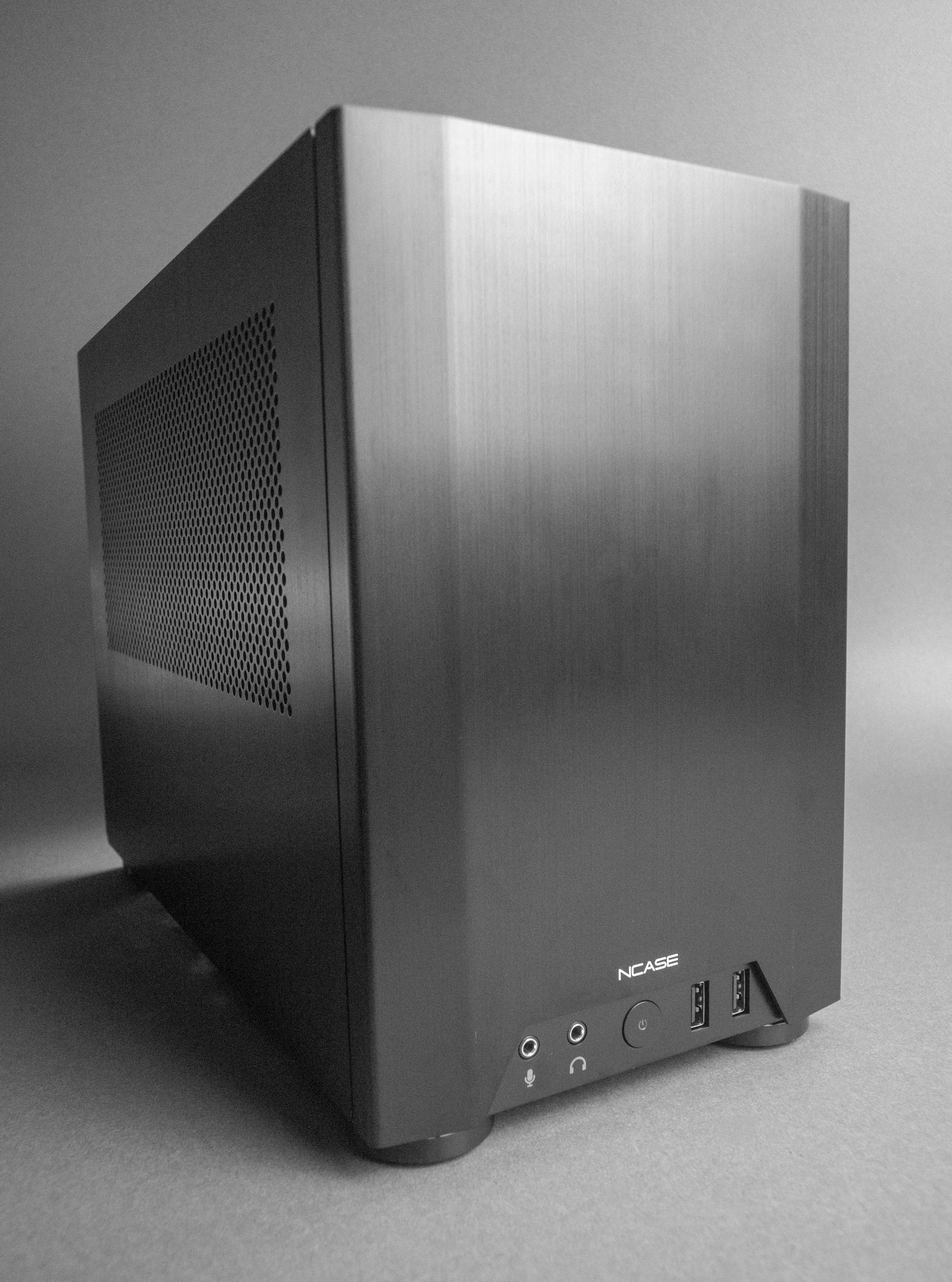

This time around, something different and something to challenge my skills, I am going with a glorious N-CASE M1 v5.0 Massive thank you to Joshua and Dan SFF Lab for generiously providing the case and allowing me to 'distress' it! :D
First job was to get some work done on the case.... on to the fun stuff!!!

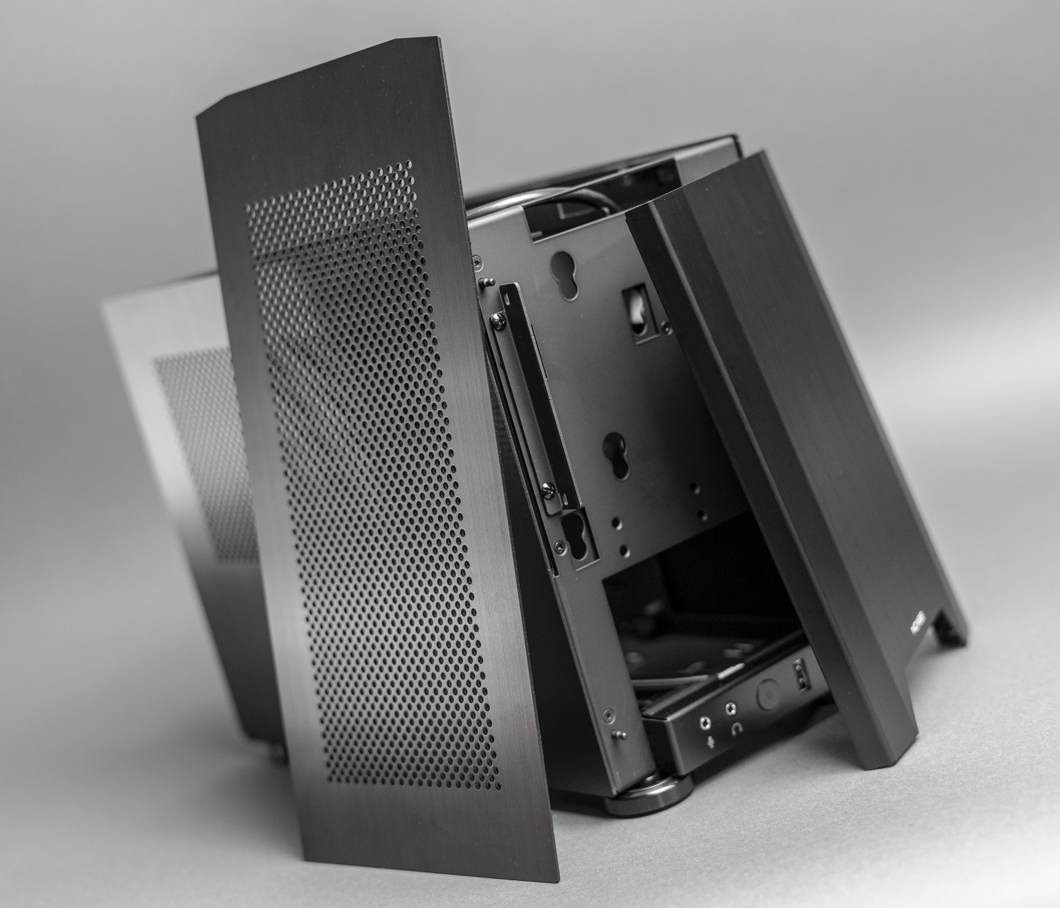

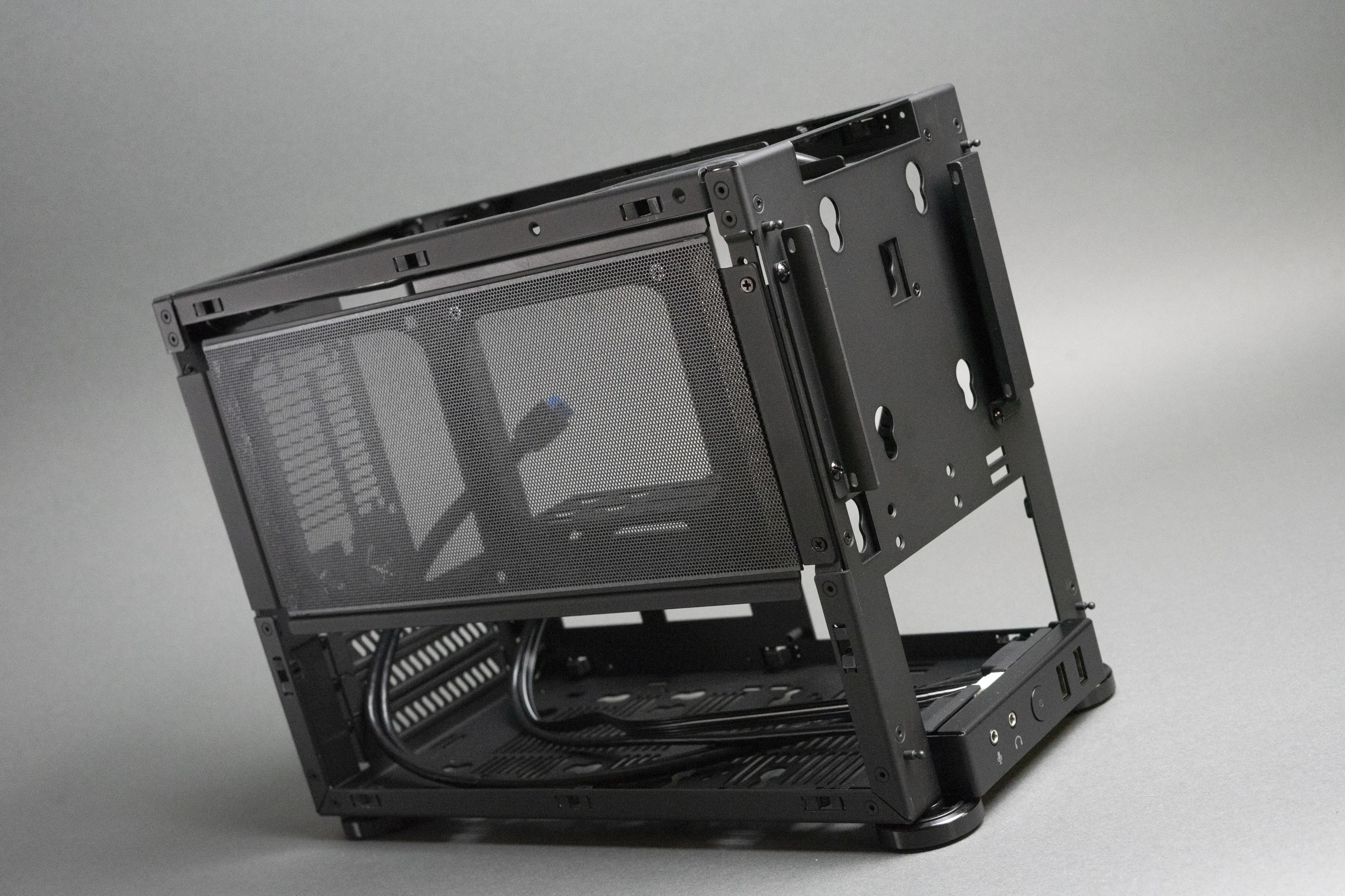

The M1 is absolutely STUNNING. The build quality is second to none, every panel is removable, the finish is spotless and all the accessories will allow me to have endless options for cooling, storage and GPU choice

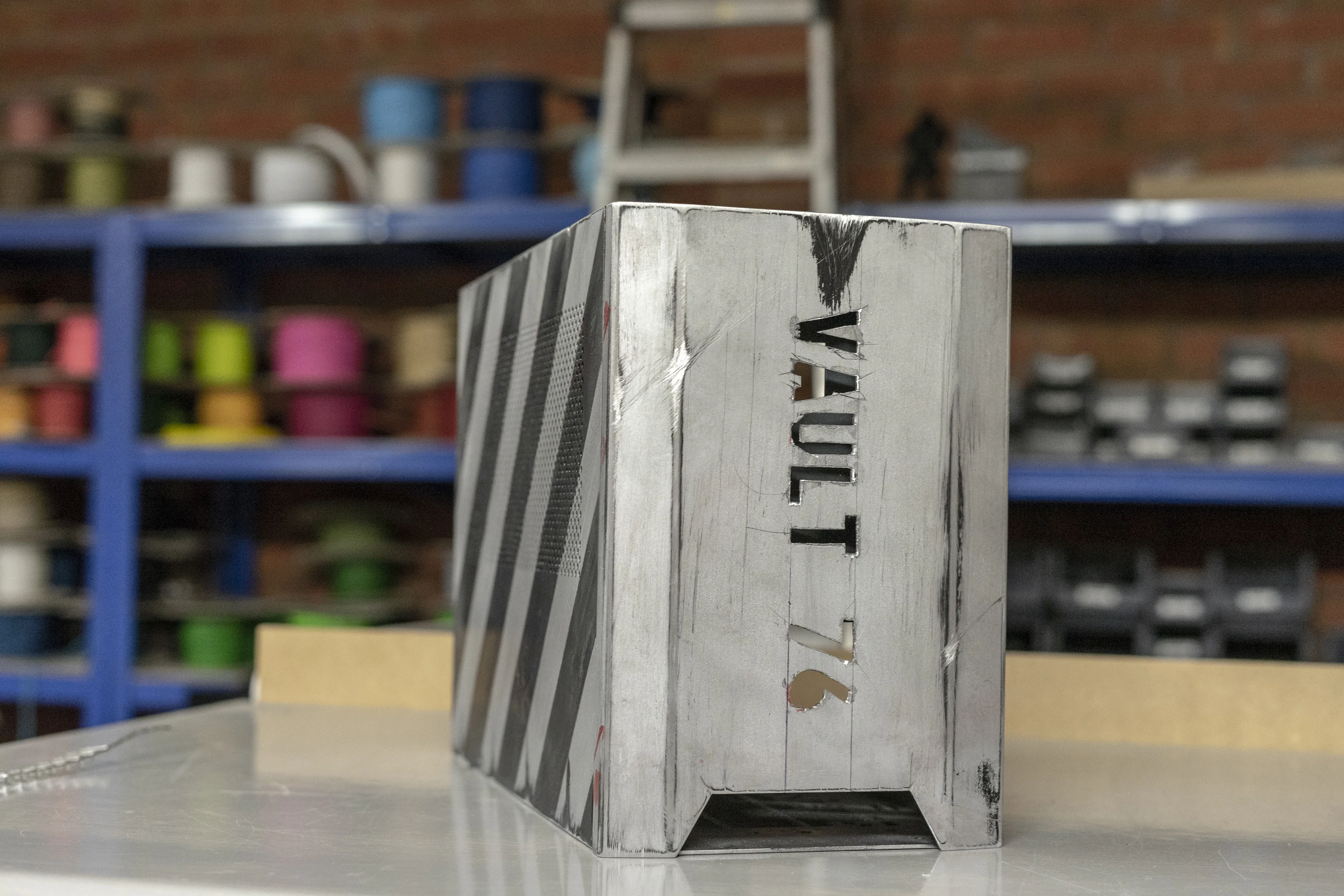

Now, on to some distressing...

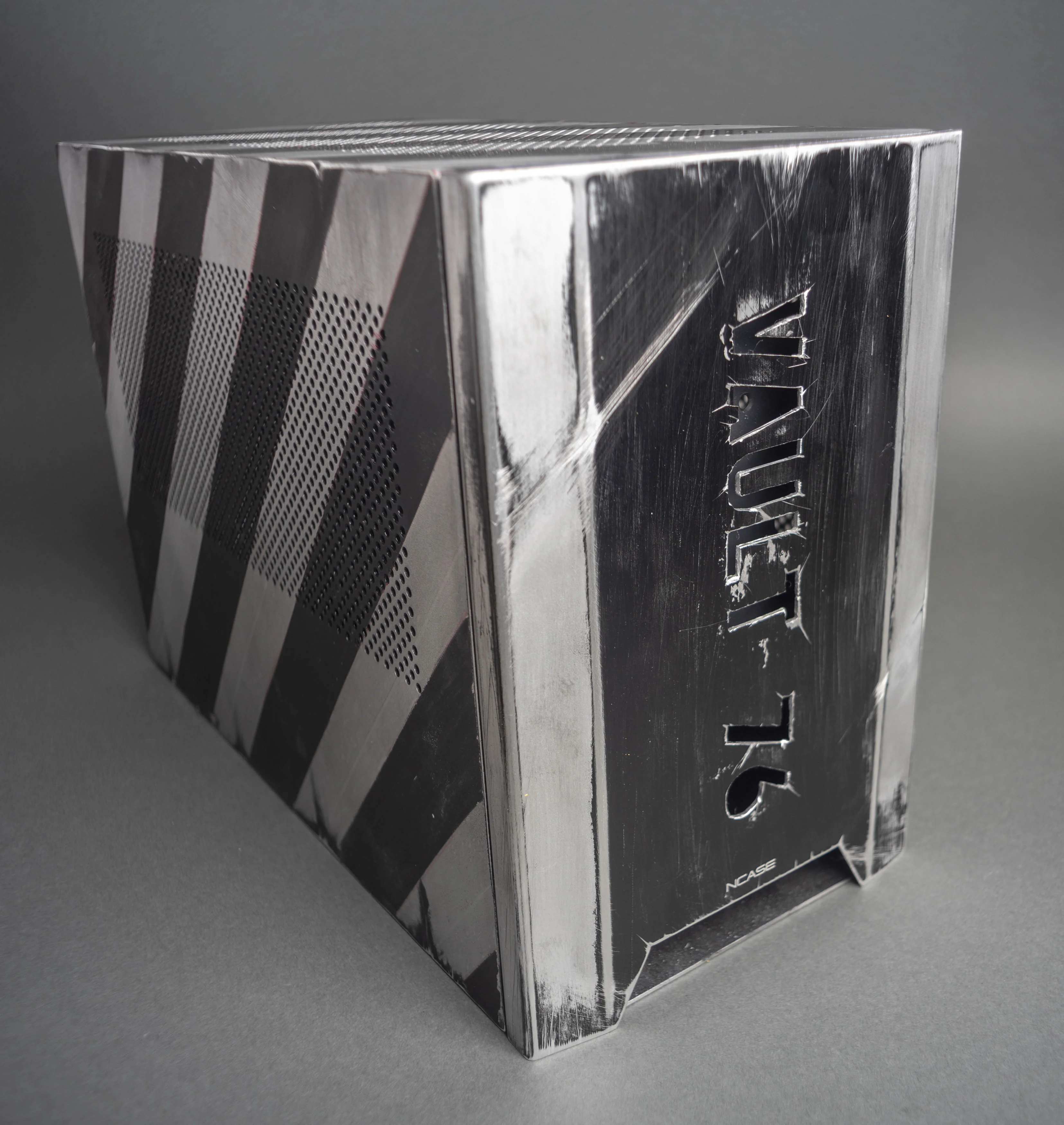

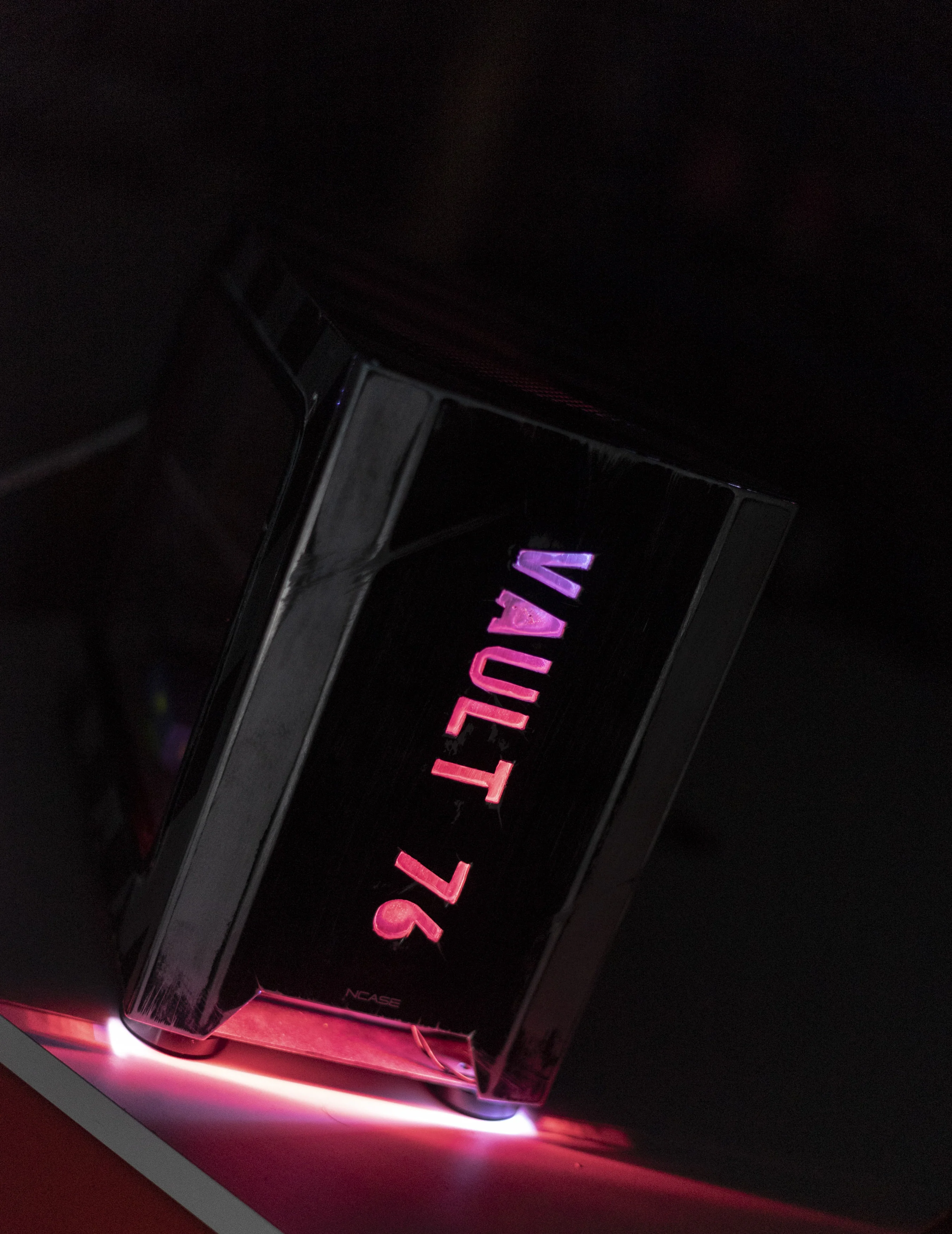

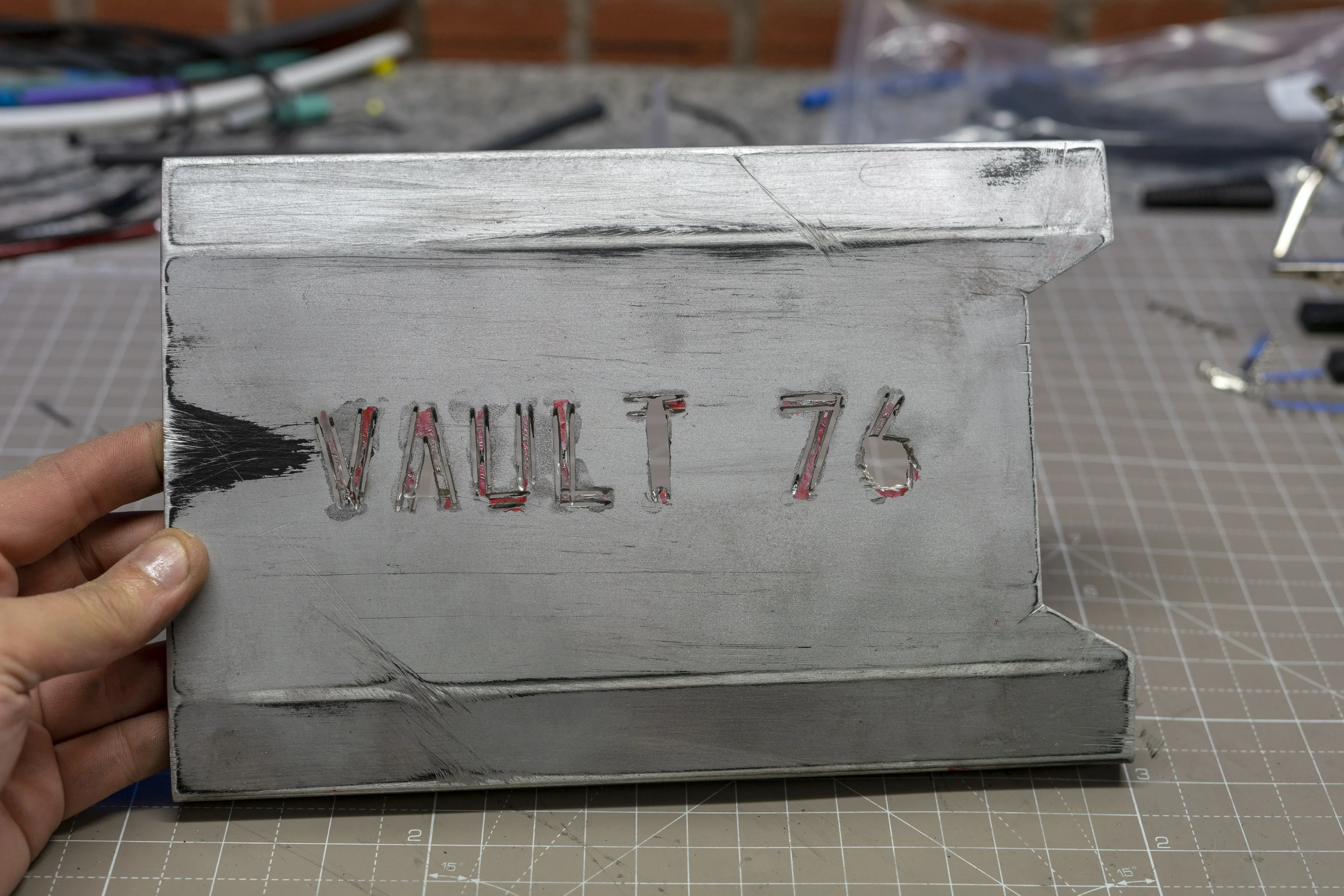

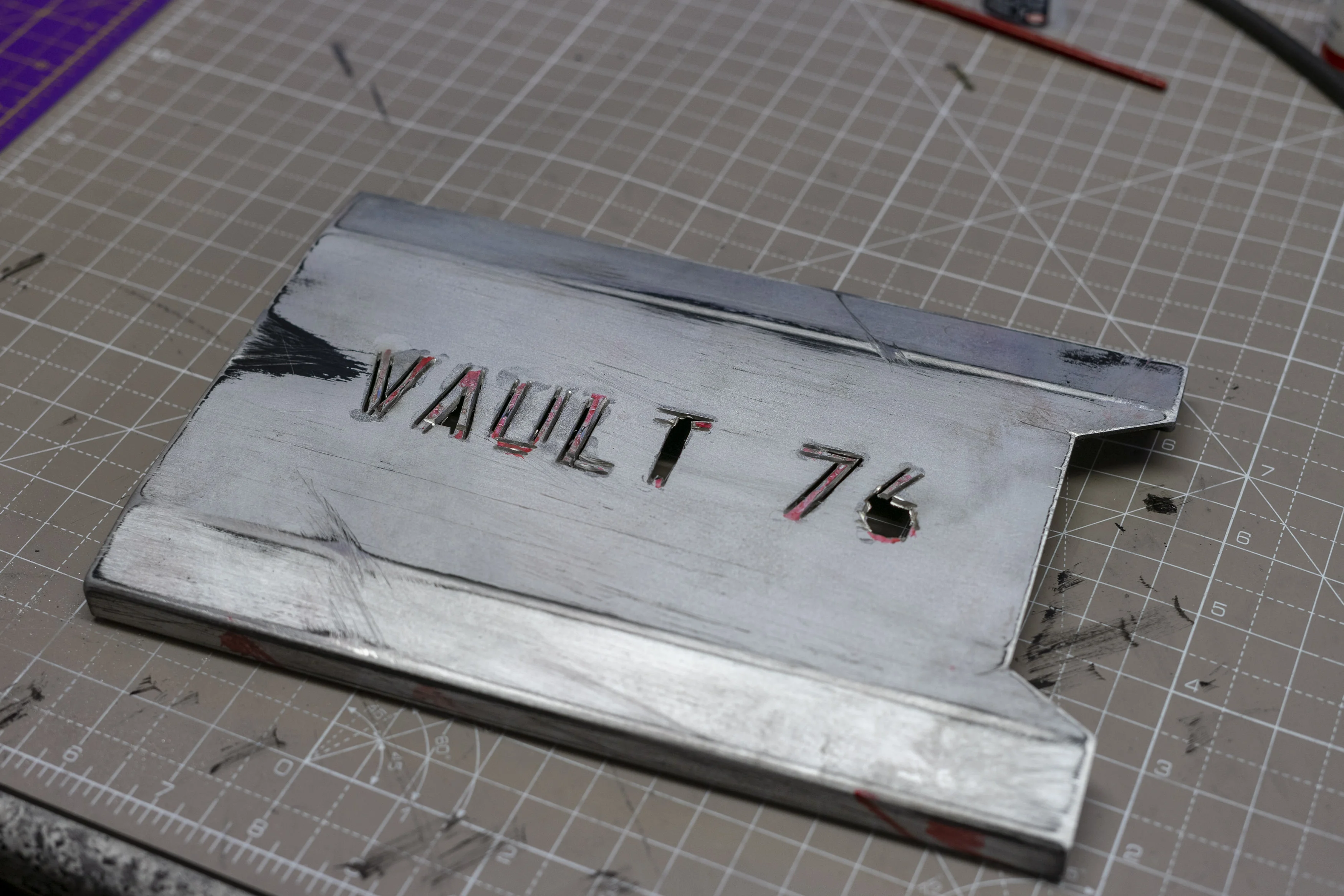

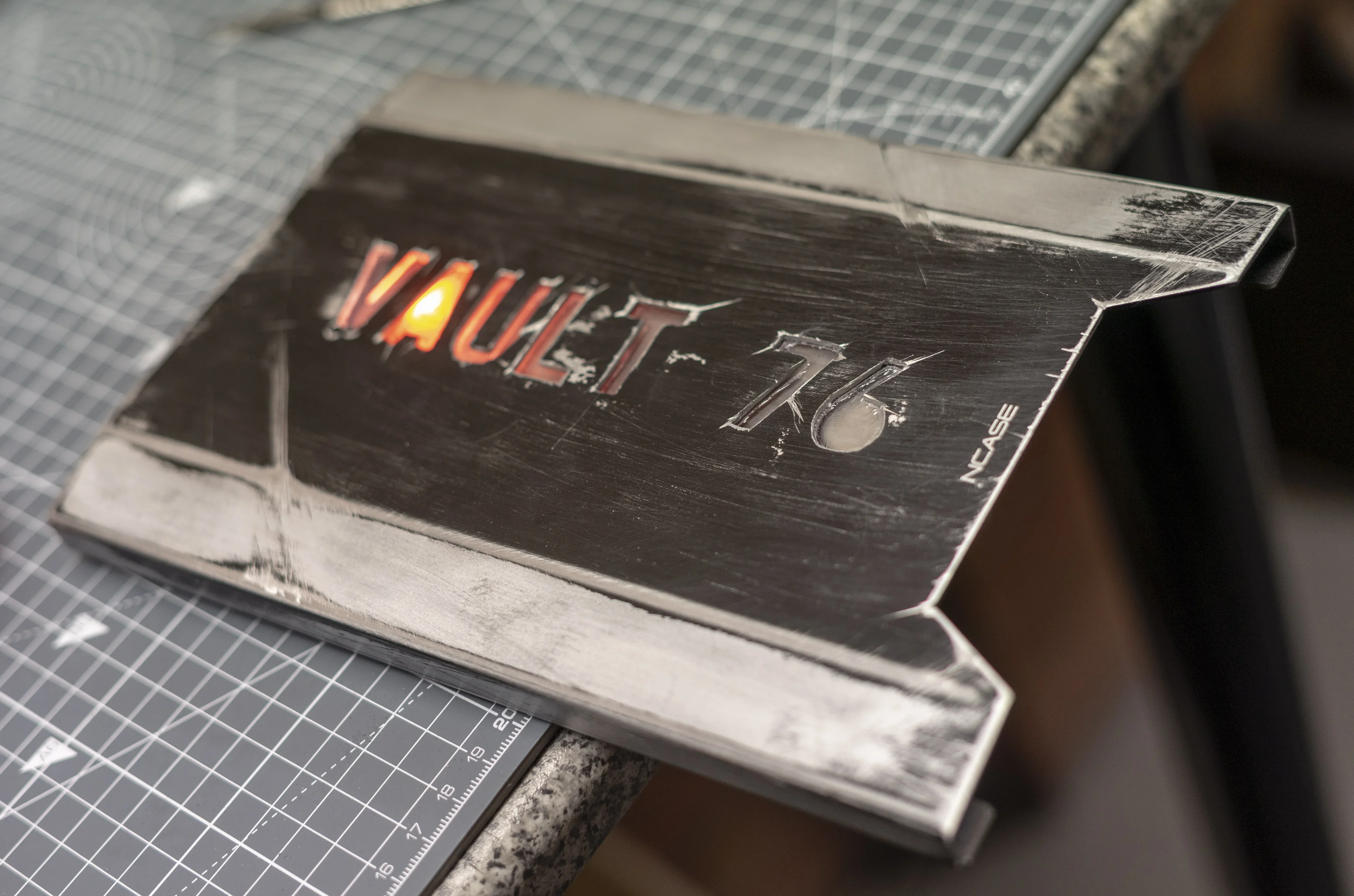

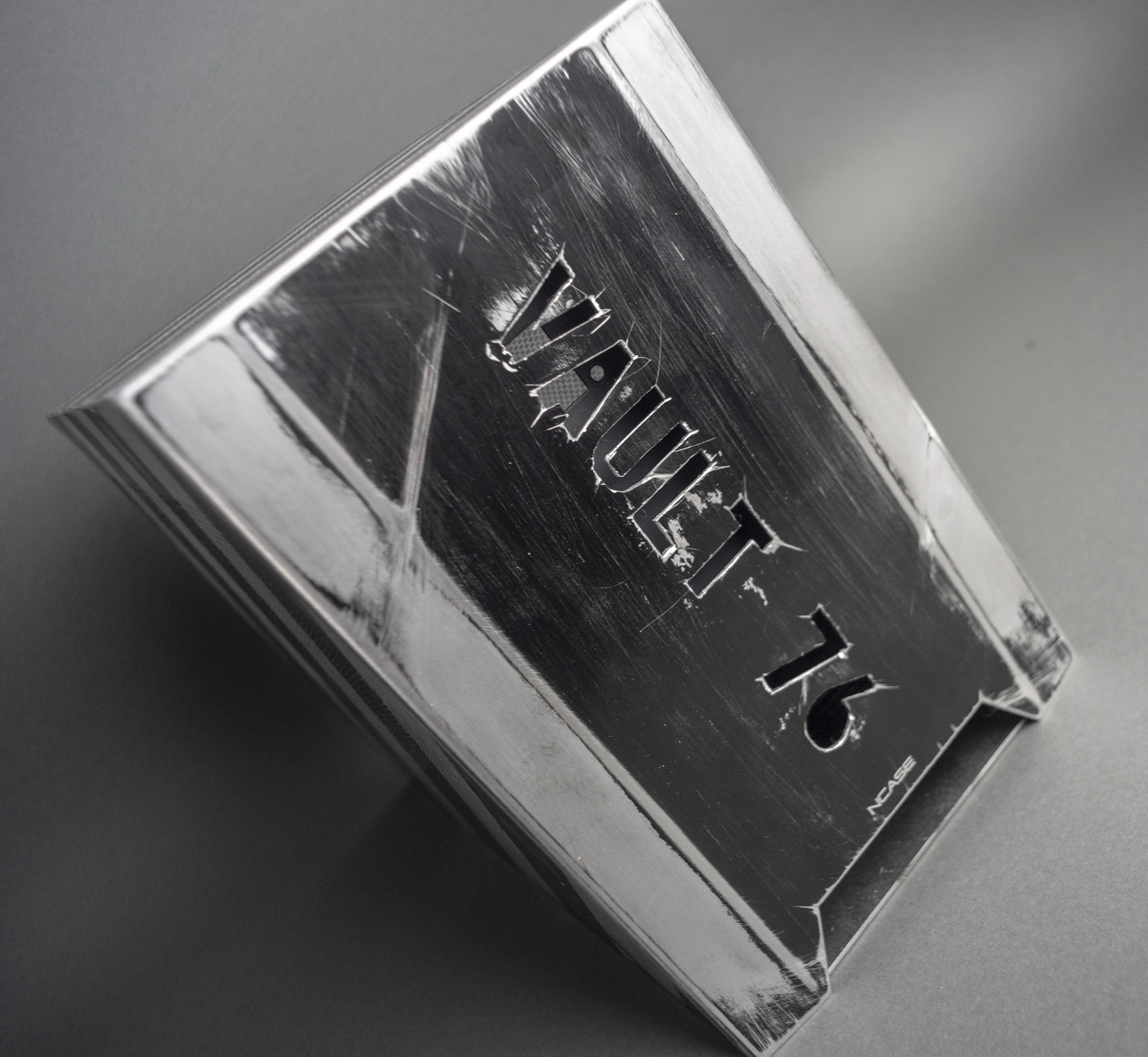

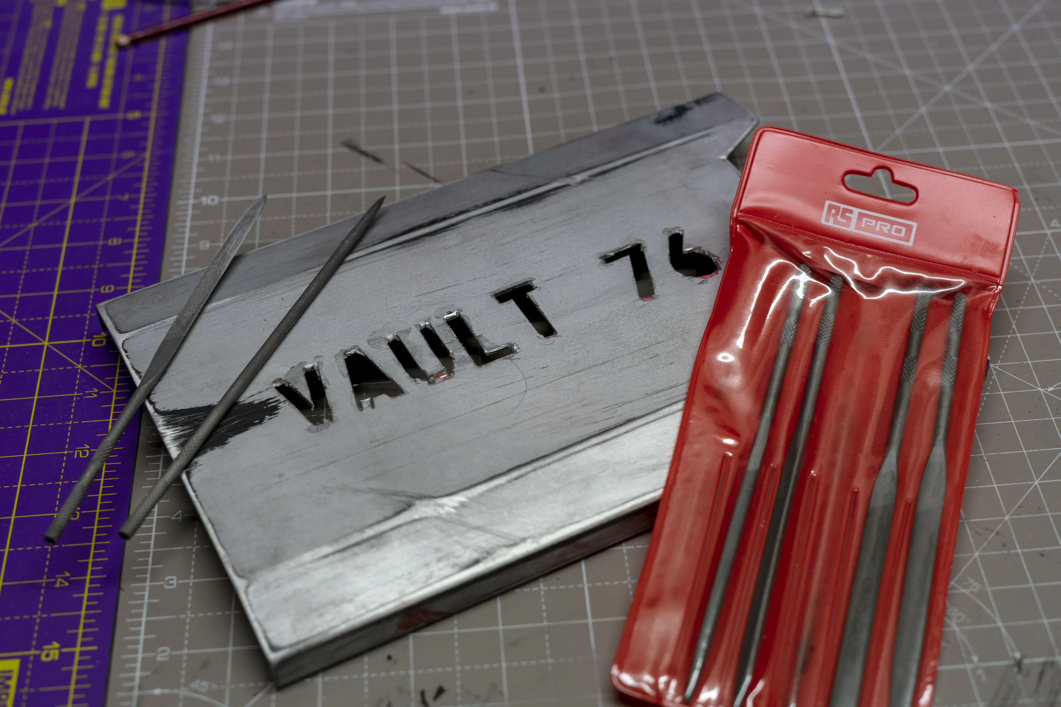

Rough dremelling on the front to get the Vault 76 text cut out, I will mount some clear, sanded acrylic to add some nice back glow to the front.

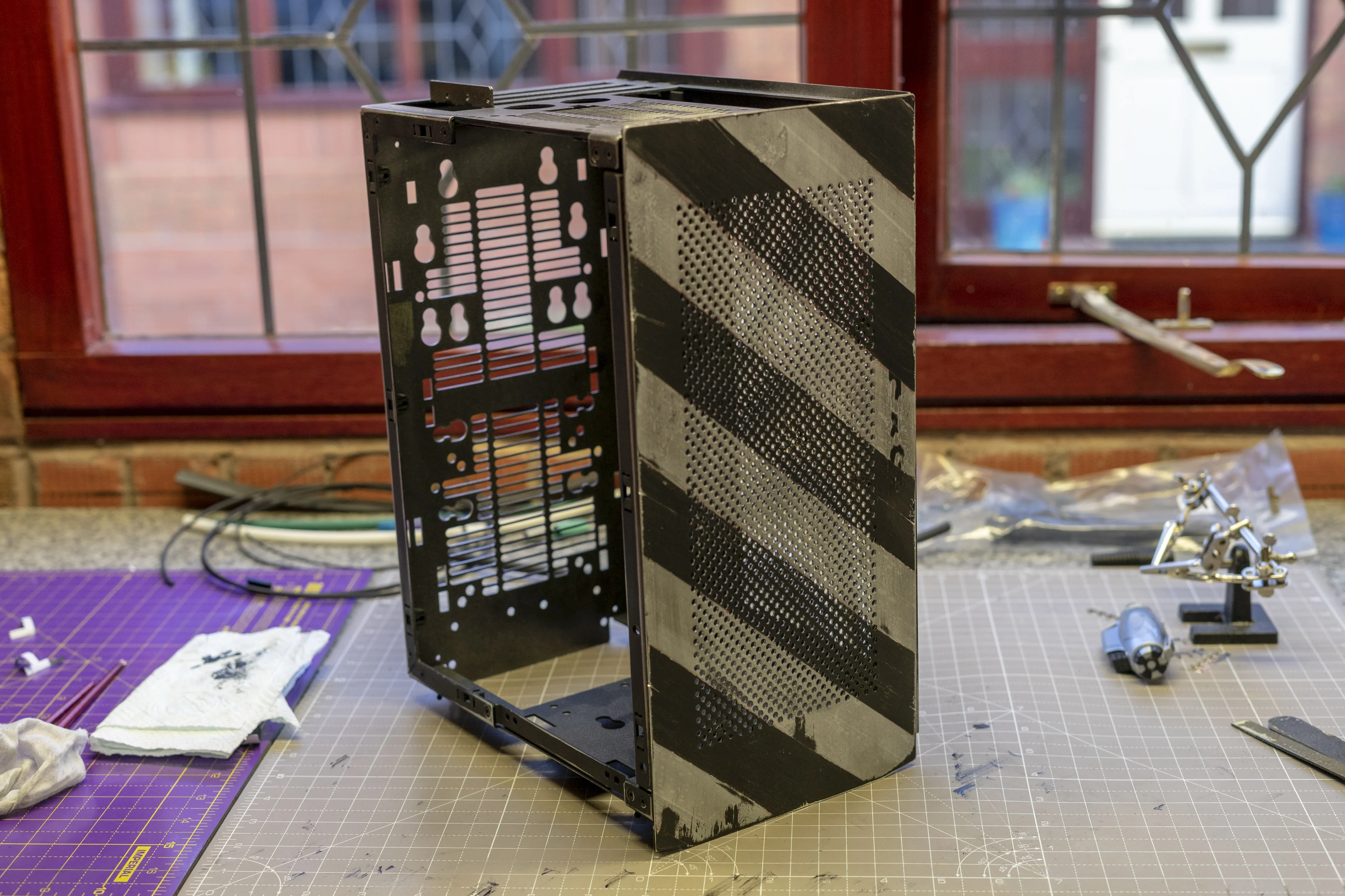

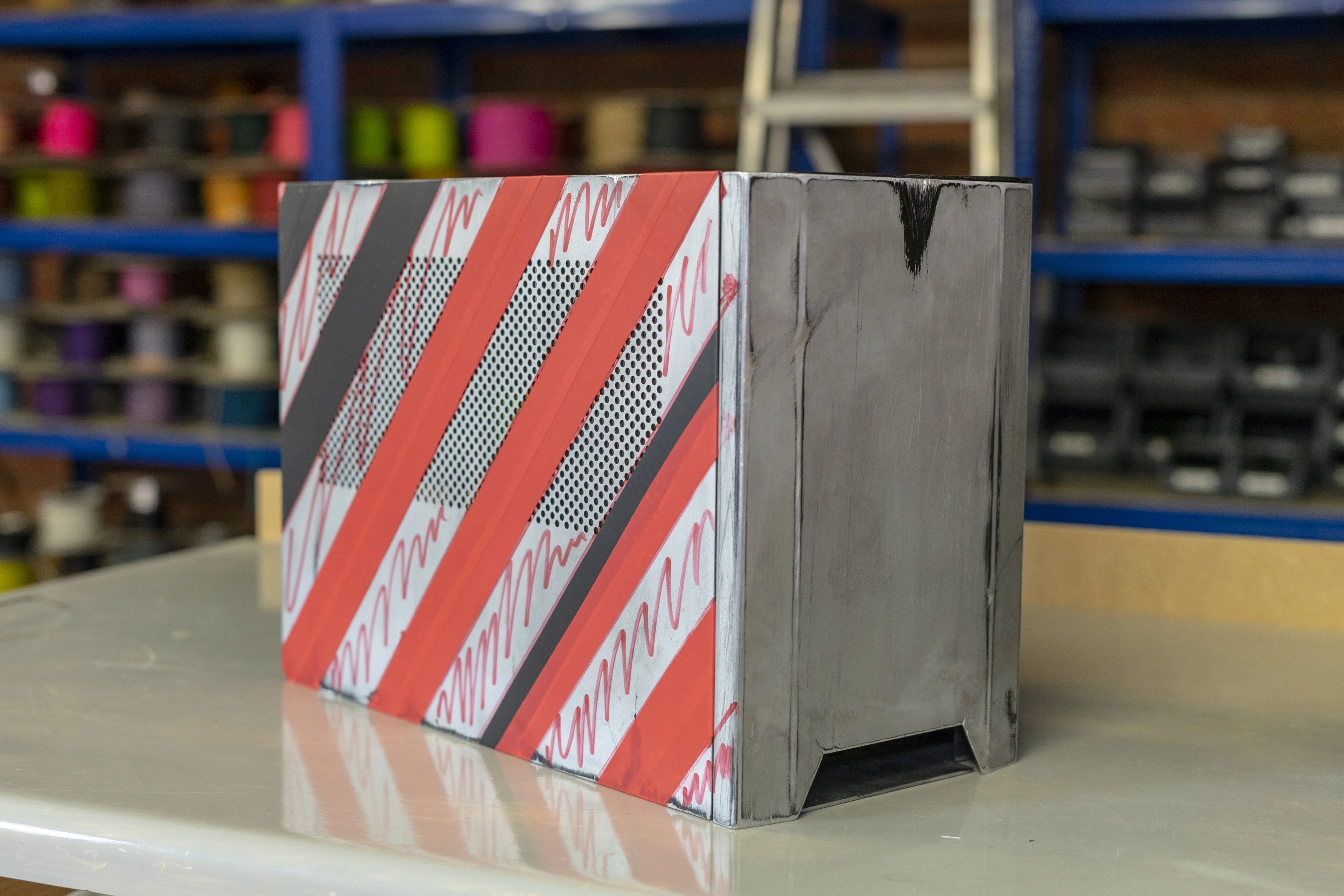

I felt the front needed breaking up a little, so I added some rough black spray paint on the front and sanded it back down and added some rough files cuts and acetone to loosen the still wet paint

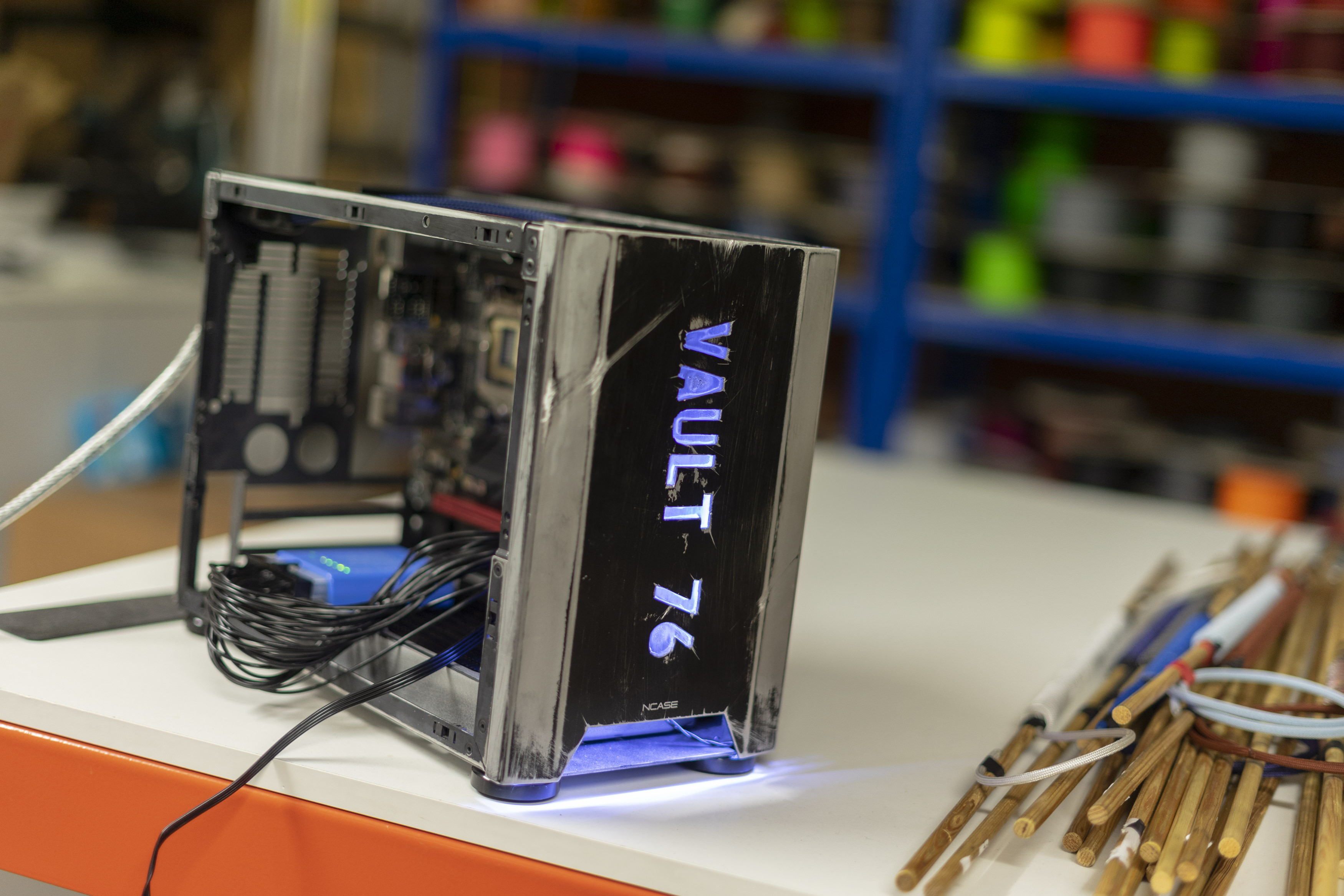

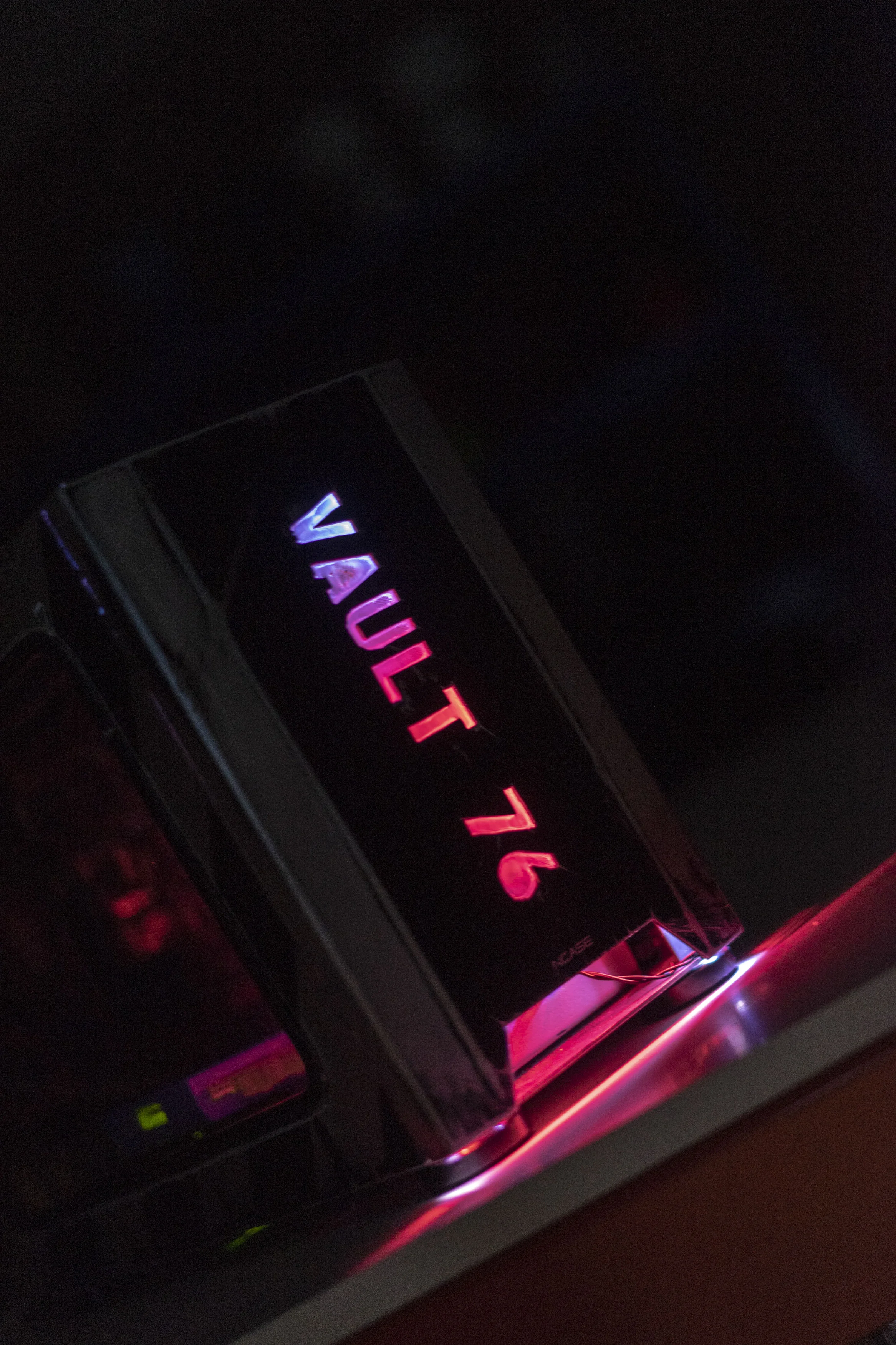

Its not very Fallout-y, but I realllly like the red LED glow on the front, on Vault 111 I used blue and yellow as the dominant colours to contrast the black and silver, I am digging the red this time around though.

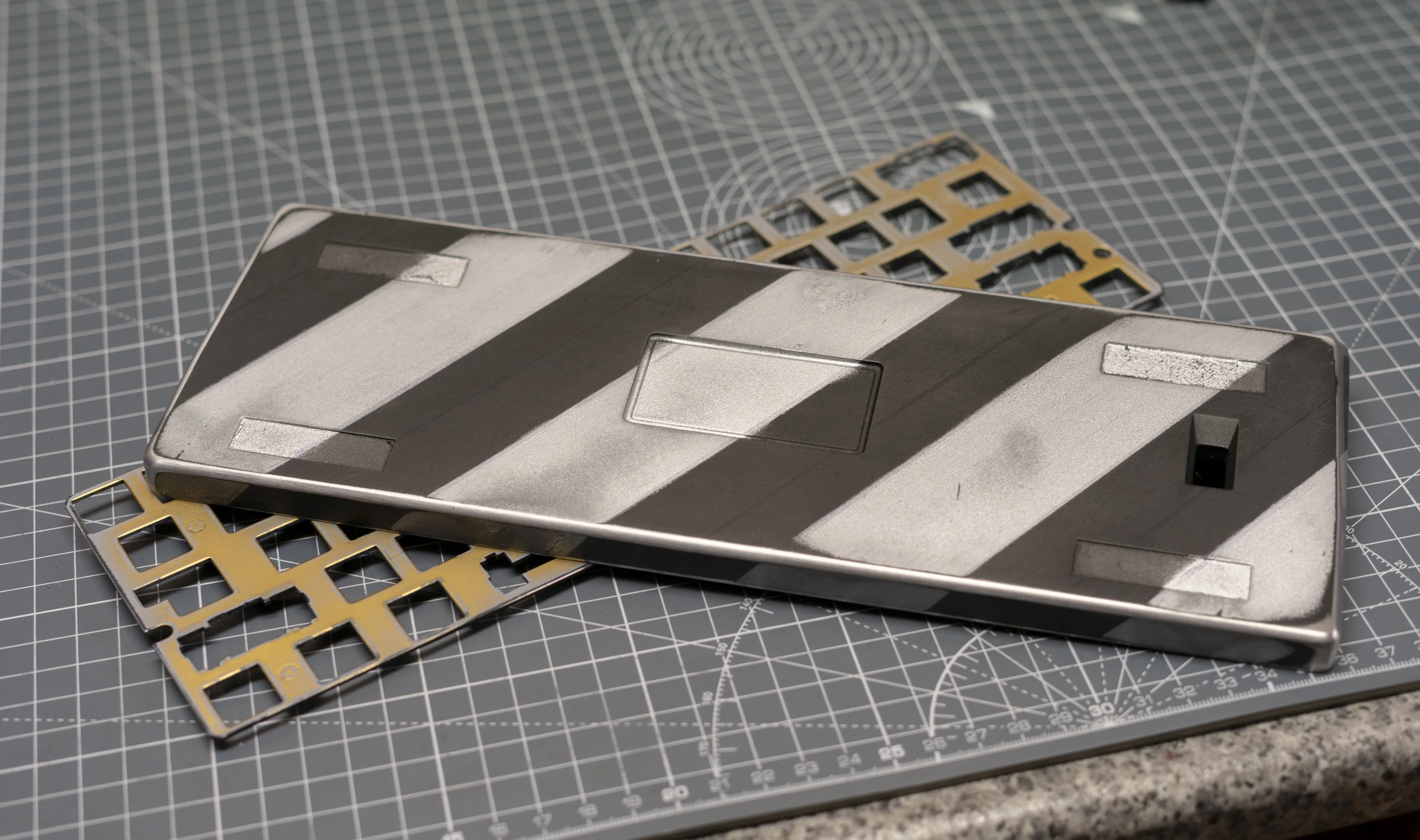

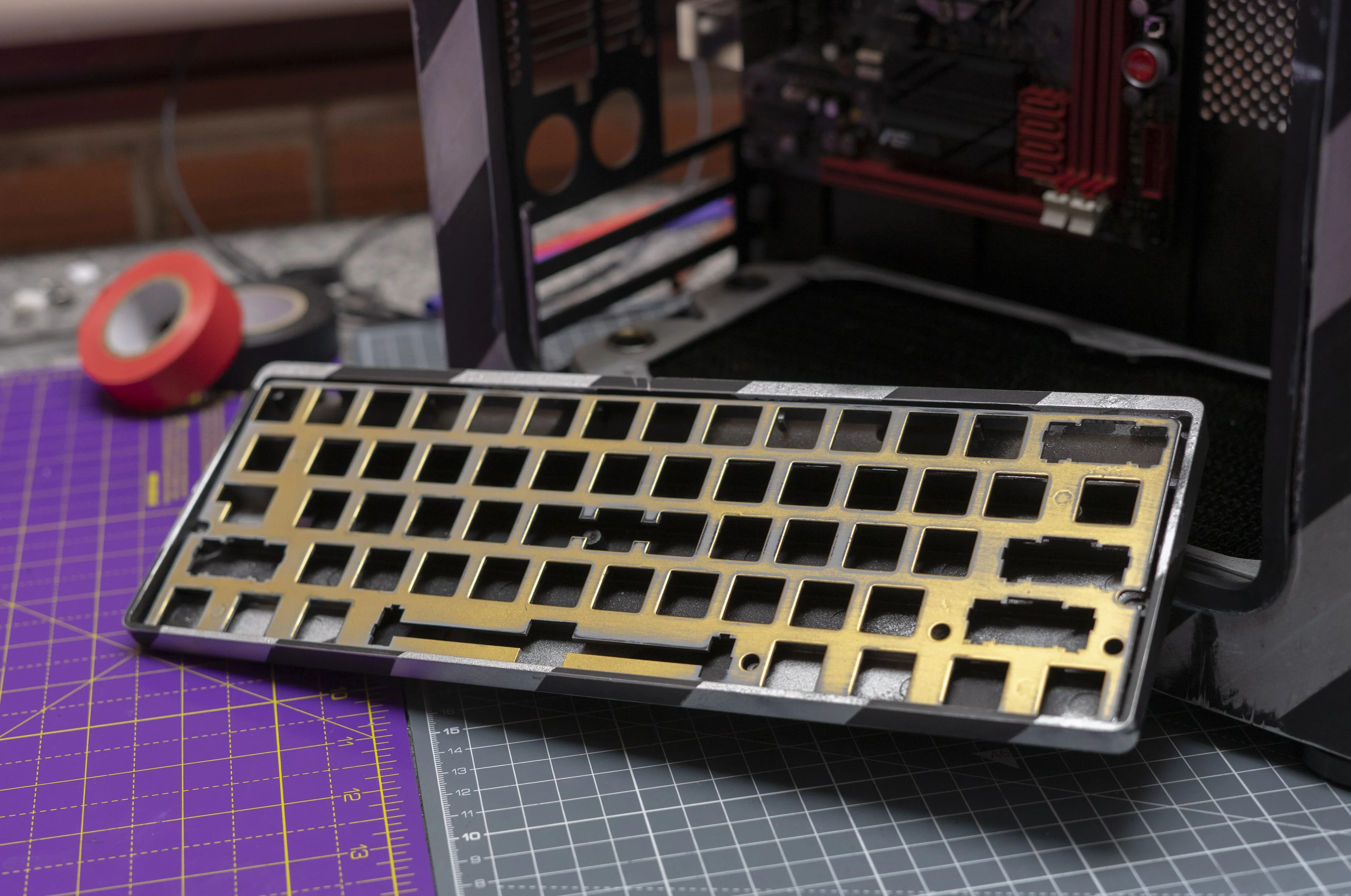

I managed to dig out a spare 60% aluminum keyboard case, so, matching Vault 76 keeb for this project too!

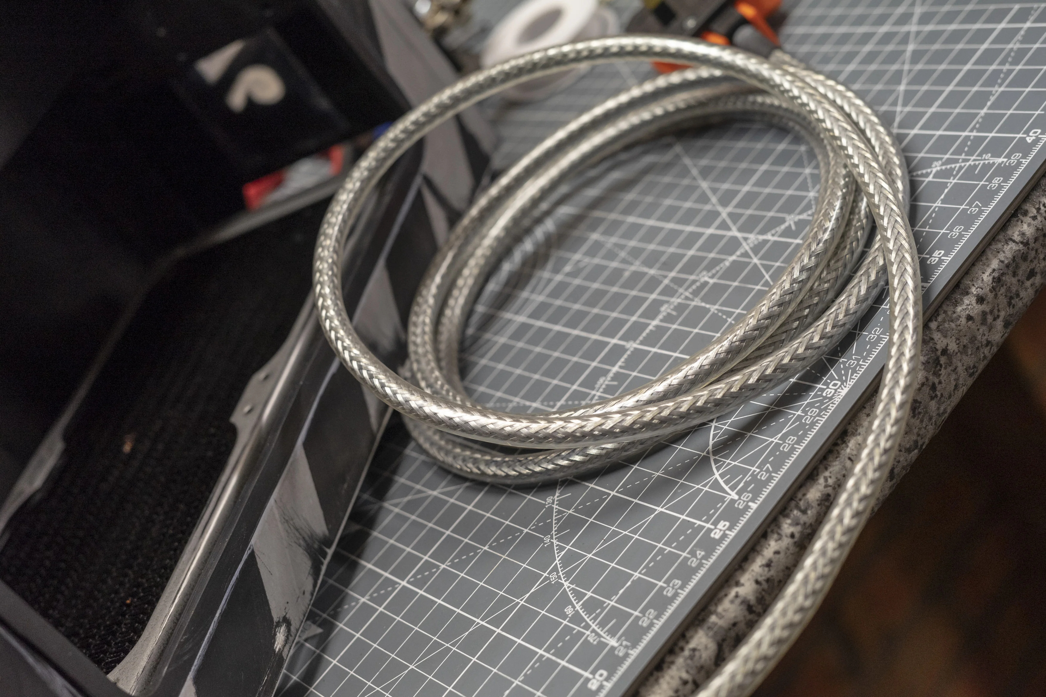

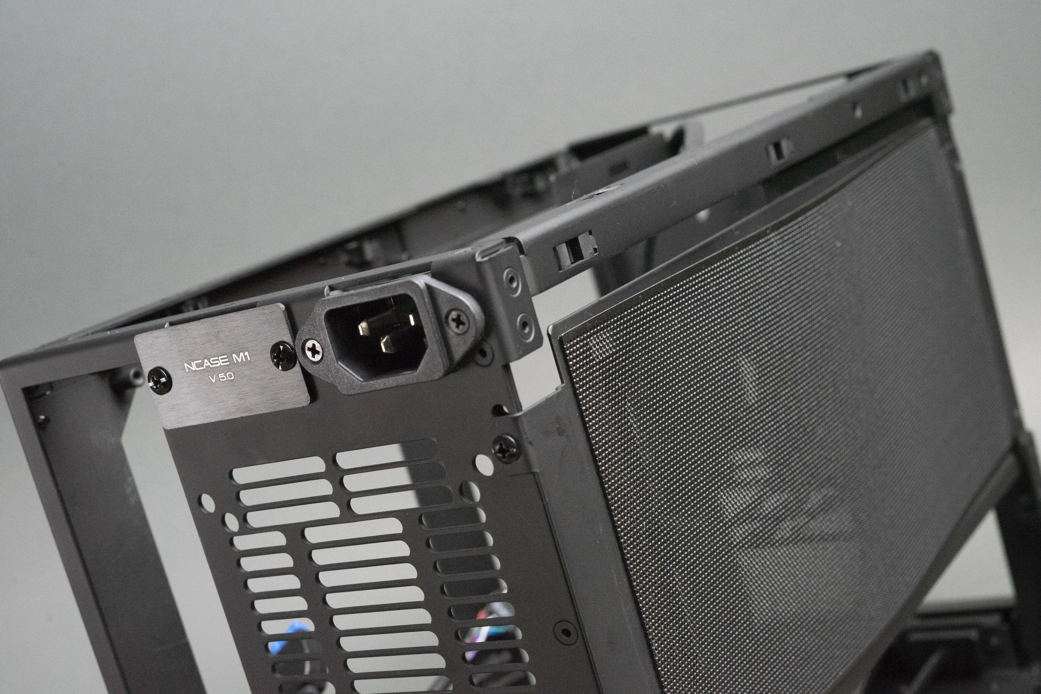

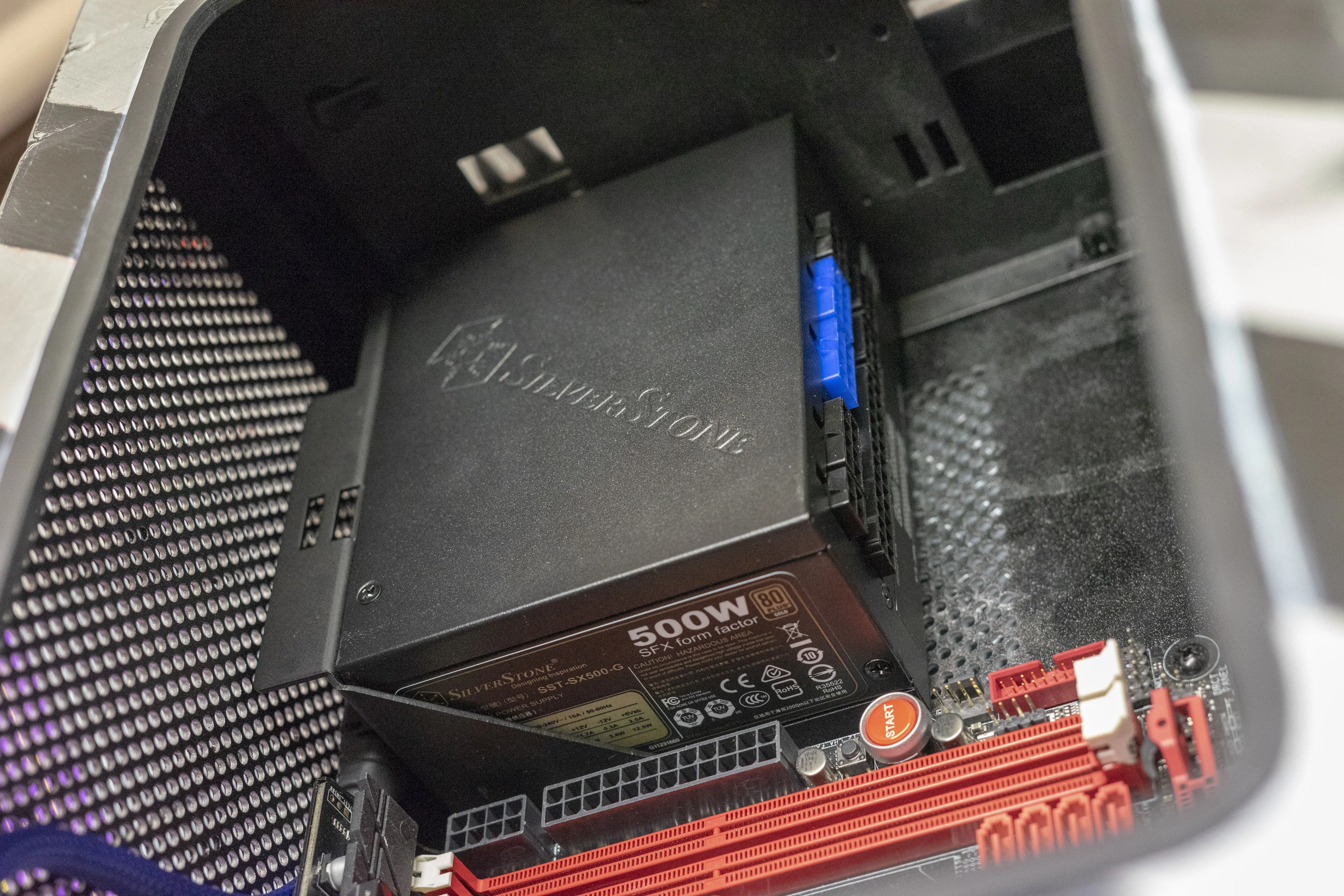

Whilst at Overclockers working on some cables for the epic 8 PACK Orion X-2, I picked up a new SFX PSU for the build, the sweet little Silverstone 500W.

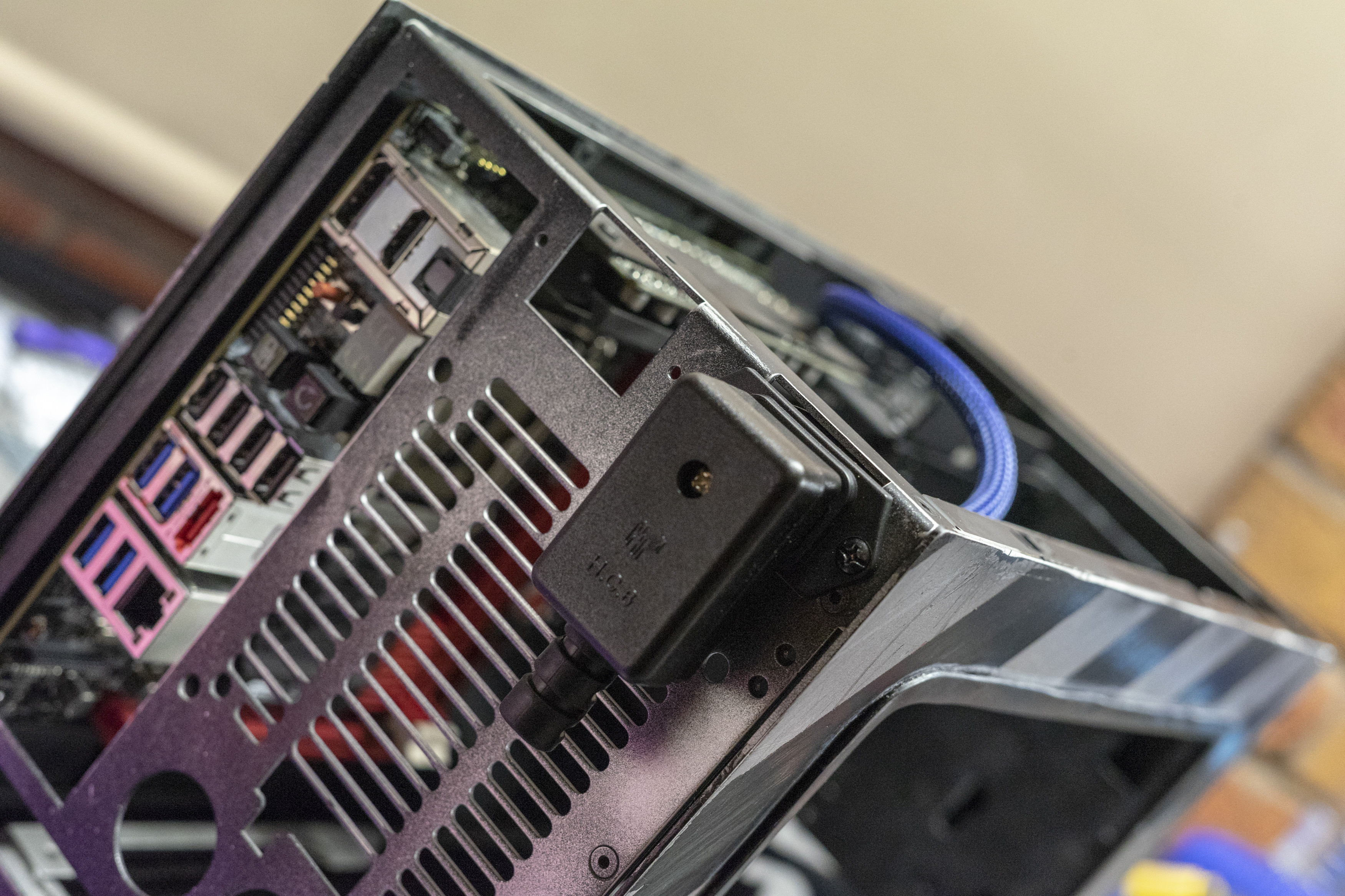

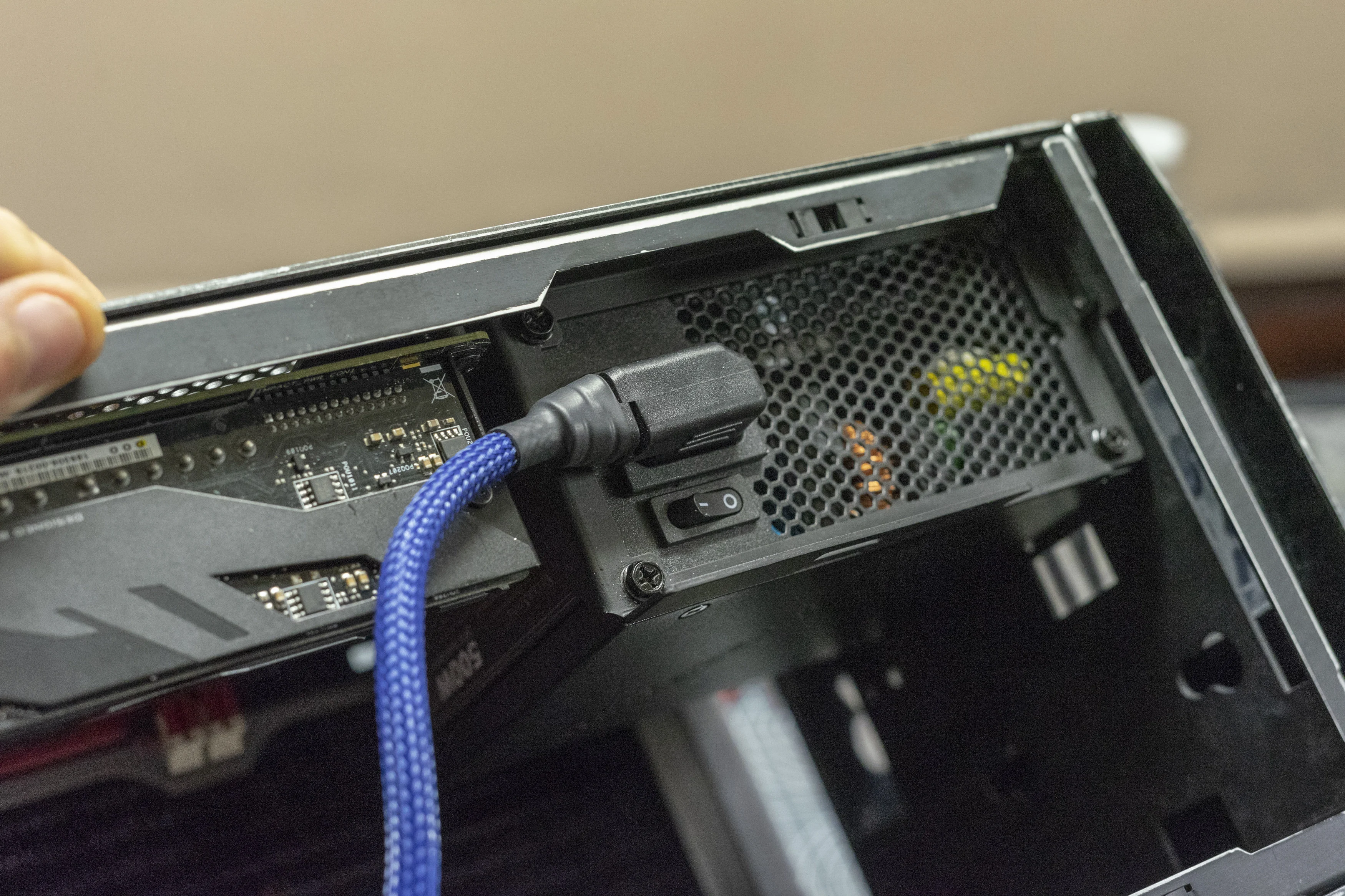

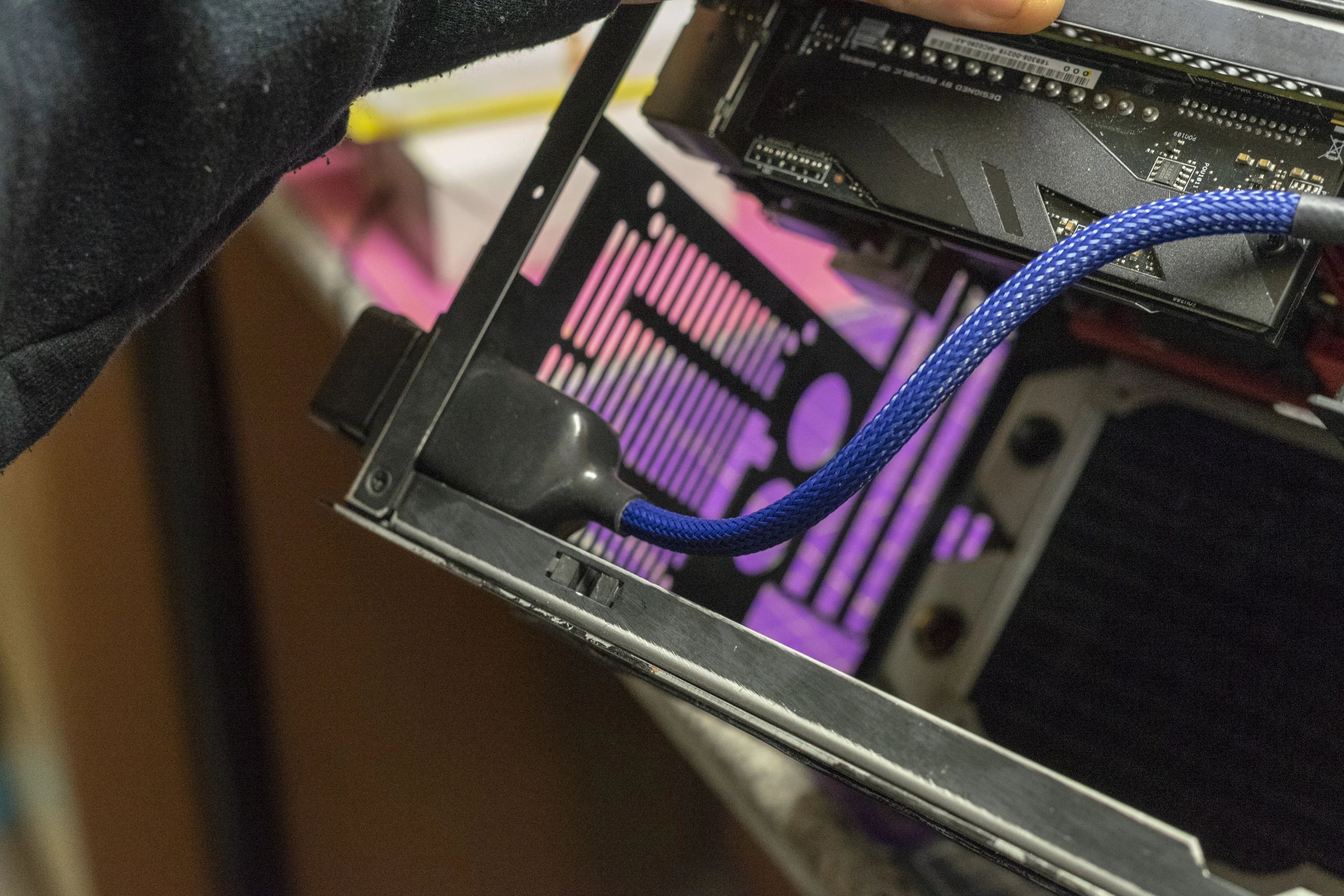

I also knocked up a little IEC cable to connect the PSU to the rear of the case, using a new C14 connector

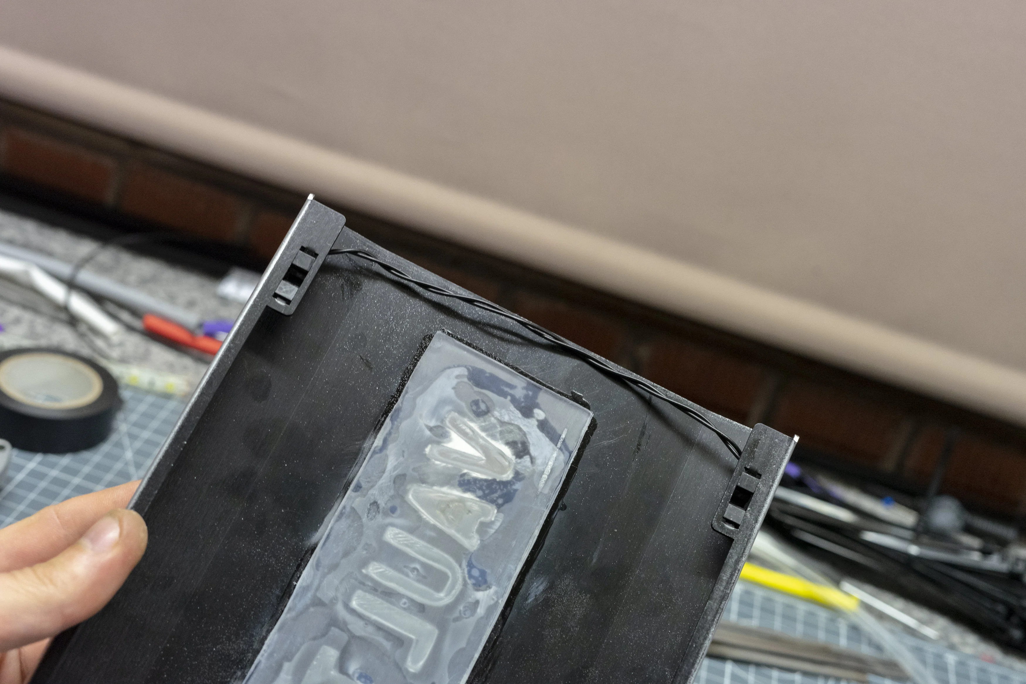

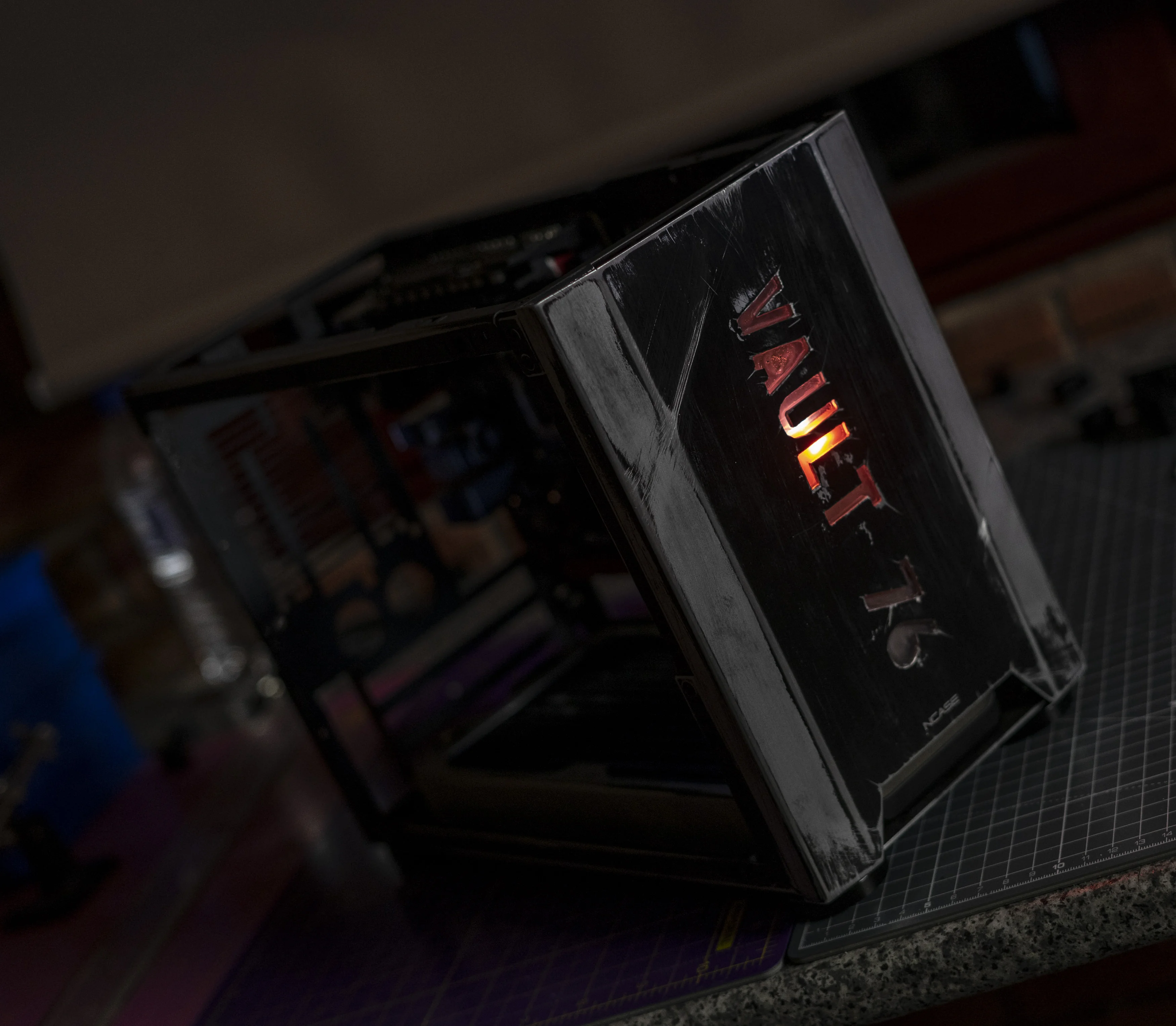

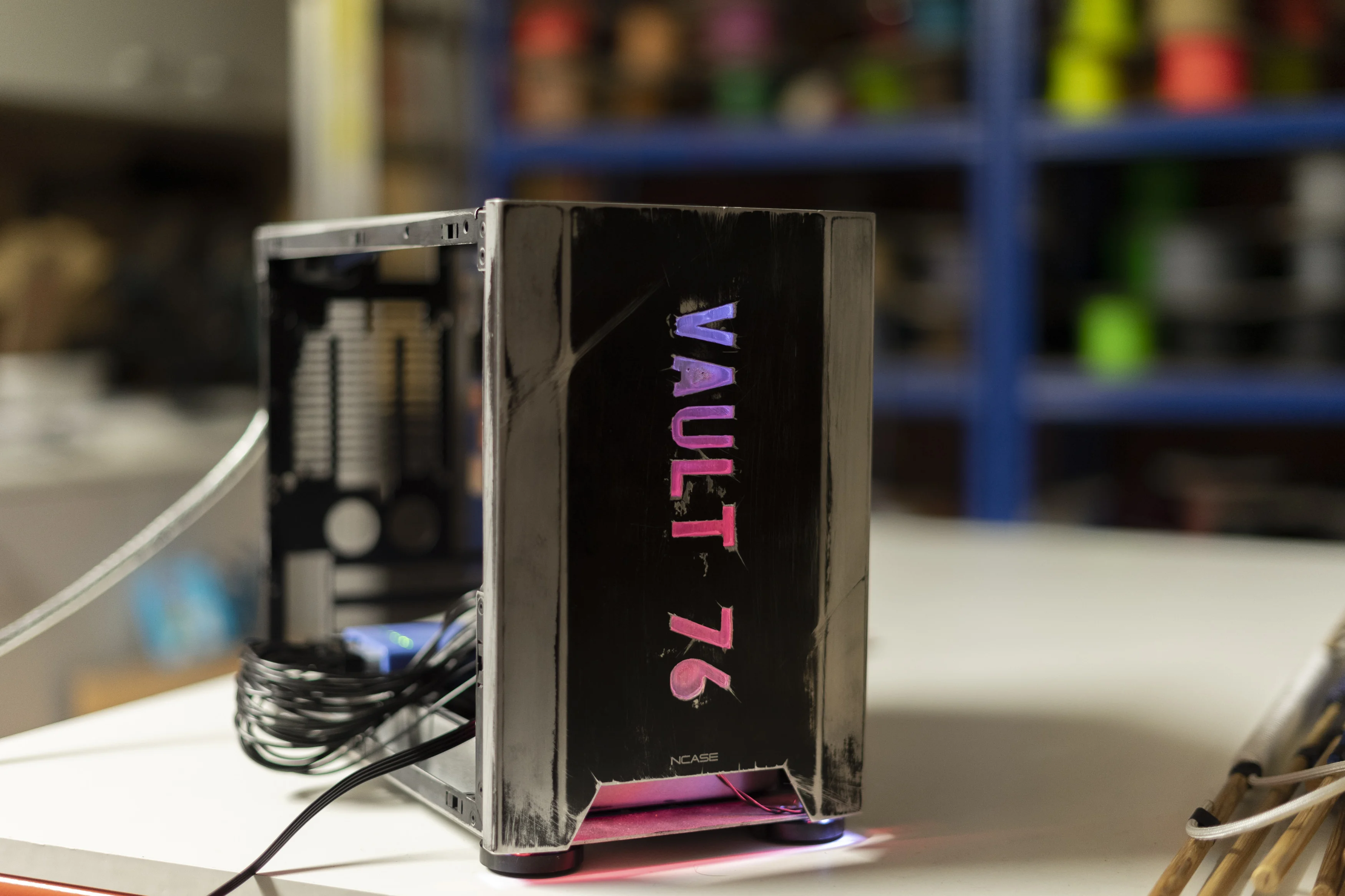

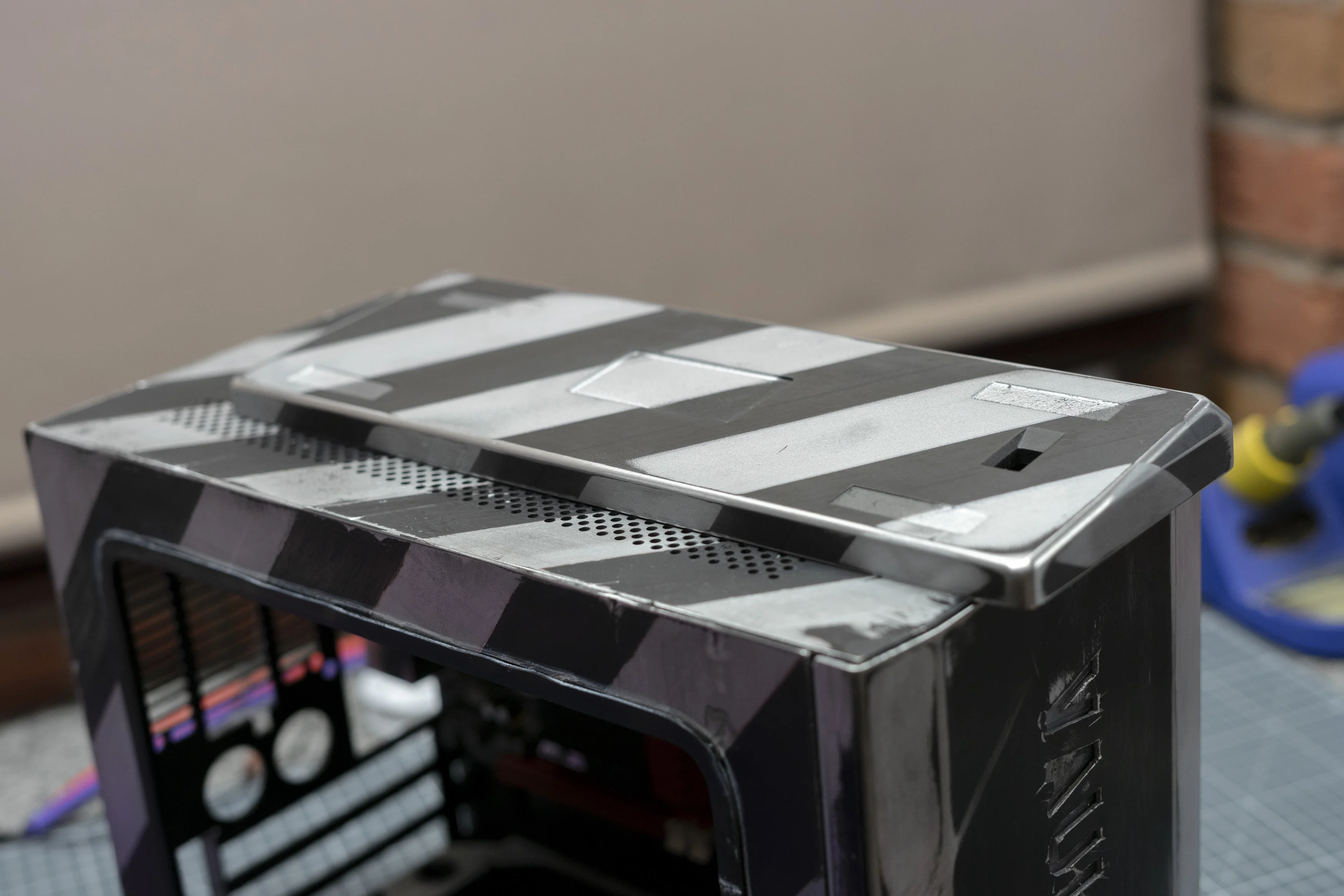

New window time. The superglue and the edge panel trimming has come out sweet. Forcing the glue to dry with a quick hit of Isopropyl caused some sweet off white patina.

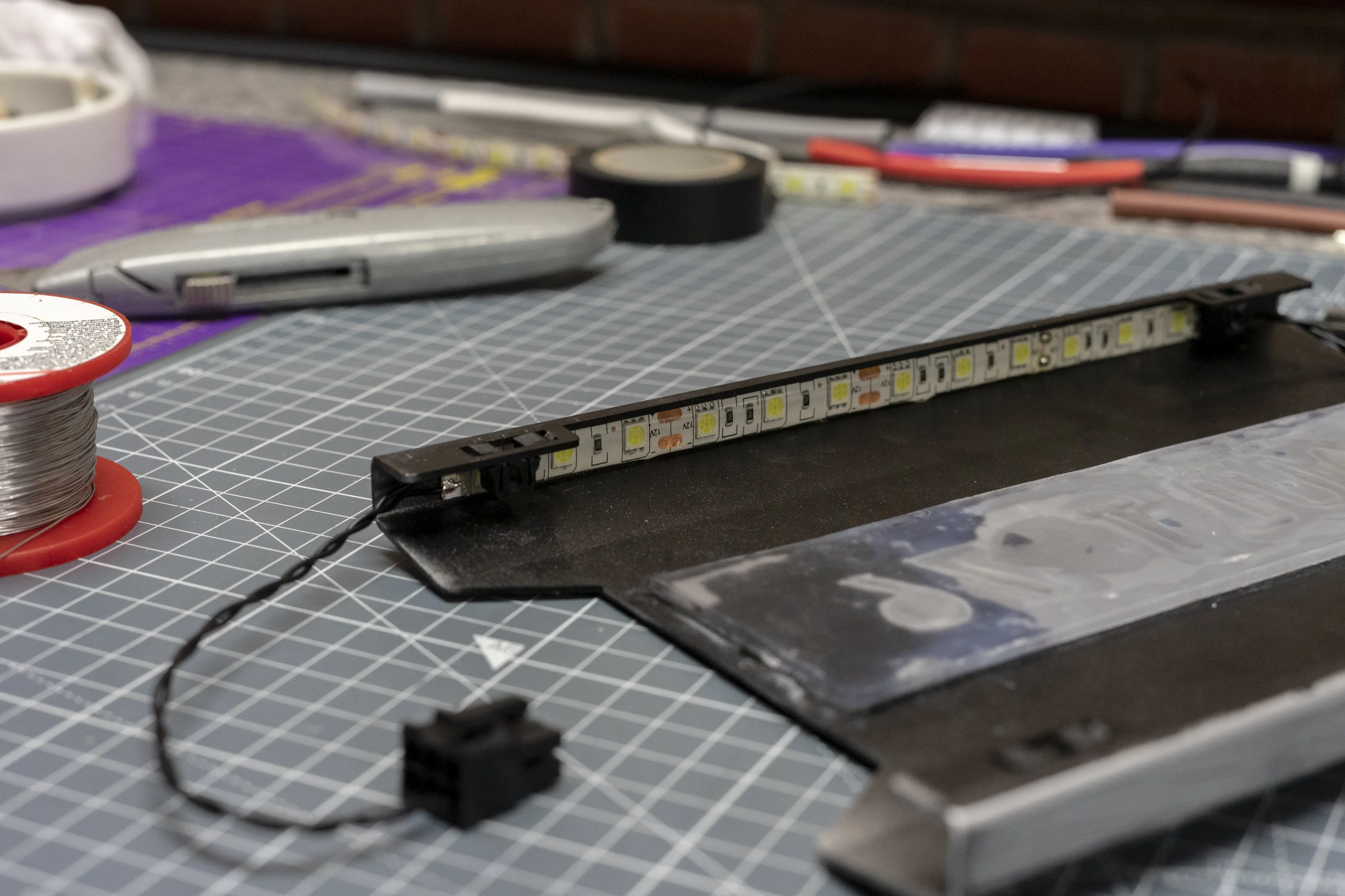

With the front panel, I thought it would be sweet to light the sides to allow the light to bleed through, not so intensely, so I made up a quick little LED strip set up
Raw cool white
Black electrical tape on top 1/3rd and red electrical tape on bottom 2/3rds of the cool white LED strips. Quite like this.... Its red, blue, purple, could work well.... Now... How the HELL do I make them flicker
