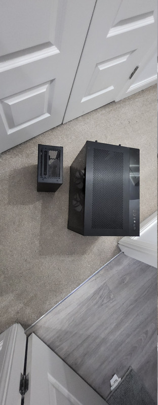

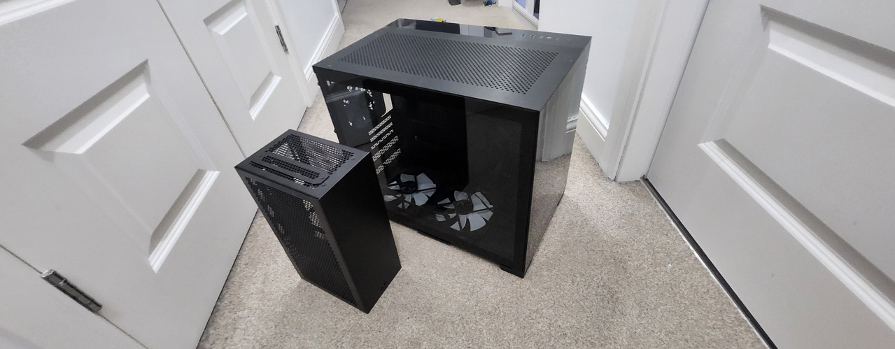

But going from a 42 litre lian li o11 mini to the 6.2 litre velka 7 (most of it vertical) is the main reason iv gone this way in order to save space.

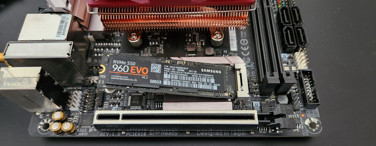

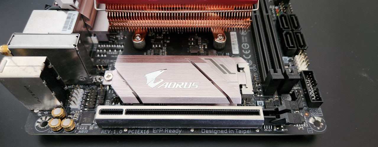

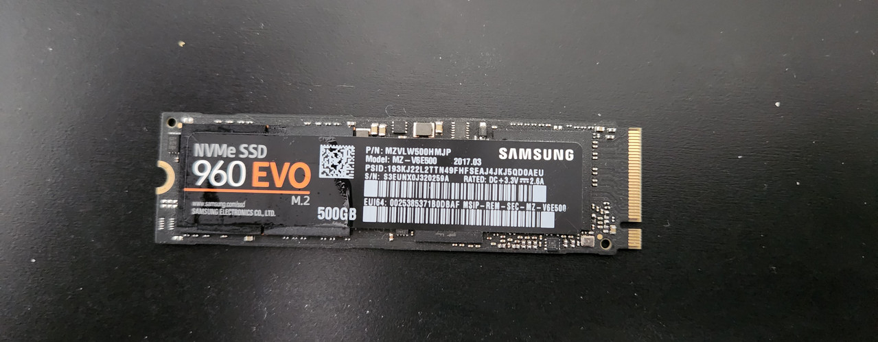

Would like to have a different drive but with costs and how many games will be on it, it wont be worth it.

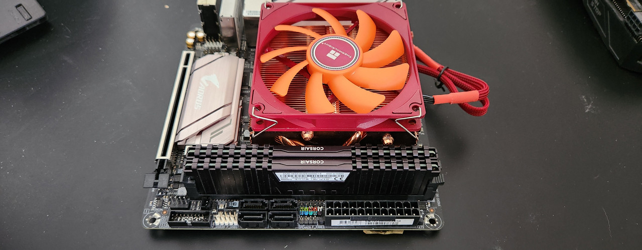

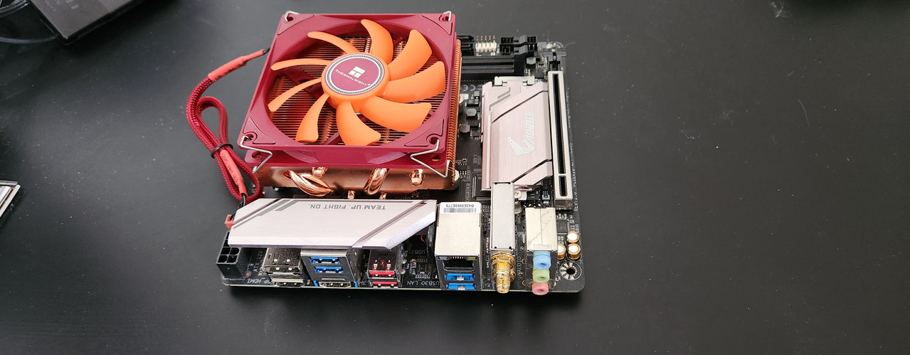

Cooler choice was the Thermalright TR-AXP90 X47. Why this one, as max cooler sapce is 48mm and the axp90 x47 is as by its name 47mm. Best cooler that you can fit into this case. Could buy a noctua for this to help with temps but not much of a difference to make it worth it for temps, will see how noise is with this stock fan first.

Dont think i need more then the 500gb currently as its for games like overcooked, gang beasts, etc. i do have a spare 1tb 980 evo which i used for the original build for extra game space but as it hasent got DRAM it might be a bit slower in the iops for an OS drive.

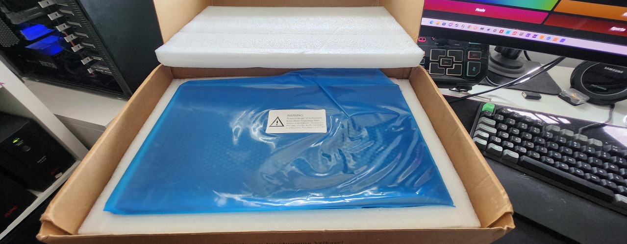

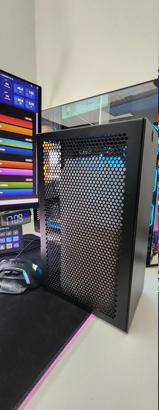

Will do a quick review of case when i can get the pics uploaded, not able to for some reason currently.

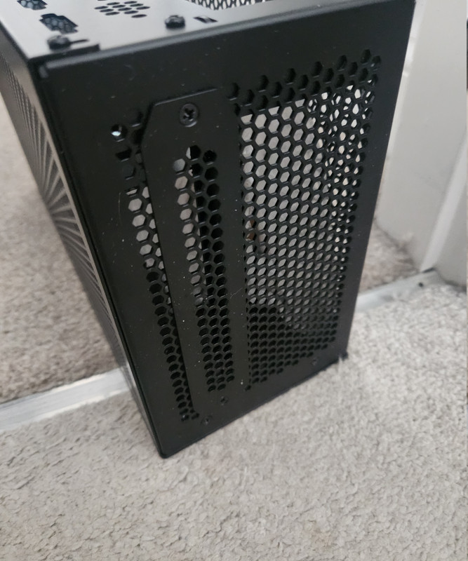

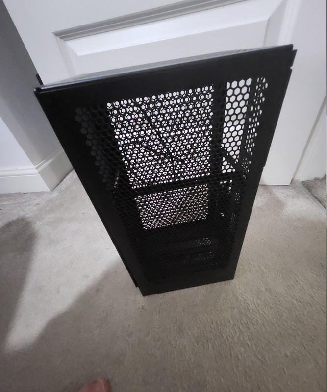

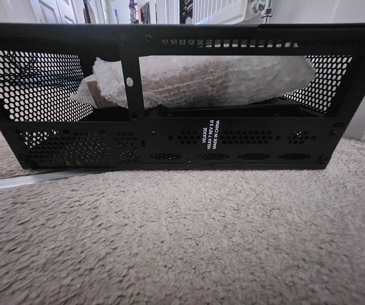

Case is made out of 1.2mm Steel frame, has a 2mm front plate and 1mm side plates added onto it making it a hefty case even though its small. Its open air hexagenal for airflow. has space for 2x40mm fans for cooling. It needs a pcie riser card for you to use a GPU with it.
This cover on the bottom on the case is if you dont want to use the GPU display adapters you can run your cables into the case so that you can connect to your GPU.
This picture shows the back of the case. The top left is for the PSU, Top right is for the MB IO, the 4 slots on the bottom right is for the internal GPU adapters to attach to so that you dont have to run sable out that slot on the top. And the bottom left of the pic is where you can see the 2 cut out for the 2 40mm fans you can add to it if you desire. (Heard mixed result on the effectivesness of the fans there)

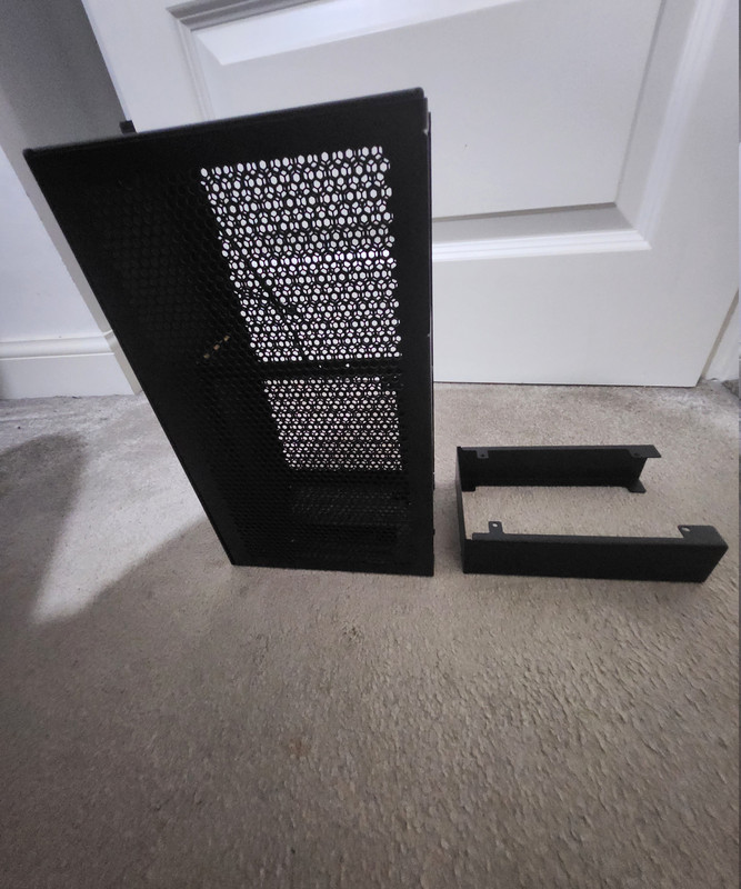

You get a stand that you can screw in to the bottom of the case so that if you use the slot on the bottom of the case it is able to route the cables out still. This takes the case size from 6.2 litres of space to 7 if you use it.
Pic to show the case stand off the case and where it screws in.

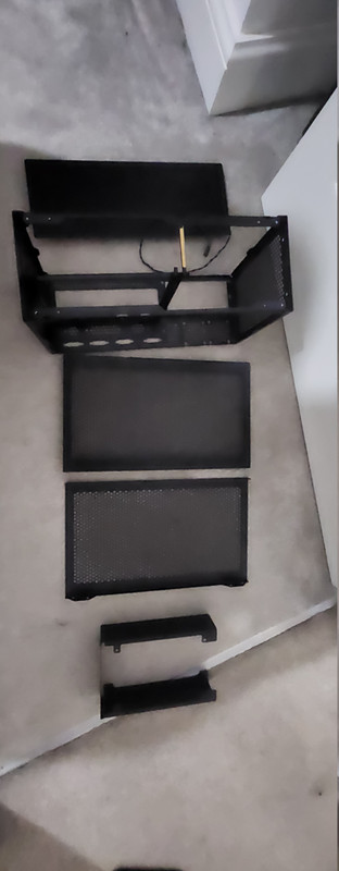

Pic to show the side and front panels are off. It took 18 screws of 3 differnet types to get to this stage. You need to disasemeble further to start to build in it.

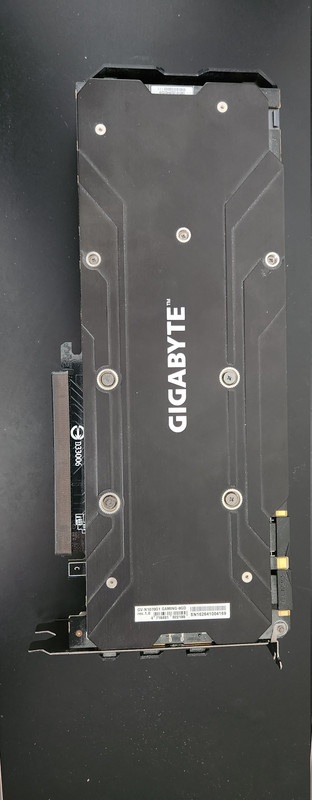

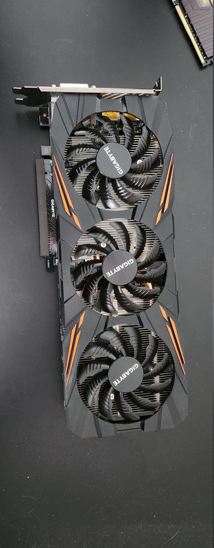

Done some building and will upload pictures later this week, had to go with just the HDMI cable for the build, i didint account to how much a DVI port sticks out the graphics card, it blocks me from using the DP port adapter. As i went with the cheaper pcie3 flex adapter i cant do much movement in offsetting that the case can do. Just shows how little space is in the case and how tight tolerances are.
