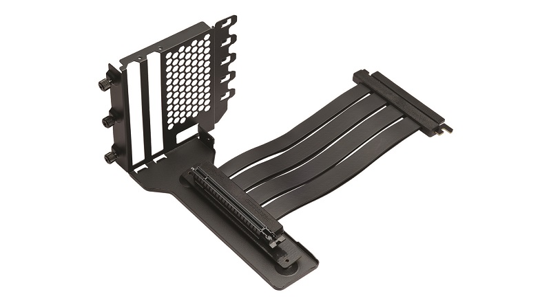

Would the rx 7800xt work with this gpu mount? It just says x16, and no Type of pcie as in 4.0, but the 7800xt is apparently pcie 4.0 x16.

You need to remove the competitors link and use this one here https://www.overclockers.co.uk/phan...0mm-pci-e-x-16-riser-cable-kit-cm-02u-pt.html
It is also cheaper at OCUK and just a word of advice that company is a joke and you should avoid.
If the mount fits your case the riser will work on a 7800xt at PCIE 3.0. So you may need a new riser cable with pcie 4.0 support or a different kit or just set the BIOS to use PCIE 3.0 on the GPU slot, it won't make a huge difference if any with a 7800XT set a PCIE 3.0 X16.
Technical details:
- Material: steel (powder coated)
- Color: Black
- Cable length: 220 mm
Connections:
- Plug: PCIe with 16 lanes
- Socket: PCIe with 16 lanes angled 90 °
- Supported PCI Express standards: 1.x, 2.x, 3.0
- Maximum height: 2-slot

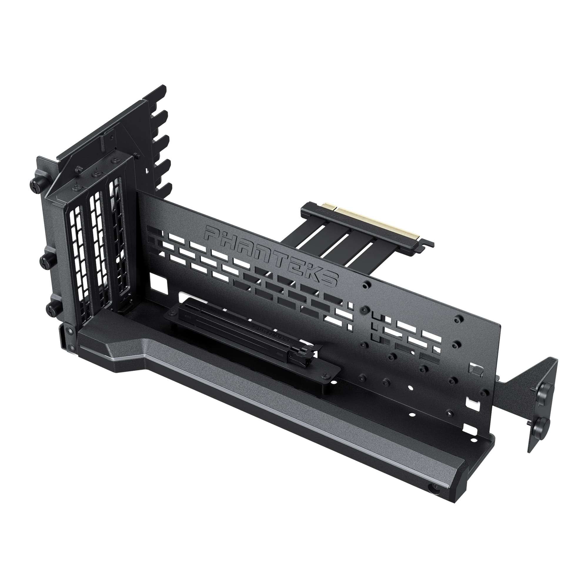

These will do PCIE 4.0 X16
Material​
Powder coated steel​
Compatibility​
Chassis with open PCI slot design​
Application​
Vertical GPU placement, tilt possible between 0-30 degrees​
PCI-e generation​
PCIe 4.0​
PCI Slot Required​
7​
GPU Thickness Support​
unrestricted​
GPU Length Support​
365mm​
Integrated Lighting​
D-RGB LED strip, 15 LED chips​
LED Strip Power Draw​
0.20A​
