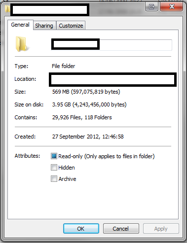

I ended up with this as the properties
This is a bit odd to start with, as it was only about 8GB of files to start with.
It starts to become weirder once you delve into files. The main folder's properties is as follows (should be about 8GB):
Within the folders themselves, it seems to set up some of the directory quite well, but not across the board.
