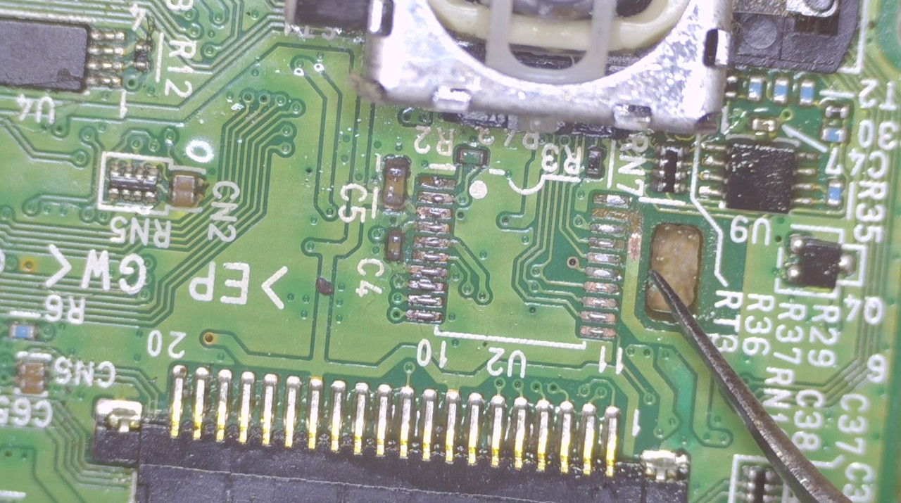

Do we think this might be the reason why?
ill keep looking its an NEC 871Y03

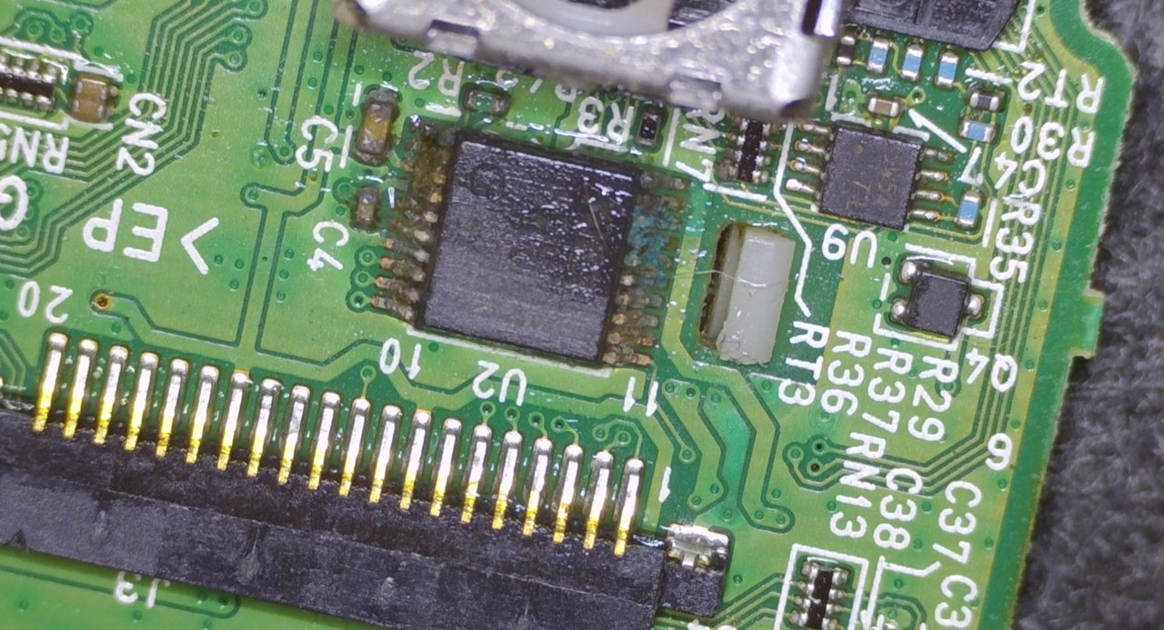

It's a baby chip and a common failure point on 0.47/0.48 amp draw at 15v (USB pd) power draw. The chip is responsible for checking and reporting on battery condition, charge level etc it works alongside the bq24193 BMIC to provide the charge boost circuit. Down side is no way to really test it so only way is whip it off and see. Sometimes you will see vdroop on the vbat rail which should push out 4.25v but commonly will drop to like 3.8v ish on max17050 failure. This one didn't do that, the rails looked solid, the only give away was rcm (recovery mode) behaviour. That basically pointed me at the circuit.

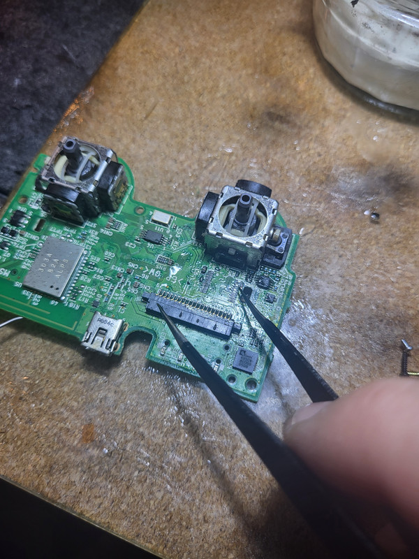

I now have several early ps3 machines, pads, games... paid basically nothing, first thing I think I will do is fully refurbish the pads, new pots, damn good clean and I recon the pads alone pay for what I paid for it all. Two nice condition original ps3 pads... dont mind if I do... don't mind at all.

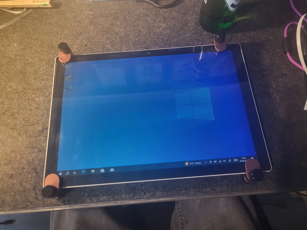

Today though I rebuild a surface!!
