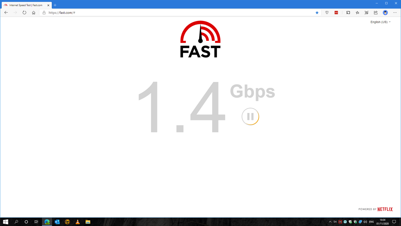

I hit 1.4Gb/s once but I assume it was glitch
Well before adjusting settings (after you do initial run you can toggle these) I got nowhere near my speed on any Tier so I also did not rate Fast.com but now its usually just about 1.0-1.2Gb/s each run if my end is 100%.
It cannot be any worse than the built in SamKnows POS when it even runs.
I normally use Speedtest.net Website and Win 10 App.

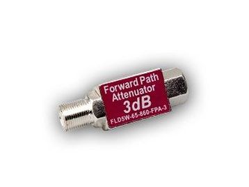

Might be worth just getting a -3dbi attenuator from ebay or somewhere in that case, can pick them up for a few quid and it'll give you an answer right away if thats the issue.

A what from ebay?
Forward path attenuator. It will reduce the power level depending on which one you get. Google 'virgin media attenuator'. The VM engineers will sometimes use them to tweak the power levels, it just screws onto the end of the coax before it connects to the modem/hub (or TV box is that is having the issue).
Ohhh, a 3dB attenuator. I thought you were talking about antennas for a moment.

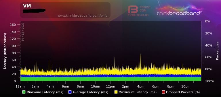

Here is my BQM
Speeds still slow on M600 between 4PM-Midnight (get about 200-300MB) but after midnight it's back up to a full 600MB+
Can anyone take a look at this and see what it suggests
Well, it shouldn't be dropping out twice a day like that (red parts). Your latency is spiking quite a lot but that will happen if you're heavily downloads/uploading, streaming, etc.
Here is mine (100MB service):
The first drop out was because of a power cut, so that's okay. Not sure about the 2nd drop out though
I did do some steam downloading yesterday so that could be showing in the BQM. VM have agreed to send an engineer out, I'm wondering if it's worth getting an AC86U
