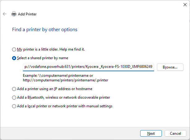

Have you tried adding it in Windows using that URL?
Also, just come off helpline with vodafone who think that the USB printer function is not supported on the router (even though it appears on the router settings as configured).
Does it give you a queue name? Maybe just rename it to "printer" and see if that makes the URL more sensible.
Thats not going to help for a 403 error. CUPS is running & the URL is right, it just needs the right username.
Try:
Code:
http://USER:PASSWORD@http://vodafone.powerhub:631/printers/Kyocera-FS-1030D_XMF6806149
Replace the username and password with the router login.
If there's a setting on the printer page to add a username + password, enable that and use those instead.
