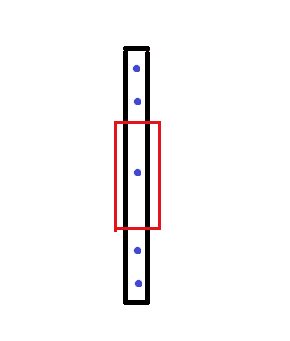

You could do this. I have had to do this on a few jobs where a good fixing was needed and it worked very well.
Where your fixings need to be cut a neat hole with a padsaw 100mm x 40mm.
Get a piece of laff 300mm long and screw a dry wall screw in to the center of it. Make sure its in well.
Slide the laff in to the hole and position it so it plumb and inline with where your fixings for the towel rail will be.
While you or someone is pulling the center screw to keep the laff tight against the back of the plaster screw 4 more drywall screws where the blue dots are on the drawing.
Unscrew the center screw and cut a piece of plaster board 100mm and 40mm and put in hole and screw in place.
Use some filler to go over the drywall screw heads and plaster the new bits of plasterboard.
You can use any size laff or timber you want. But it saves ripping the whole plasterboard off.
