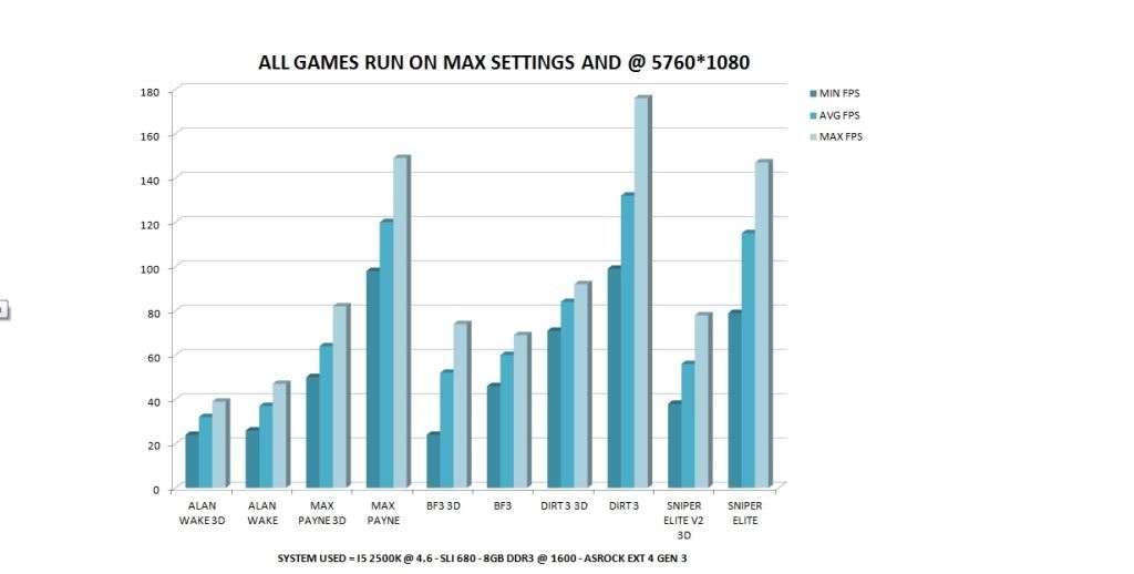

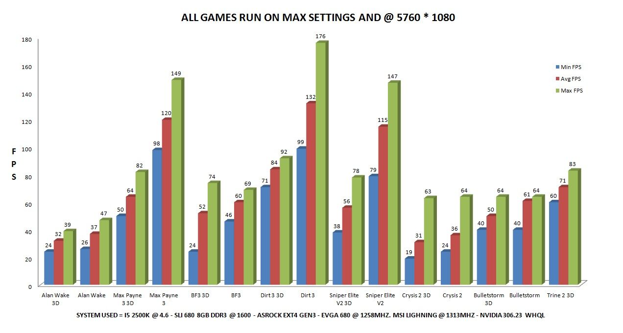

I have used triple 1080P 120Hz screens with no issues at all on nVidia 680's (2 of them) and Titans (2 of them).

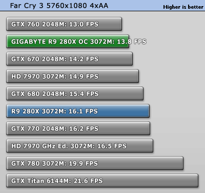

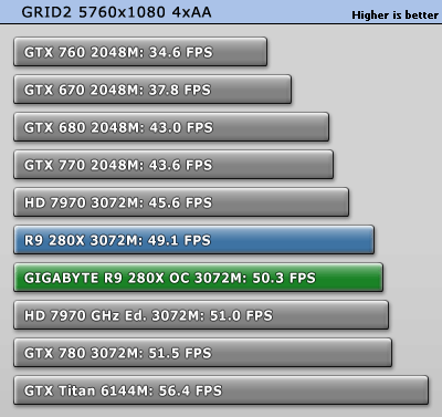

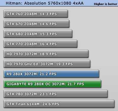

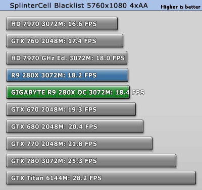

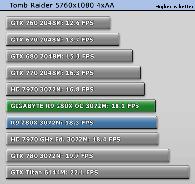

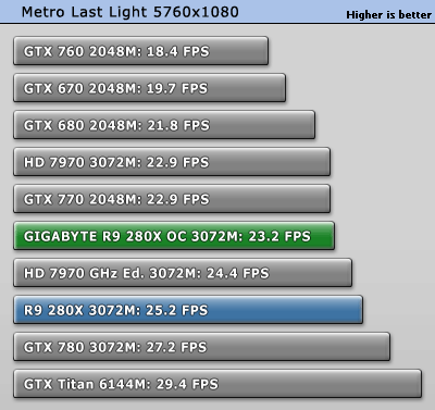

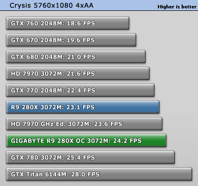

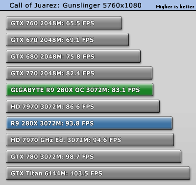

I will get some bench results for you to look at.

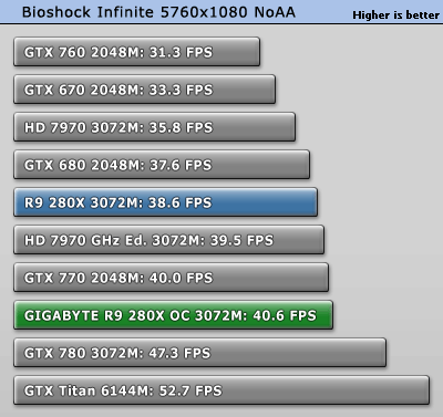

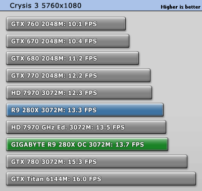

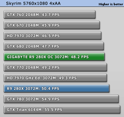

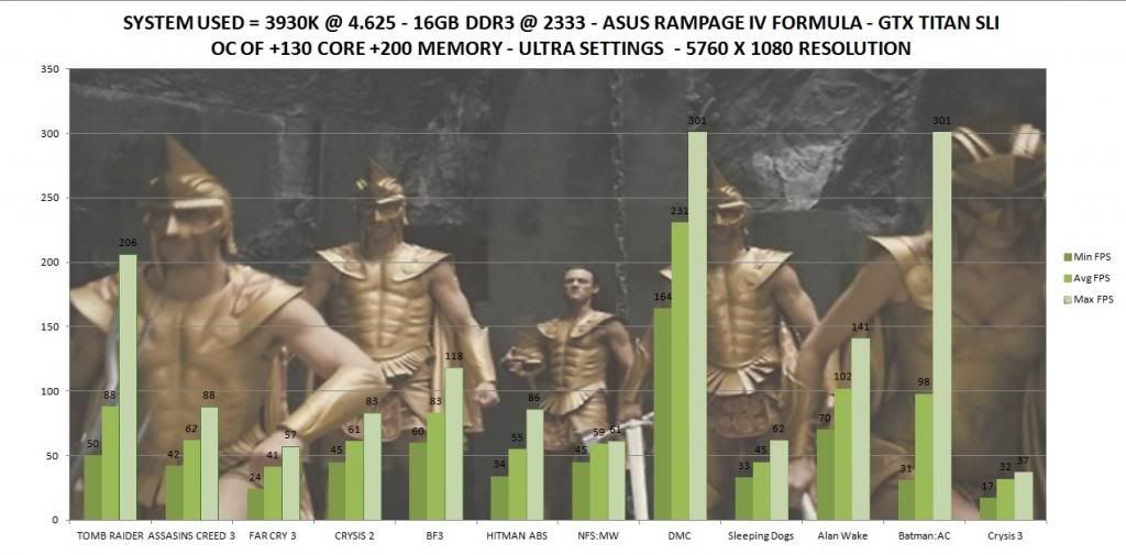

As you can see, you need a couple of cards as a minimum to get playable frames with decent settings.
wow thank you for the graphs greg :-)

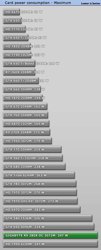

would my 550w PSU be able to handle the power demands of say a gtx 780?

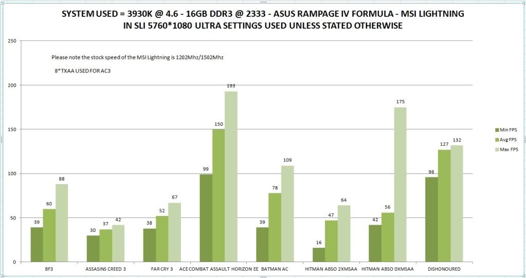

You do know that those graphs I did have either 2 680's or 2 Titans?
