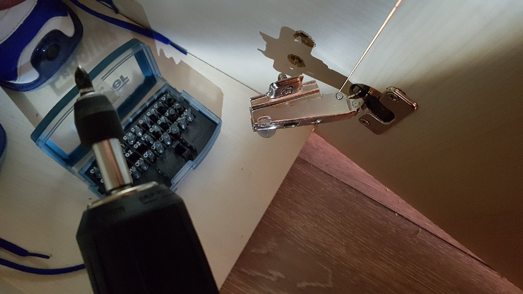

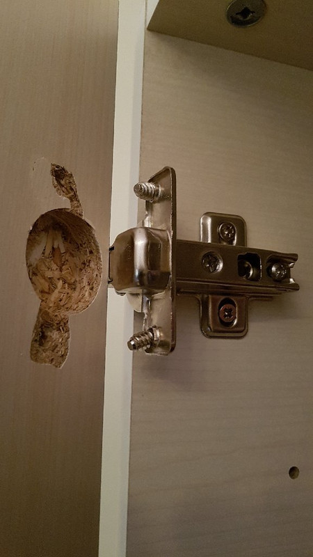

I've put a wardrobe together but two of the hinges won't stay fixed, they pop out. The 2 holes in the top of the left door and the two holes in the bottom right of the wardrobe (not door) have obviously lost their integrity. Is there a way to fix them?
Bottom right:
Top left:
Nut and bolt - or new doors.
I did google this--"how to fix hinges on wardrobe door that have pulled screws out" tooth picks are the thing.
Nut and bolt all the way through is going to be the only option really. You could use a countersunk screw on the outside to make it look less obvious
Hafele hinge repair plates
Screwfix sell them

Just noticed that the door part on yours is busted so this won't work
Thanks for the replies guys. How does thst hinge repair plate work?
What about if I were to push rawl plugs in and cut them flush and then used wood glue or epoxy glue to hold the rawl plugs, would that be strong enough?
I'd say you either fill the holes with some very thickly mixed saw dust and wood glue, or pack it with small bits of wood/toothpicks and super glue the screw in.
Plugging it won't work as the hole is too thin. Cutting the plug that short will have little effect, especially on something like a hinge that will be under regular load.
Hinge plate will work on the frame part if that is any help.glue and wood plug on door may work.possibly epoxy good the hinge on the door too

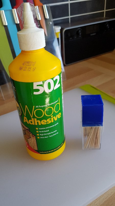

Thanks for all the replies. I think I'll try the easiest option, cocktail sticks and wood glue. I've watched a video. He puts glue on two sticks, pushes them into the screw holes and snaps off the excess sticks to make them flush. Let's it set hard and then screws into them.
I've got this 502 wood glue.
I've unscrewed the cap and it all looks fine and still very full of white glue, but the manufacture date is may 18 but it says shelf life 12 months from date of manufacture. Does that mean it won't stick and I need a new bottle?
So long as the glue is not like water or cheese its all good
But as we said epoxy the hinge into place is better
Try it with pva and wood sticks and see if it holds first if you like :)
