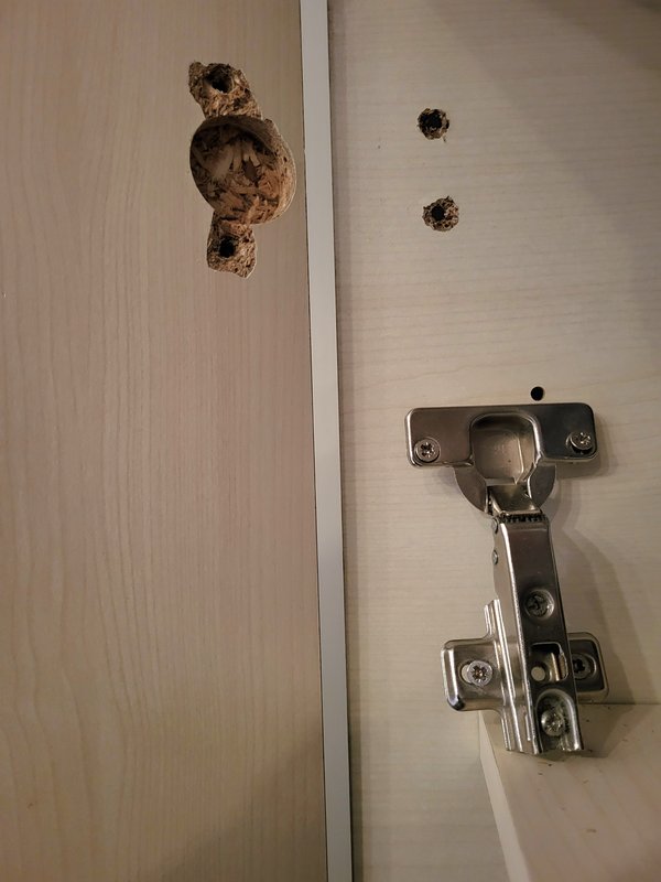

I'm not sure the best way to fix this wardrobe hinge but the holes are messed up and the screws just pop out. Is there some good filler I can put into the holes that sets and I could then use a braddle to make new holes for the screws? The bottom right hinge on the other door also needs fixing.

Thing is I can't actually put the screws in because if you look at the photos, the holes on the wardrobe bracket don't centre over the holes of the repair plates.

Not sure it matters that they are centred - you can at least see part of the screw hole, so assuming the screws supplied are self tapping - it should just cut a bigger hole?

Yeah I guess so, I'll give it a try. There's about half of the screw hole visible. I'd better get my electric screwdriver out because it's tricky to do it with a normal screwdriver.

Yeah just wind them in with a duggdugga impact driver. The only hole that matters is the big recess hole.
I’d just put a bit of stixall in there and the holes, reuse the same fixing holes. Ones that stuff cures it’s jobs a good one. Never moving.
That sounds good. Never heard of Stixall. I just shoot it into the fixing holes and can just screw the bracket into the cured stixall?

That’s it there but go to a local wholesaler/plumbers place you’ll get it for under £5.
Squeeze it into the screw holes and into the hole for the hinge. Then plop the hinge into place, screw it in. Job done. It’ll go solid once cured. Don’t go mental with the stuff as you don’t want it to spew out.
The stuff is great. CT1 is another amazing one but it’s 2x the price for virtually an identical product.
