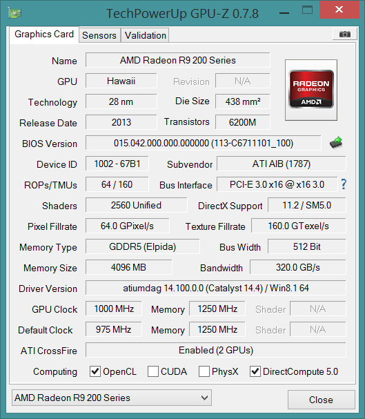

I run those odd clocks just to round off the Pixel Filtrate and Bandwidth, its a bit silly, but, you know.... :)
I have been playing Crysis 3 campaign with everything on Very High and 4x MSAA, i'm getting about <10% better performance over the factory overclock, which helps keep the FPS up. Crysis 3 is one of the few games that will push the card properly.
I like to do that. For some reason 1000/1250 just look like it is the perfect stock 290P clocks. They really should have clocked it like this.
Times the texture fill rate by 2 and you have the memory bandwidth. Pixel bandwidth doesn't really add up but still.
