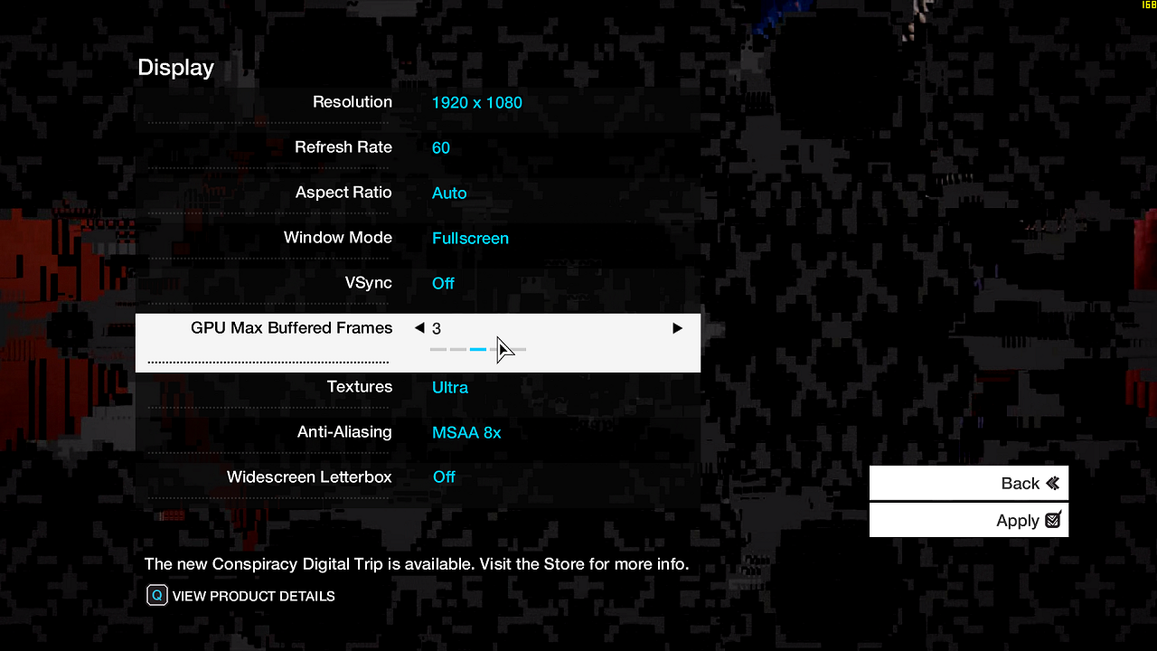

I have just tested SLI scaling @1080p on 1 and 4 Titans (can not do 2 or 3 without undoing a lot of bolts).
Titans were @stock
3930k @4.7
These are the settings used.
4 way fps screenshot
Single card screenshot
As you can see there is reasonably good scaling going from 1 to 4 cards.
The game was smooth on 4 cards and reasonable (considering the low fps) on a single.

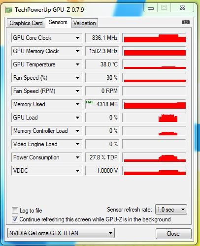

Now the real shocker, remember this is 1080p.
VRAM usage with 4 cards.
VRAM usage with a single card.
I think the VRAM usage in this game is the real reason why it is a stuttering mess and is hard to get running on GK104 cards.
