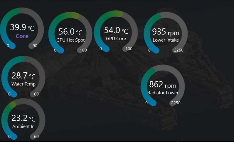

I have a 5" monitor in my case that I use as a sensor panel, I've been using AIDA64, but have changed to to AquaSuite. This is a quick grab of a WIP display
You don't have to use the supplied software to display the info, it will output temp probe info to other suites, like HWInfo, or Rainmeter that has recently been discussed in the Windows sub forum
