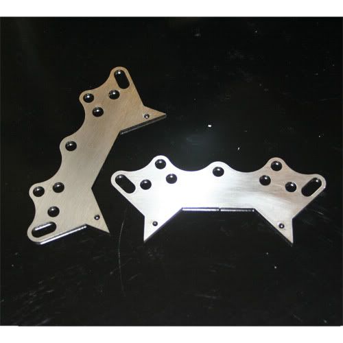

edit: can I use this?
Pulse Modding Heatkiller Universal Mounting Plates

I think the sandy bridge socket has the same dimentions as the Socket LGA1156 so you maybe should try to hunt down a standard 775 to LGA1156 conversion kit for your cpu block.
good to know Biffa
so you unscrew the allen key bolts on the bottom then it comes apart and you insert the new retaining plate which keys in with a few pins?
correct you do unscrew the allen bolts, the block base comes apart and there are 4 pins holding the mounting system in place, it's pretty simple.

They are held in loosely.
After removing base plate and internal spray plate (pins removed from top bracket)
After fitting new bracket but before refitting other bits.
Be careful you don't lose any orings and that you get them back in their seating grooves before tightening it all down.
argh well I put the conversion mounting plate on just fine but it collides with the VRM cooler heatsinks on my newly purchased P8P67 Deluxe from Asus:(
I've had to order a new heatkiller instead:(
