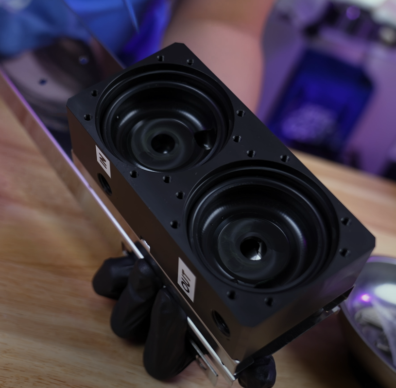

So this isn't my image but if I just place the supplied o-rings into the recess in red here:
and sit the d5s on top and place the steel plate on top of the metal bevel of the d5:
is raised like 2-3mm above the level so that the steel plate no longer sits flat like this:
Comparing the supplied o-rings with other ones I got with other tops they seem to be same size/thickness. When I don't use the o-rings the bevels on the d5s sit <0.5mm above level on the acetal part so the plate sits almost flat with a tiny gap. So I can't for life of me figure out how the o-rings are meant to be compressed that much that the person here is able to insert the o-rings and secure the plate back to level so there's no significant gap.

Yep the o-rings raise the pumps up so much that I have to apply some pressure just to get a first m4 bolt to begin threading and even then there would be a 2-3mm gap all around if I tried to screw in all the bolts. This video:
shows someone basically not using o-rings and this is how the d5s sit for me without them.
Turn on 8K and pause at 2:40 in that video above. He is using O-rings. Doesn't help they're both black making it difficult to see but absolutely do not run this without o-rings.

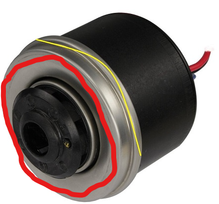

Have another go but I think the o-ring sits on the red part circled below. Can't remember as I installed it nearly a year ago.
I know it's different, nearly all my other D5 pump blocks in the past had it stretched out on the yellow line.
Yep, I definitely tried just "sitting" the o-ring on top that part of d5. I'm pretty sure when I did this I didn't have this much clearance when I place the o-rings on that tier of the spiral:

Thanks for all the input @momo56. I took it apart only to find - that o-rings ... were installed already.
I must have used other o-rings from my original d5s instead but because the spiral has a recess for the o-rings themselves I didn't notice they were there and was putting another set of o-rings on top. That'll teach me to turn on the lights in the future.
