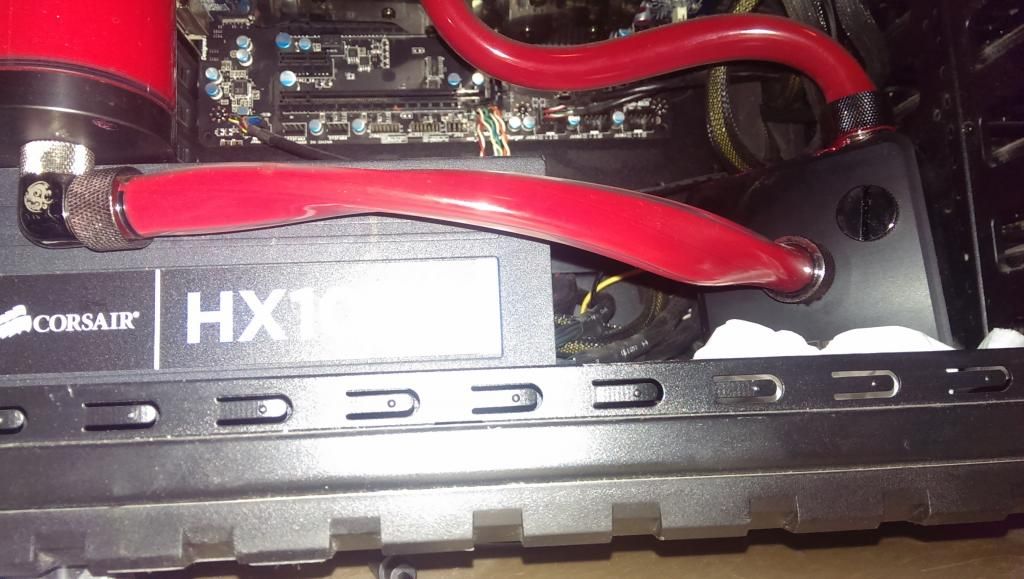

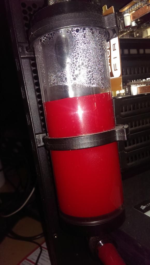

So. I just opened my rig for some general dusting and to top off the res as it's only been running about 2-3 weeks and the air from the radiators had finally worked itself out as it usually does once a loop settles, and something struck me as odd...
Hmmm... Couldn't have been THAT much air in the rads...
Holy mother of kinking, that's kinked....
Uhhh..... Uh oh?
Yup... Definitely an "Uh Oh" moment now..

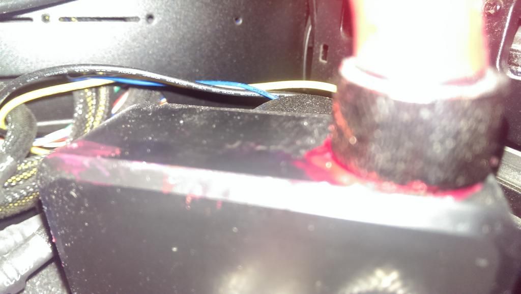

I have absolutely NO idea how that tubing has become so kinked on it's own. I've checked to make sure it hasn't been squashed by the fan on the side of the case and it's not. I'm pretty sure the fitting at the top of the top isn't screwed in properly but I also think the pump/top is leaking too.. What do you guys think?
Typical this happens when money is super tight at the moment. I'm just happy I've caught it this early.
Yeah, it's been running now for about a half hour and that top fitting is leaking pretty badly. Looks like it just needs tightening up though so at least I can get it fixed up quickly.
As you've lost water, you've effectively reduced the pressure on the pump inlet to below air pressure causing it to collapse.
Am I going to need to re-tube it or will it just sort of bounce back once i've drained the loop and tightened the fitting?
Depends on how long it's been like that, you might find that's now permanently weakened/deformed. As said above, unscrew the top of your res to let the pressure equalise again.

To me it looks like you had a twist in the pipe, maybe when it was fitted. When the pipe warmed up the twist pulled the sides of the pipe inward.
Tighten the fitting into the pump, slip the compression ring over the pipe, push the pipe onto the fitting. hold the pipe and tighten the compression ring without letting the pipe turn with it. You should only need to do the ring finger tight if the fittings/pipe are the correct size.
So all is fine now. The fitting at the top of the pump was screwed in all the way. Chalk this up to me being cocky and not double/triple checking everything before I fill the loop.
