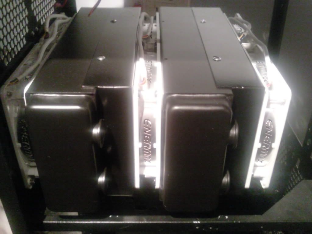

I wouldn't like to guess how a single 300mm fan would perform. For obvious reasons you'd need to seal the gaps between the radiators. I'm sure my 38mm thick 120mm fan blows more air than my desk fan, hard to guess which is louder. I would indeed suggest a layer of radiators either side of the fan. This isn't brilliant for performance, as one set of radiators gets feed warmer air from the first. However I believe it does make things quieter. Probably only useful when dealing with limited space though it does allow very effective ducting.
^feser 120mm either side of a 38mm san ace, 120mm fans with the hubs removed acting as shrouds either side.
[/QUOTE]
That's actually a rather good idea. I may consider doing something similar rather than cracking open the loft in a hunt for some meccano.
