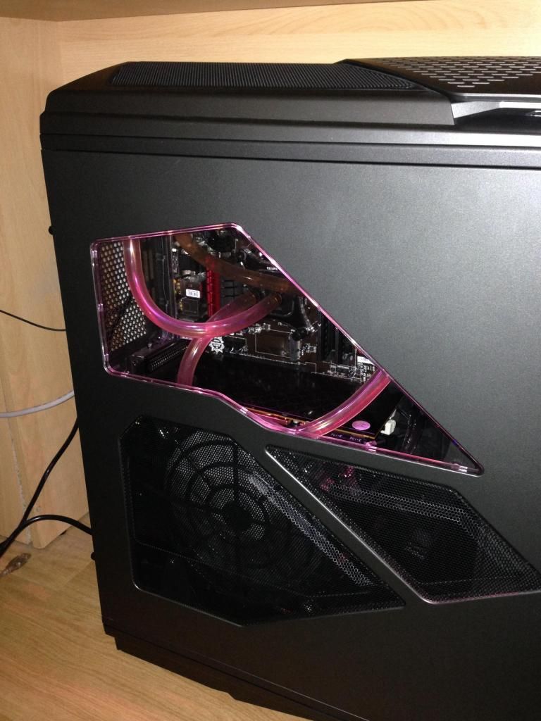

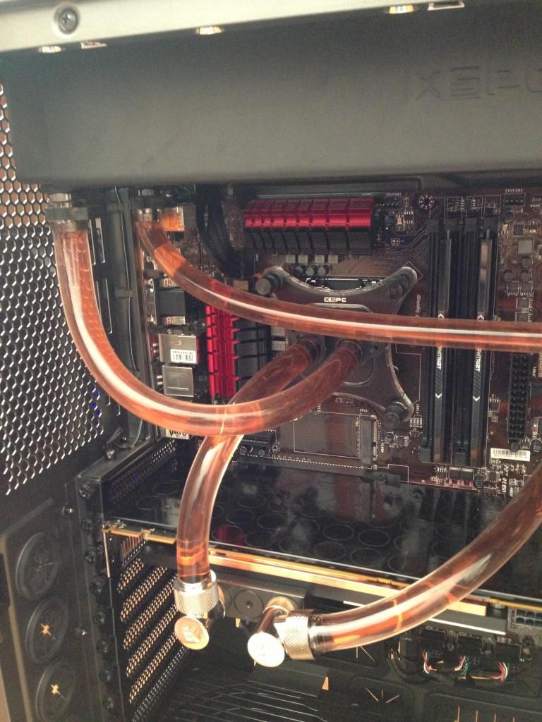

Finally finished ,taken a while....but here's few pic's ,.Not a massive watercooled build by any means, but I was just chuffed that it actually went into bios first time with no probs ,last pc I built was probably back in the days of the 1ghz axia cpu !
Build consisted on Z87-g45 mb , i7 4770 cpu ,8gb viper 2133 MHz ,7970 gpu ,xspc 360 x 60 rad kit with gpu put on the loop ..all wrapped up in nzxt phantom 820 case.
