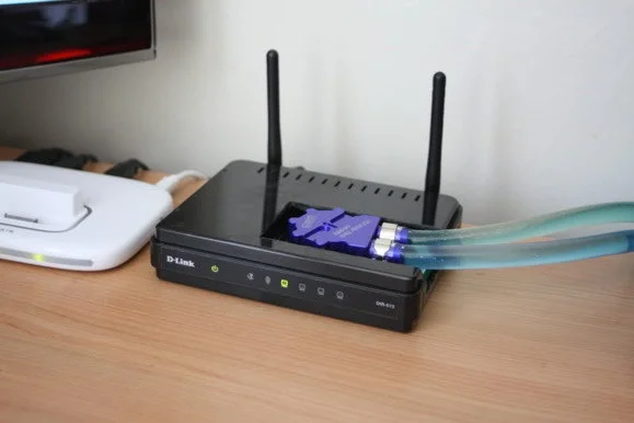

Probably the most pointless thing you could water cool
*ahem*
:P
Ah the start of WC when you could cool everything, why? why not? was the answer.
Saying that you can still buy coolers to fit to a SSD these days :eek:
