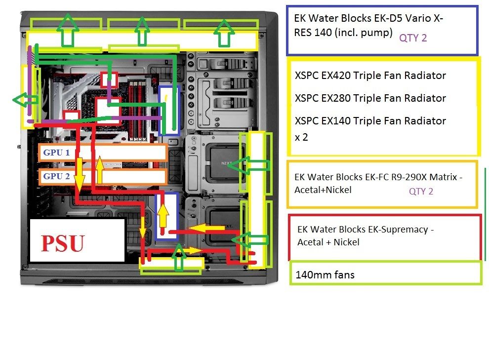

Hi All.
I will be doing a dual loop sometime this year.
Original Plan Was the following
Loop1(CPU) Res>CPU>MOBO>140mm>420MM
Loop2(GPU) Res>GPU1>GPU2>140mm>280MM
However after consideration i though i was boarderline on GPU loop and overkill on CPU. so here is my below revision
Loop1(CPU) Res>CPU>MOBO>420MM
Loop2(GPU) Res>GPU1>GPU2>140mm>140mm>280MM
This will be my first w/c build and i will be going all out, yes ambitious i know. Acrylic tubing for the win :)
Any suggestions/recommendations welcome
Ignore tte purple lines btw
Do it as a single loop with 2 pumps in series, you only need one res then and you dont have to worry about trying to balance heat load to different rads
It will massively simplify your tubing runs, and, if you ever have the misfortune of a pump failure, the one remaining pump will give enough flow to allow you to safely shut down the system without it over heating

I had considered this. However due to me upgrading GPUs on a semi regular basis having the dual loop makes swaping components out slightly easier.
Tubing will be complex but with Acrylic tubing im confident i can make it look sexy :)
I'm not sure that your GPU routing plans are gonna work too well. It looks like you're going for some kind of parallel thing involving the radiator.

good point, the return from the rad wants to go straight on to the next rad, the drawing makes it look like it goes back via the GPU blocks
