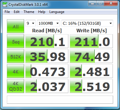

my exisiting raid0

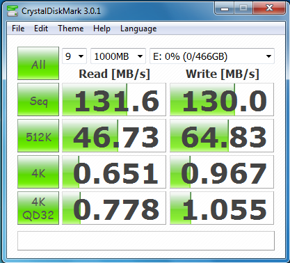

WD5000AAKX (SATAII port not SATAIII)
i have no idea whats good or bad with these tests, other than i assume the bigger the number the better? can someone please explain if the WD500GB would be better in the SATAIII socket or does the F3 win in single drive (and its not a lot less than the RAID0)
Plugging a mechanical HDD into a SATA 2 or SATA 3 port makes absolutely no difference as RJC explained above.
SATA 2 has a maximum transfer rate of 300MB/s and none of the drives you tested come anywhere close to this.
Plugging them into a SATA 3 port makes no difference as the disk is the limiting factor not the interface.

Yes, though as you can see there isn't a great deal of difference between the Samsung 1TB F3 and the WD5000AAKX.

just run the test on my Raid0 drive with my SB build and the results seem to of improved a lot. so will stick with it until i can afford an SSd
