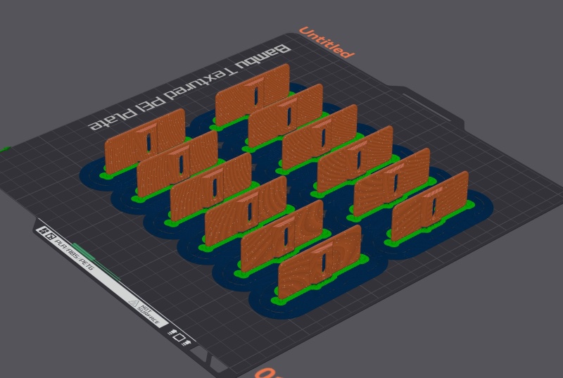

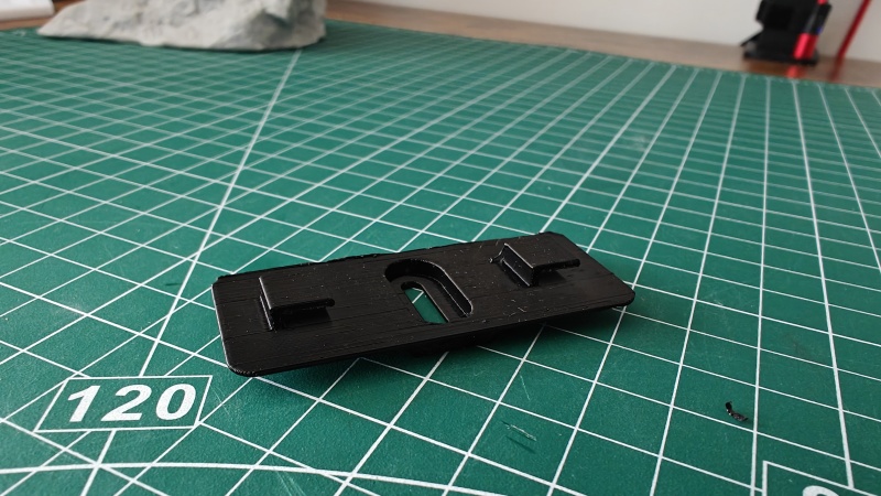

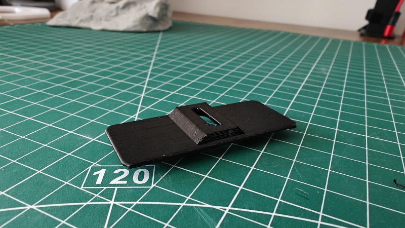

Don't know if you're still looking for these but I tested one and seems to print fine. I'm in Milton Keynes so if you're close by you could come and take a look and I could probably print more depending on how many you need
Can comfortably put 12 on a plate at a time which takes about 3.5 hours to print
The way it's printed would mean it's pretty strong as all the force would be following the print lines
