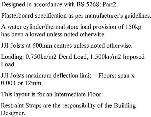

We are planning a home water birth and we want to have it on our first floor however I just want to be sure that the weight of the pool will be ok on the joists.
Its roughly 3 baths of water in weight (12 adults)
The house is brand new built 2014
Attached is a joist diagram however I am not able to understand it.
http://i.imgur.com/TSUklaK.png

Your projections estimate an adult weighing in at 46KG! You're looking at about 7 adults worth of weight, spread out pretty evenly, I wouldn't worry about that personally but I'm no structural engineer :p
We've used those I beams a lot, they aren't built for more than what they are intended for which is residential use, they won't slowly give way they will suddenly go. We have been asked before about fishtanks and the answer has always been a solid no.
The reason I ask about the ground floor is that you could back prop down and spread the load about a bit, couple of acro's and some ply however you really need to ask the manufacturer what load they have been designed for and calculate it from this or ask a structural engineer to give you a sketch.
It's good you have the drawing an engineer could probably whip something up quite quickly.

There's your loads, I'd say a pool of water is a dead load rather than a live load in which case you have 0.75kn/m2
By these calculations, your floor isn't fit to support two people stood within a metre of each other... although maybe "not designed" to do it, I bet you can stand next to someone for a long time in that room and not experience any falling-through-the-floor moments.
