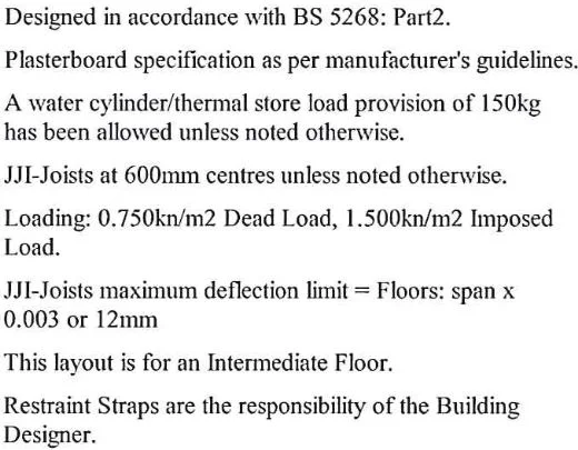

By these calculations, your floor isn't fit to support two people stood within a metre of each other... although maybe "not designed" to do it, I bet you can stand next to someone for a long time in that room and not experience any falling-through-the-floor moments.
That would be a live load which is double the dead load.

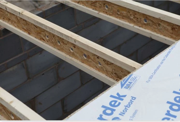

is that ^ really how they make floor joists now?
