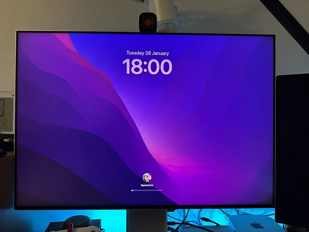

All of a sudden today the Mac Mini M4 won't boot if I have the Sabrent 10gbps enclosure with WD SN580 2TB attached.
The rear thunderbolt ports
1- Caldigit (Keyboard, webcam, Mic etc.)
2 - OWC External 2TB
3 - Sabrent 2TB
At first I thought the Caldigit was causing the mac to endlessly stuck in a boot loop. The computer would basically go into the login page, password entered then it reboots....After disconnecting the Caldigit and still doing it, I started to unplug everything but monitor and keyboard left and through the process of elimination when I have the Sabrent connected, either rear or front ports, the machine won't boot.
What could cause this? The drive only holds my Steam library. When I connect the Sabrent into the machine after it successfully logged in, it works fine.
When trying to run Blackmagic on the Sabrent, it crashes Blackmagic too.
Bah, it is the Sabrent
The Mac get stuck here, normally it breezes past it but it gets hold up here, and soon as I pull out the drive it works fine.
