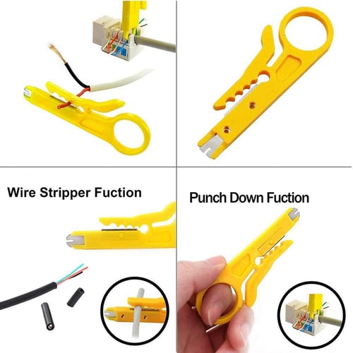

Or potentially give you the cable without ends on to make it easier to run. And then they can just crimp ends on it or put a socket on it for you. (It's easy to do, especially if you use keystone jacks. You can do it yourself with one of these cheap lil fellas, or with a pen knife worst case.)
I'm mentioning it, in case it makes it a lot easier to run. Especially if you're going through a wall, so you only have to drill the diameter of the cable, not of the much larger plug!
