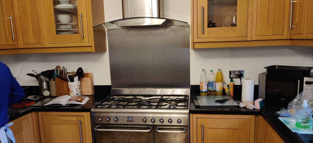

I can't stand not having a splashback. Had a SS one when we moved in but only an upstand like the above pic for the rest of the kitchen. I tiled the whole lot as I was fed up of splatter marks on the wall!
