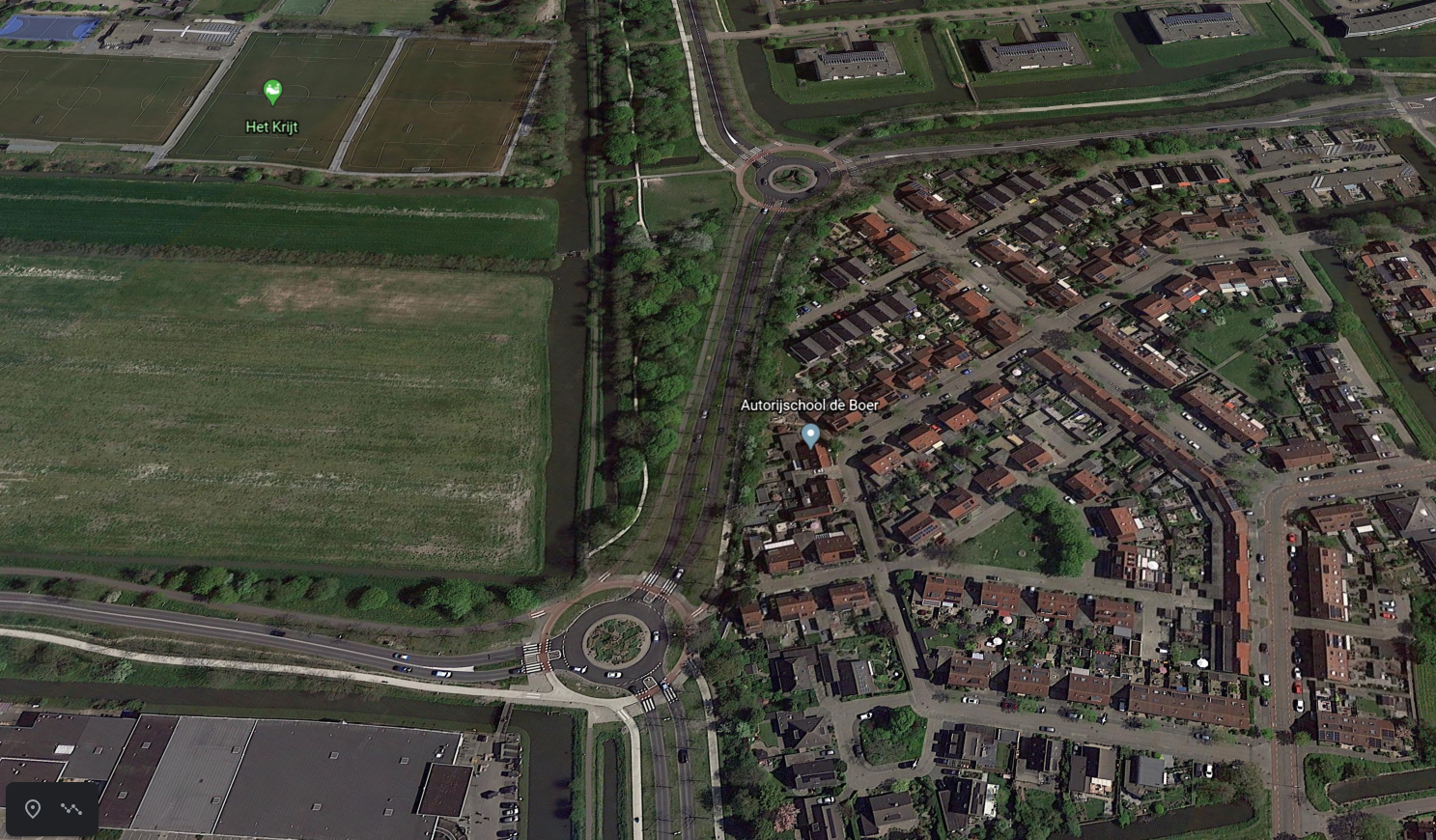

Here's a photo of a couple of Dutch roundabouts:
Same layout, same colours, same markings, same priority. Works a treat. Everyone knows where they stand in terms of right-of-way, everyone knows the rules, where to look when approaching / leaving, it's just well organized.
If we had a consistent design across all our roundabouts we'd be able to train drivers accordingly but it's tough given how many different layouts we have.

On the real Dutch ones the crossing are much further back, so cars are off the roundabout and have room to stop. Also the Dutch roads are nowhere near as busy as ours. Cambridge traffic is almost as bad as London now.
With this design people will backed up on to the roundabout. So a big risk of being rear-ended, probably in to cyclists...
