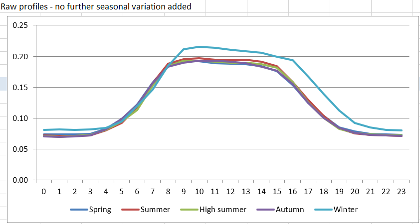

This is the daily demand profile for electricity.
Not knocking that your graphs are wrong but surprised usage is exactly the same in winter between 3.30am and 8am as the rest of the year. I know I dont bother putting any lights on atm when i get up at 5.30am and at work all out floodlights are on sensors and go off before 6am whereas in winter they can be on until 9am on dark days.
Forgive me - it’s not about electrical supply demand - it’s about the capacity to provide enough for the increased demand in terms of new connectivity and the associated loads this puts on the networks -my fault if I wasn’t clear
You were perfectly clear, the point that @chanjy was making is that the vast majority of EV charging can be done in that bit of the curve that’s lower (E.g. not between 6am and 8pm).
I totally get the usage pattern for a rapid charger closely matches the usual energy demand curve but in reality, they represent a small fraction of the energy used by the EV fleet.
The local and national grid is built to cater to peek demand, outside the times of peek demand there is plenty of generation and distribution capacity. For example, wind turbines are often turned off at night because there is too much electricity and not enough demand.
You can’t say the same for electric heat, that will add to peak demand but that isn’t the topic of this thread.
