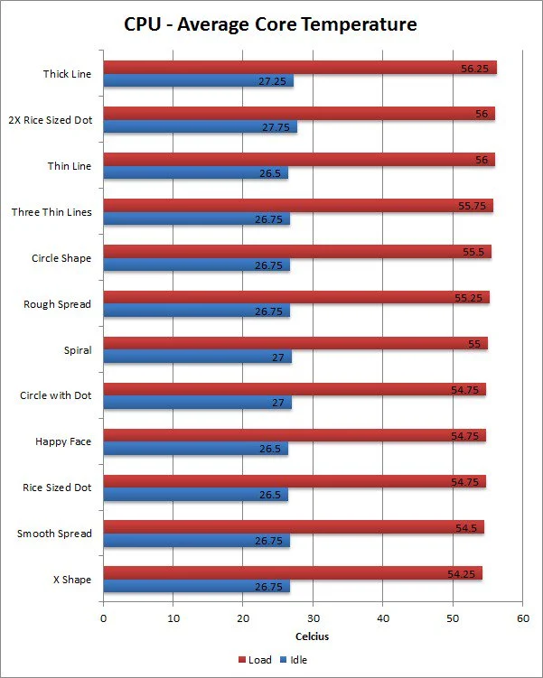

i'm using the Noctua NT-H1.
And my last couple of thermal paste applications i used the X Method
That image is with MX-2 IIRC - other pastes may have different results - MX-2 and MX-4 tend to be fairly tolerant on application method and getting optimal results for that paste which is another reason why MX-4 is often recommended - it is designed to be easy to apply and safe in terms of conductivity, etc.
