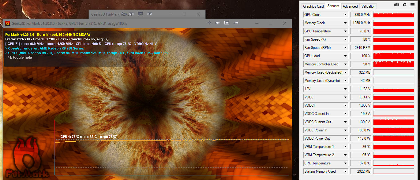

3rd time lucky..... I have use the good old Arctic Silver 5 this time, spreaded it on both the gpu and heatsink, but this time I havent done the screws as tight as possible.. Hey presto the temps are sitting at 78c running furmark. So see now if the temps stay put or if they increase over time again.

Well I give up,, the low temps hasnt lasted a day,, the card is throttling back at 94c running furmark now. So games will be ruuning in the 80's instead of the 60s. I guess I will have to put up with it:mad:
